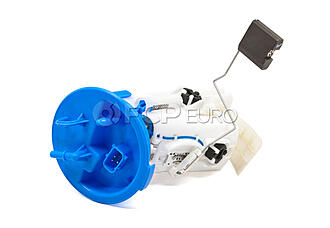

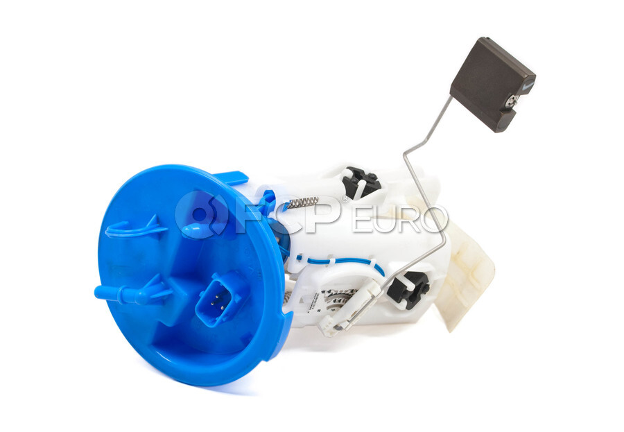

    Sadly this part is only sold with the complete fuel pump assembly.
    Radium sells fuel tubing that's very similar to what comes with the OE pump assembly and is safe for E85: radiumauto.com/Submersible-Fuel-Tubing-P672.aspx
    I bought the "20-0175 Submersible Fuel Tubing, 5/16in x 12.8in" for use with an AEM pump that I installed in the original pump carrier and it's been working fine. Can't comment on whether that size will work with the stock pump though
      #47
      Originally posted by S54B32 View Post
      The strange thing was since I had the car, even after priming for minutes manual, I need at least 2 cranks. So only thing I can imagine is, that there was air trapped in the injectors/fuel rail, where priming not help without triggering the injectors.
      i ordered a walbro kit for e46, it arrived with a similar to oem looking tube, soft sleeve, filter etc. But this tube did also leaked after shrinking, so I replaced it with a standard 8mm black fuel line. It‘s stiffer that the original one and but i know some people used this successfully in the past with aftermarket intank fuel pumps.
      My walbro was sold as GST400. But take you time, mounting without a solid sleeve like the expensive radium one is a little bit tricky so take your time that it sits secure and as low as the original pump.
      It‘s also helpful to have less that 1/4 tank prior this work.
      But before you even think of lifting the pump out of the tank, check you full pressure/leak test!!
