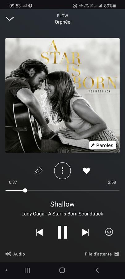

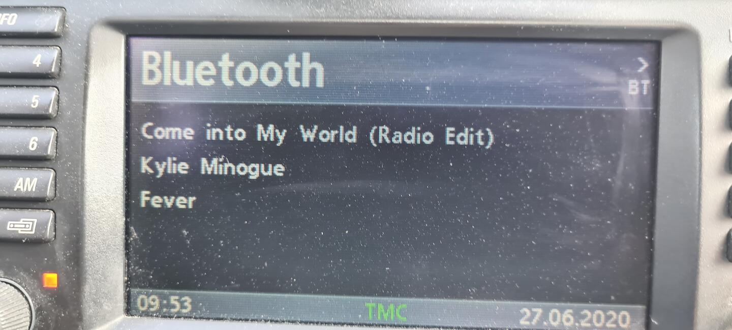

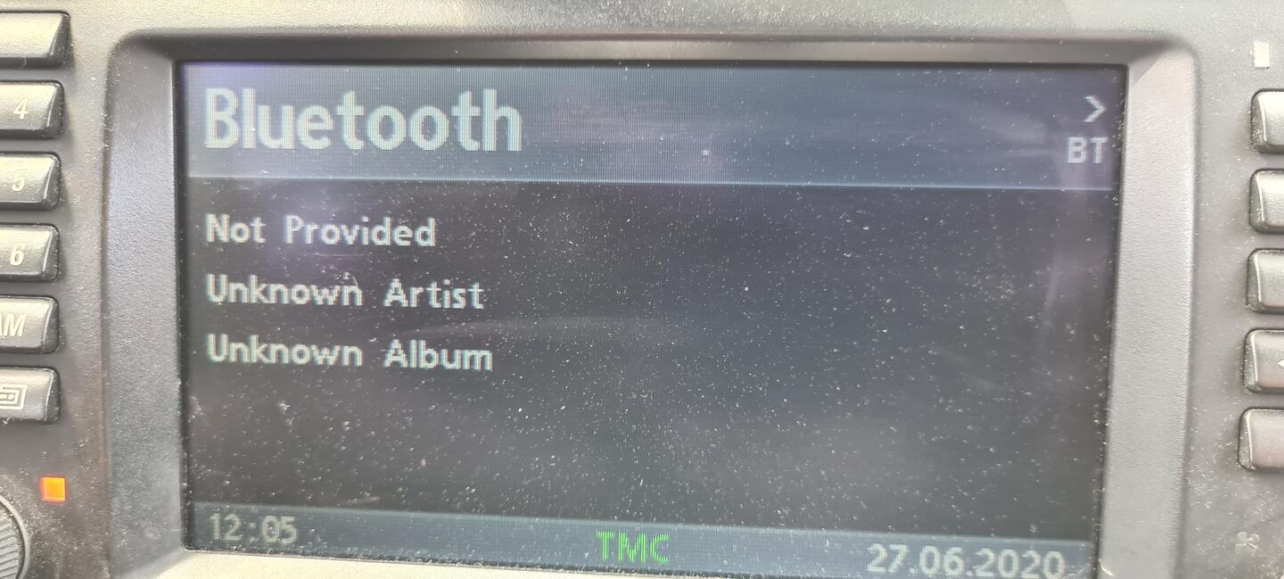

                        Hello
                        On my side with Deezer music app, quite enough ( near half of the time) the title does not refresh on nav screen when music changes. It happens with a Samsung S20 and a Sony Xperia XZ2. It is quite random.
                        Is it because of the app ?

                                Hello
                                It could be! If you don't mind driving around with a laptop in your trunk, you could follow this guide: https://github.com/tedsalmon/BlueBus...athering-a-Log
                                and I would be able to tell you for sure
