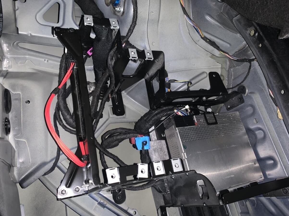

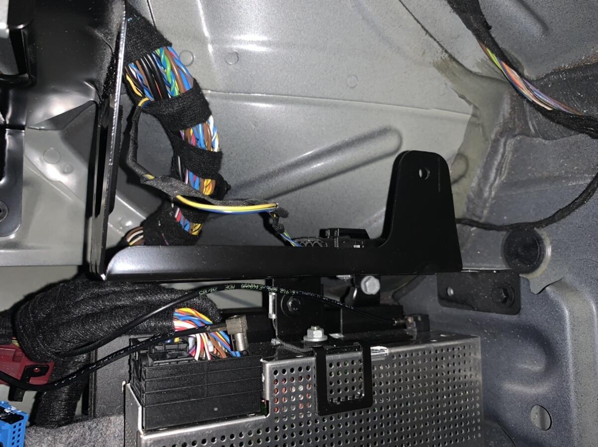

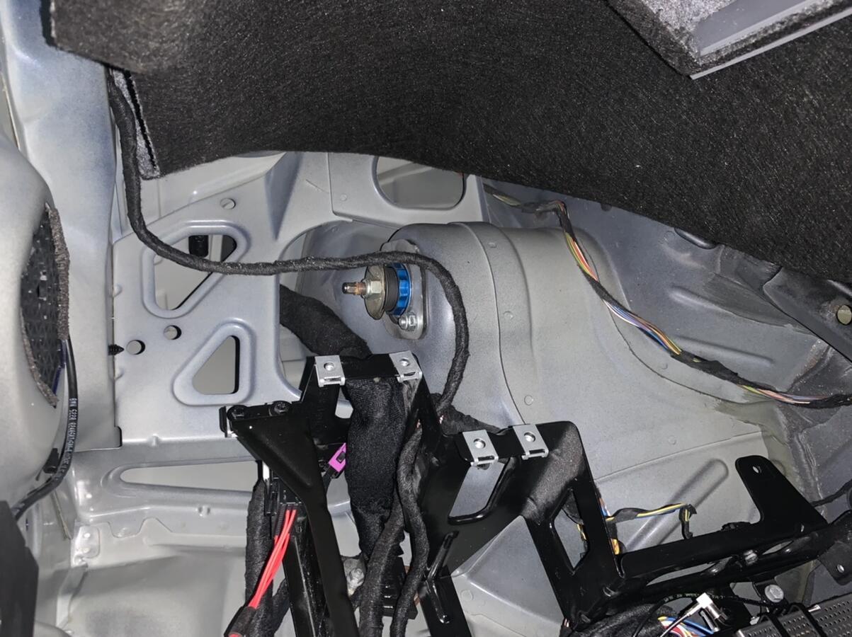

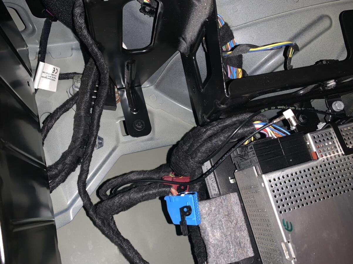

                    Am I the only one who can’t find the 6 and 3 pin plugs? I had this thing installed in my E39 in two minutes but still looking for the plugs in my E46. It’s an 05 with Nav and assist, supposedly wired for CD changer according to the VIN. I removed the TCU and easily found the 54 pin connected to it. Pretty sure I’ve traced every wire back here ...
                    edit: there’s one that goes up to the deck lid but feels like it’s connected to something. Speakers?
                    edit2: couple photos ... the cable in the foam wrapper is just some kind of antenna/RF cable
                          Click image for larger version Name:	F551CDE2-909F-4A66-8947-A56EA66E8ABB.jpeg Views:	0 Size:	152.0 KB ID:	39850 Click image for larger version Name:	D0CEA73E-28A9-426B-BA1C-84C658517633.jpeg Views:	0 Size:	149.4 KB ID:	39847 Click image for larger version Name:	FD8C3F37-8A10-42DB-BB26-0E136C1F3C60.jpeg Views:	0 Size:	151.7 KB ID:	39848 Click image for larger version Name:	F7B4F915-1AD0-4AB7-91C1-4594E075168D.jpeg Views:	0 Size:	153.4 KB ID:	39849 Click image for larger version Name:	F551CDE2-909F-4A66-8947-A56EA66E8ABB.jpeg Views:	0 Size:	152.0 KB ID:	39851
                          Got them!! They were attached to whatever the heck is installed under my rear deck. Guess I’ll rip that out today too after putting this back together.
