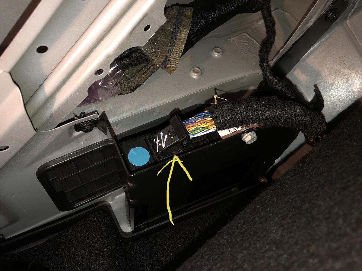

                            Click image for larger version  Name:	image_5126.jpg Views:	4 Size:	128.6 KB ID:	13769
                            My M3 has a production date of 6/02, which (I believe) means that I should have the 54 pin connector. According to my VIN, the car was optioned with "S640A Preparation f telinstallation universal" and "S692A Preparation BMW 6CD changer Ibus".
                            Is the 54 pin connector loose in the trunk, or is it connected to something?
                            The only thing remotely like the 54 pin is a connector that goes into some kind of Harmon Kardon computer (yellow arrow in picture). That connector doesn't match up with the pictures in the wiki, so I think I'm missing something.
                              It's probably tucked up closer to the shock tower. It'll be wrapped up in a foam sleeve.
                              A​​​lso, if your SES connector (blue one that's part of the same harness as the 54-pin connector) does not have a jumper, you'll need to grab the pins from that one.
