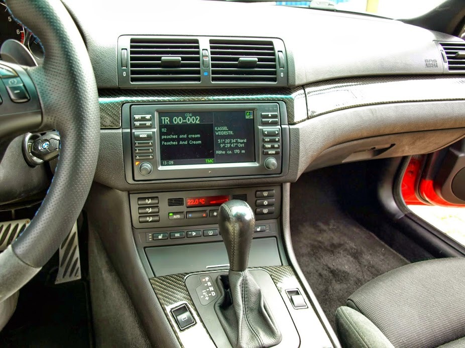

                Anybody has photos (or videos) of the Mk IV nav in split screen mode?
                        My 330i
                        Click image for larger version  Name:	P9130356.JPG Views:	0 Size:	197.7 KB ID:	14181

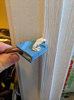

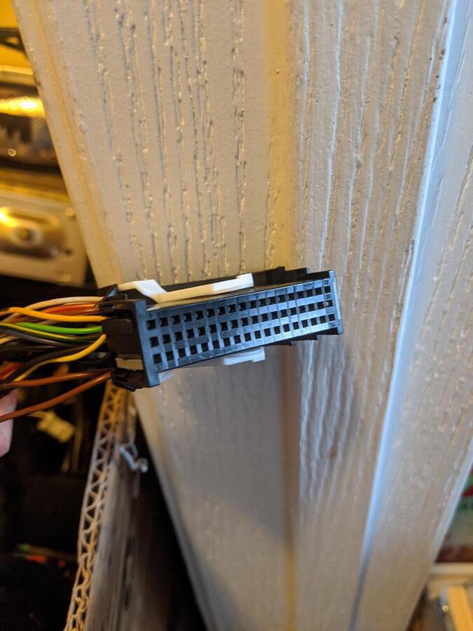

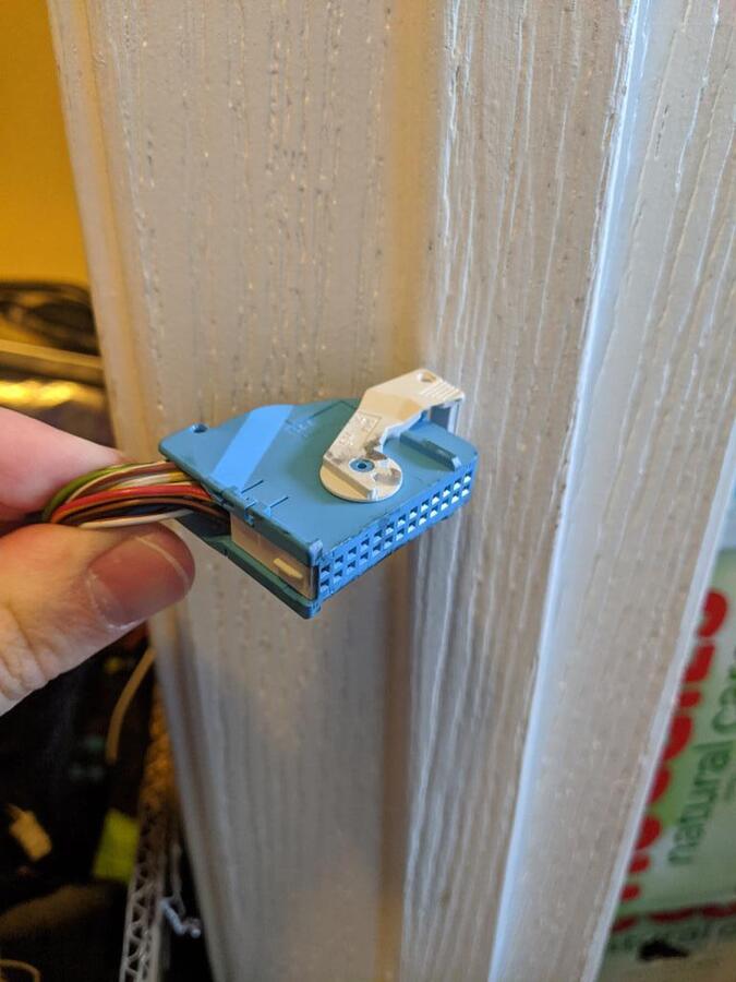

                            My car (production date of 6/02) has both the 54 pin TCU connector, as well as the 26 pin SES connector. Pictures of both are below. Neither connector is connected to anything. The Bluebus checkout page has the following warning: "If you have the SES / Voice Module (Option: S620/S620A) ensure that you remove the module! Failure to do so could result in damage to the BlueBus!"
                            Is it safe to assume that I don't have the SES/Voice Module because the 26 pin SES connector wasn't connected to anything?
                            54 pin TCU connector:
                            26 pin SES connector:
                              Click image for larger version  Name:	IMG_20200227_171542.jpg Views:	0 Size:	71.4 KB ID:	14232
                              Click image for larger version  Name:	IMG_20200227_171513.jpg Views:	0 Size:	58.9 KB ID:	14231
                              As long as the SES connector is not connected to anything you'll be fine. Note that without the SES jumper plug, the wires necessary for telephone integration in the 54 pin connector will not be connected to anything. You will either need to buy the jumper or use the pins from the SES connector.
