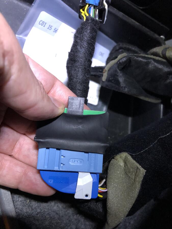

                Just got the TCU adapter installed. I'm going to throw a few pictures on here since my wiring was different than what's on GitHub.
                The first picture is the adapter I got from Ted (left) with the connector in the car (right).
                The picture on GitHub showed a grey/black connector, but mine was blue.
                Next, align the adapter and the connector, noting the two little plastic pieces sticking out towards the bottom of the connector in the first picture. Those two little plastic pieces need to align with the two cutouts on Ted's adapter. Make sure the white swinging locking tab is in the "open" position as shown in this picture.

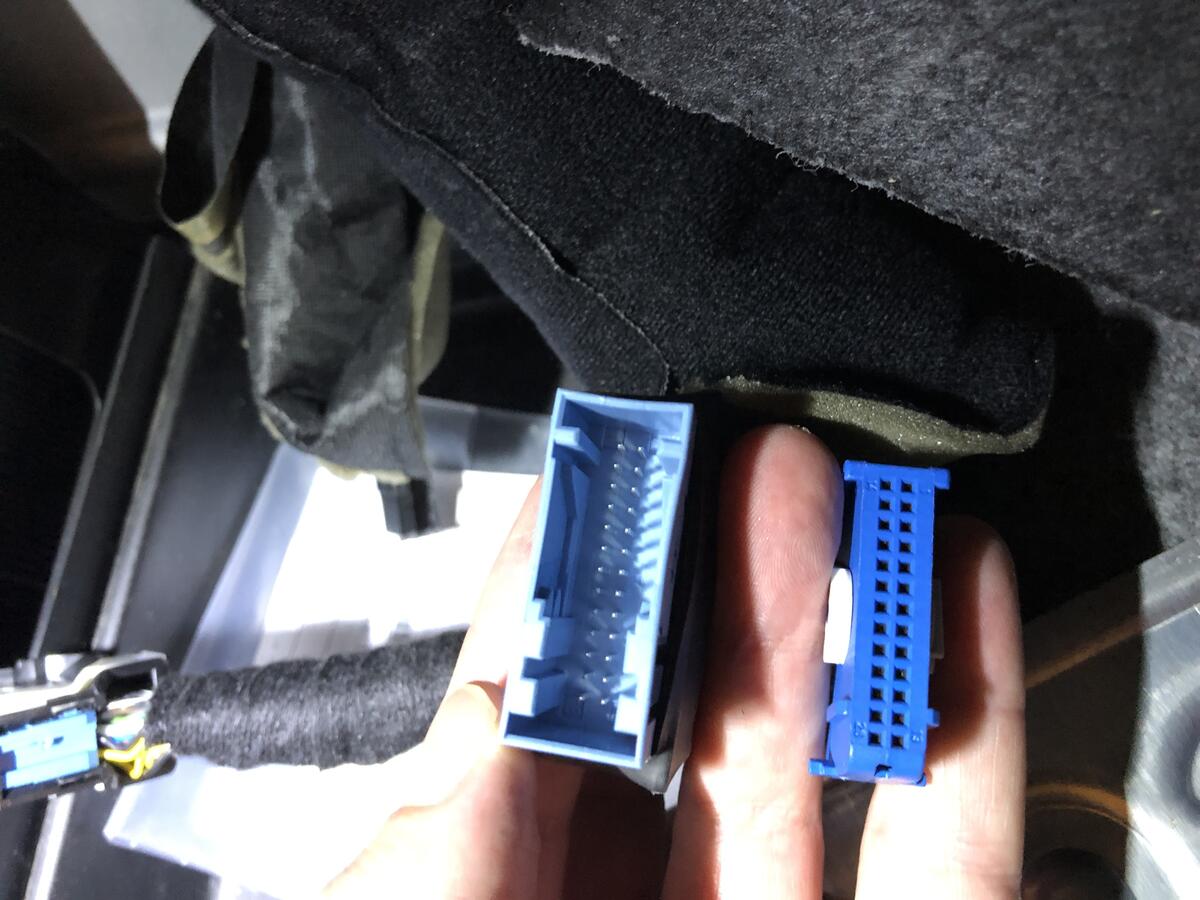

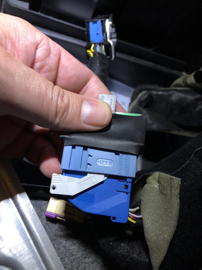

                Finally, once you have the pieces lined up, rotate the white plastic tab to the "lock" position. As you rotate it, it will force the two pieces together. It should look like this when "locked."

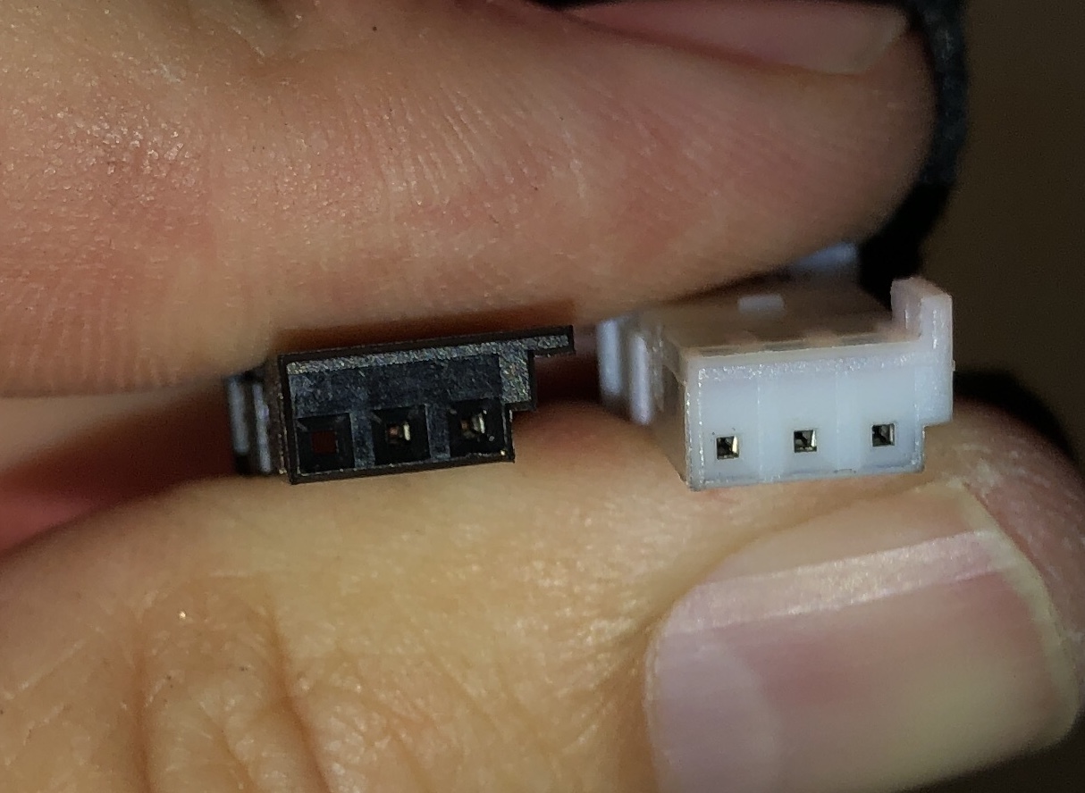

                I wasn't able to test it because the 762 microphone I bought off ebay doesn't match the connector I found in my headliner...
                  Here's my next issue: I bought a 762 microphone off of ebay and it doesn't match up with the connector in the headliner. On the left is the connector that came with my ebay microphone, and on the right is the connector from my headliner.
                  You can see the ebay microphone wants a connector with a tab that sticks out to the side, but my car has a connector with a tab that sticks up.
                  Can anyone confirm that the white connector is the right one from the headliner? If so, what's the issue?
                    That's the homelink connector. Dig around in the headliner a bit more and you'll find the mic connector.
                      You nailed it! I found the mic connector completely wrapped in that sticky black insulation, tucked up on the left side of the opening. Thanks!
