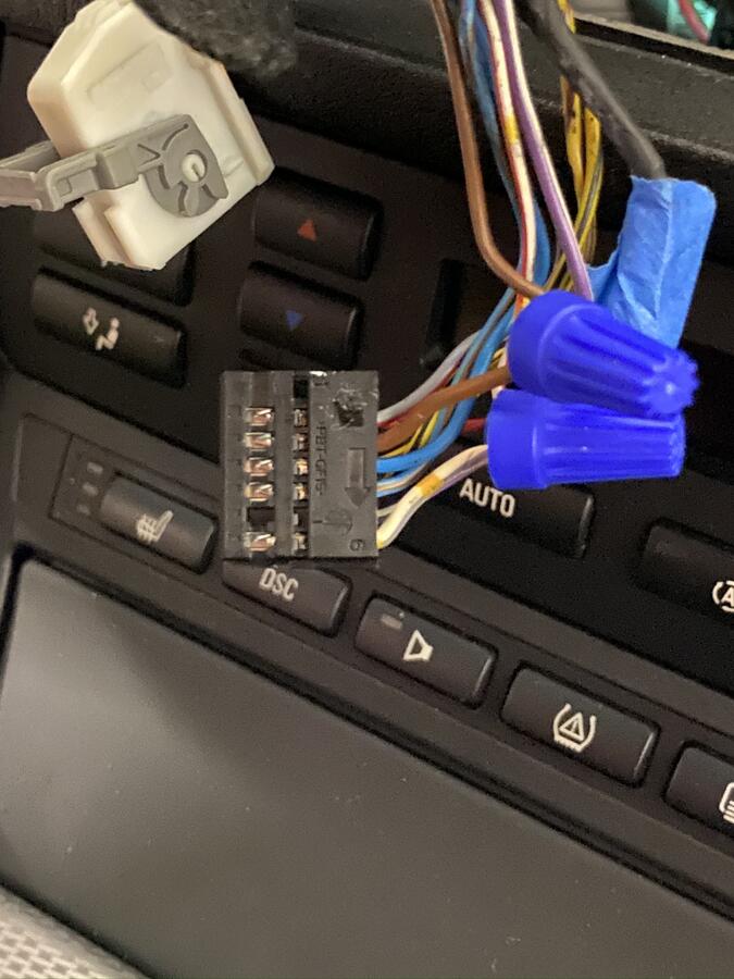

          I hear a slight static-ky sound, I do have that iPod cable using what appears to be BMW's MID box attached behind the headunit, I've cut the wires to it and reattached the wires to the ones connected to the blue connector but still nothing.

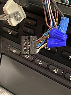

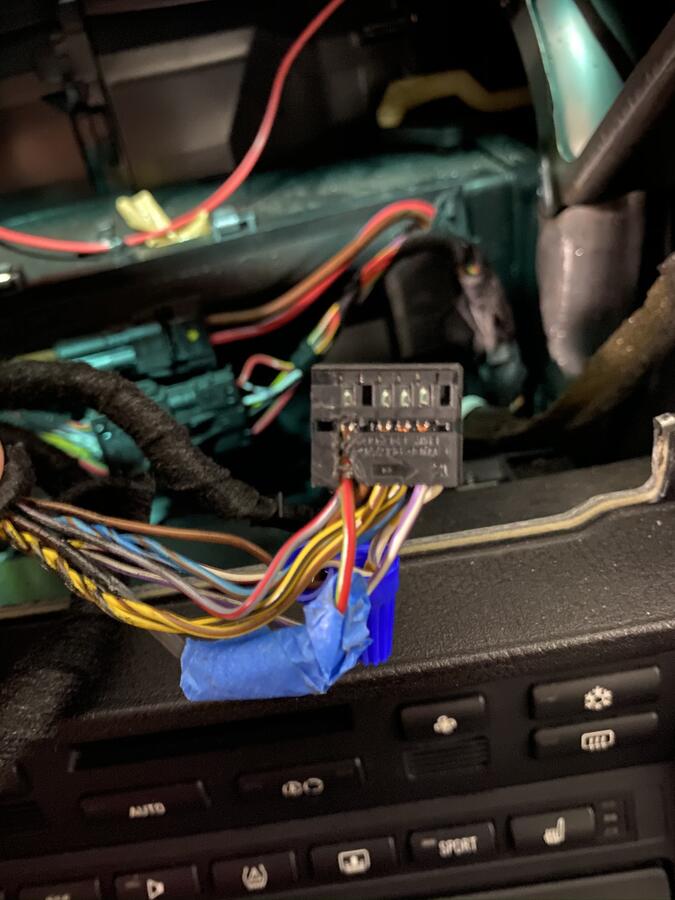

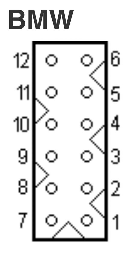

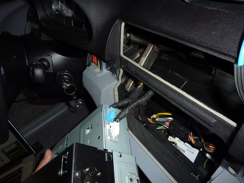

          It appears someone has tampered with the black connector which is in the blue lock clip. Checkout the pictures, would you have any idea of what coloured wire goes into each numbered pin? Maybe I can refurbish my connector?
          Blue Locking Clip connector:

          My connector:

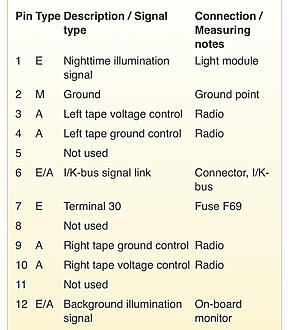

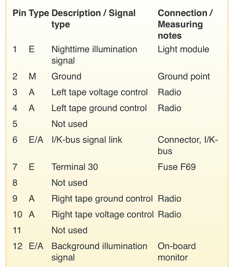

          I've found this info online with some info on what each pin does, except I'm looking for info on what coloured wire goes into which pin!
