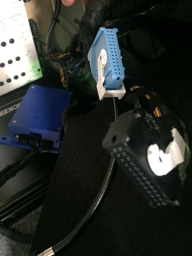

    Ted,
    I have a 02 e46 m3 and I don't believe I have the 54 pin connector for the TCU like in the wiki. I have two connectors a blue one and a black one. The blue one looks identical to the one in the e39 video that they plug your adapter cable into. So, i guess im confused or do you have instructions for how to de-pin this blue one or are these the wrong ones all together. Click image for larger version

      Adam,
      The Blue connector pictured is the SES connector. Here are the pin arrangement from it to the BlueBus:
      Code:
      Pin 1 is the top row, lowest pin (closets to the 6 Pin Audio)
      Pin 4 is the bottom row, lowest pin (closets to the 6 Pin Audio) right under pin 1
      BlueBus 1 - Mute - SES 22
      BlueBus 2 - Mic Neg - SES 8
      BlueBus 3 - Spkr Neg - SES 12
      BlueBus 4 - Tel ON - SES 18
      BlueBus 5 - Mic Pos - SES 9
      BlueBus 6 - Spkr Pos - SES 13
      P.S. does the 6 pin connector going into the BlueBus have 3 or 5 wires in your car?
      Thanks!
      -Ted

        Everyone else who has contacted me with a 'vert has had the SES connector
        If anyone has a link to the pin out for the 26 pin TCU connector (Black), I would be most appreciative.
        My TCU had a 54-pin connector?
          #64
          They all did after 03/2002
          Before that, there was the black 26 pin connector pictured in AdamM3's post

            Ted,
            It has 3 wires
              #66
