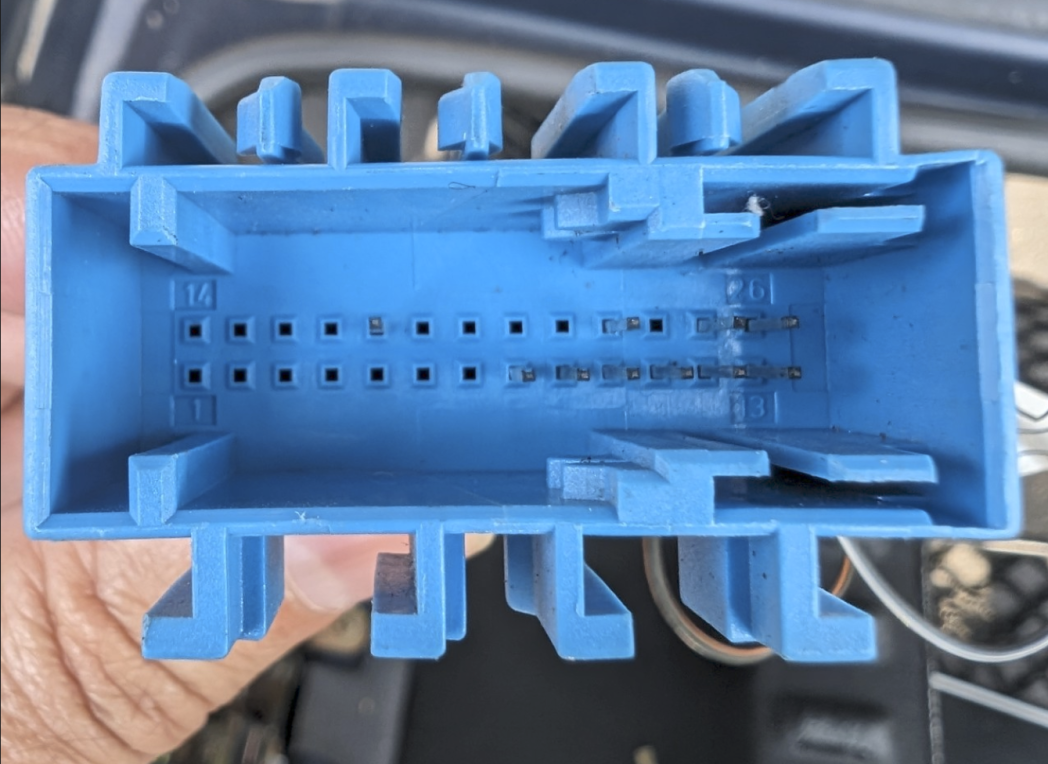

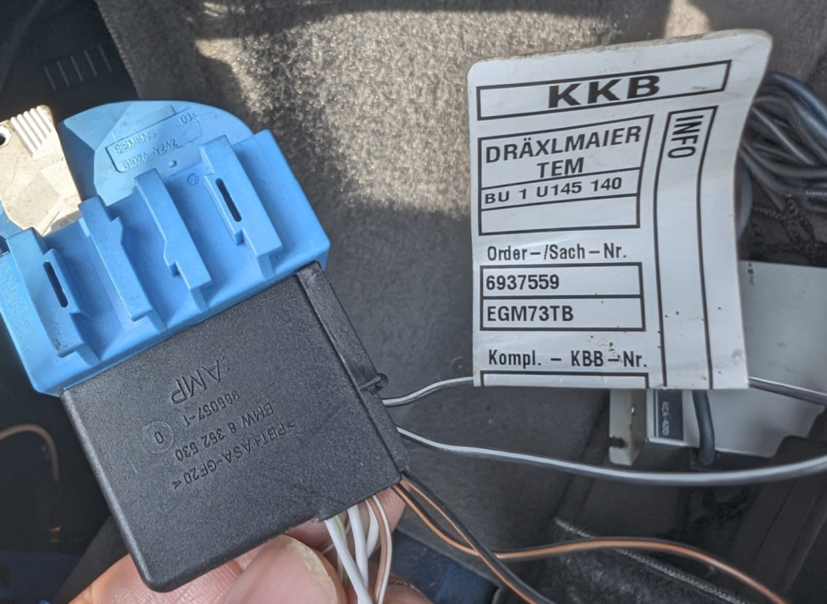

                      @t3ddftw​ I have a question regarding phone adapter.
                      Having the genuine SES jumper connected on SES connector does not make microphone works, does it ?
                      Does the 6 depin connector must be plugged to the bluebus ?
                      I have a SES jumper connected on SES blue 26 connector, but if I don't rewire the pins from it to the 6 depin plugged to bluebus, I can hear my friend (DSP with digital audio cable/mode enabled), but it seems mic is not working, he can't here me...
                      Do I miss something ?
                      Click image for larger version  Name:	image.png Views:	0 Size:	944.3 KB ID:	267042​
                      Click image for larger version  Name:	image.png Views:	0 Size:	935.5 KB ID:	267043​
                      Edit : I found https://www.bimmerfest.com/threads/s...stall.1307993/
                      And my SES jumper is correctly wired...
                      I will look at SES connector
                      Edit 2 : I double check my pins and all match. my SES jumper should be OK.
                      I suppose I must have an adapter cable from SES connector to 6 pin bluebus if I don't wan't to rewire manually, it is not just a matter of SES jumper... right ?

                        Hi again !
                        It seems there is a mistake on the wiki, the TEL ON PIN is written as 19 on wiki for SES connector, shouldn't it be 18 ?
                          Originally posted by Orphee View Post
                          Hi !
                          Thanks for the tip on pin 19!
                          Having the SES jumper should allow the microphone to work. Are you sure you've correctly de-pinned the 54-pin connector?
                          Do you own a multimeter to check for DC voltage at the mic connector?
                          Thanks!
                          -Ted
                            Thanks ! So in any case you have to depin or use an adapter linked to bluebus.
                            I probably damaged something on the car, I inverted some wires on the 6 depin...
                            I reppluged it all correctly but I don't have any call sound anymore...
                            No matter what...
                            I still have music, but even with ses jumper and nothing connected to the 6 depij bluebus, I don't have sound anymore...
                            I used to have at least remote correspondent voice working... But now nothing...
                            With it without the SES jumper and with our without home made SES to 6-depin connector...

                              So, to be clear, you have no inbound or outbound audio? This sounds more like a misconfiguration or license issue than anything…
                              Can you make sure the mic gain is set to -23dB?
                              Thanks!
                              -Ted
                                I have bt audio streaming working fine, I have music.
                                Issue only occurs in call.
                                Mic set to -23 yes.
                                Yesterday, before I played with rewiring, with SES jumper connected to SES connector (without any depin mod) , I had call audio working but no mic...​
                                So like genuine, only 6 pin audio and 3 pin power connected to bluebus.
                                I don't know what I did...
                                Maybe a wrong terminal command while playing with terminal... ?
                                Today even if I plug everything like yesterday (genuine, no depin mod), no more call audio at all...
                                And when I plug the SES adapter I built to 6 pin bluebus, it does not work either ...
                                It used to work month ago before I sent back bluebus for repair with de-pin from SES connector to 6 depin connector...
                                I know I did a wrong wiring yesterday when I built my SES adapter...
                                I built it with pin 1 to 3 up, and 4 to 6 down, reversed form left to right...
                                Pin 1 and 3 was outside 6pins audio instead of near...
                                Did it damage something... Or is it only some miss programmation with terminal...
                                I only recall I sent cvc terminal command you gave me by mail...
                                I of course fixed my wirings and plugged back 1 and 3 to near 6-audio pin.
                                I also remind I had pin 19 from SES to 4 soldered instead of 18 at first...
