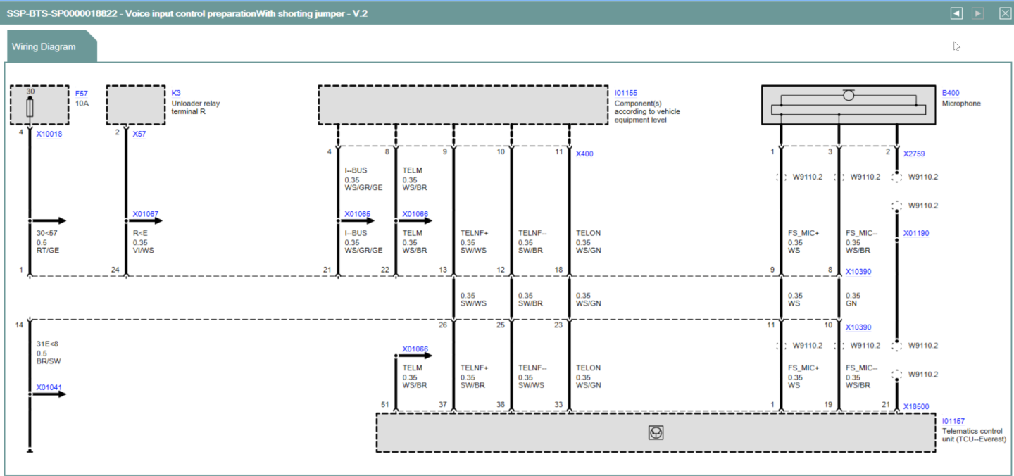

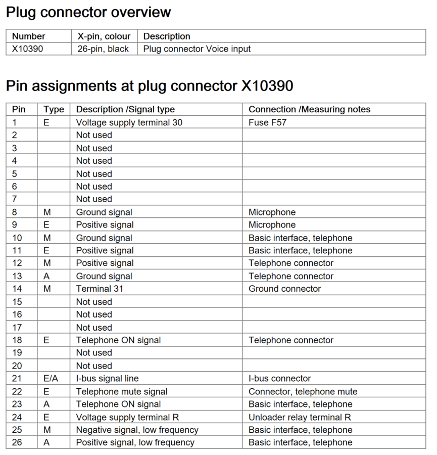

    From ISTA TIS :
    Click image for larger version  Name:	image.png Views:	0 Size:	271.6 KB ID:	267428​
    Click image for larger version  Name:	image.png Views:	0 Size:	165.6 KB ID:	267430​
    Click image for larger version  Name:	image.png Views:	0 Size:	201.8 KB ID:	267429​

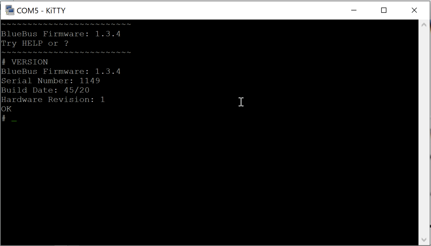

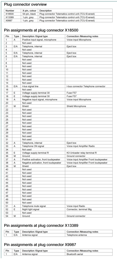

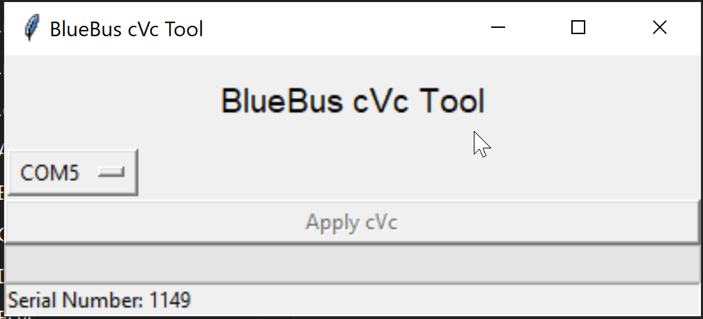

    Edit even on Windows I can't apply cvc :
    Click image for larger version  Name:	image.png Views:	0 Size:	48.1 KB ID:	267432​
    Click image for larger version  Name:	image.png Views:	0 Size:	70.2 KB ID:	267433​

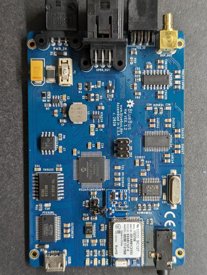

    I must have damaged something on the car...
    I don't know why I don't have call input audio anymore with genuine SES plugin as it used to work in my first tests before playing with wires...
    Edit : It is not car but the bluebus...
    I replugged genuine ULF bluetooth module with its SES jumper.
    Call BT Audio and mic works with BMW ULF module.
    So I probably damaged the bluebus with inverted pins on my first SES adapter build try...

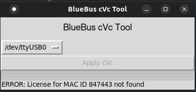

    Edit 2 : Neither my Windows laptop or my Ubuntu desktop are able to apply cvc with GUI tool, and neither of them can connect to flash firmware, it seems to reboot to bootloader and green led blinks... but not responding then...
    Only screen / putty works for terminal log access.

        OK I may I found why CVC GUI tool does not work.
        Looking at python code :
        It search for 20FABB0
        Whereas mine is actually 20FABB1
        So I replaced the condition with my value...
        Now I don't have error it terminal log anymore when I select serial port.
        But my MAC ID is not valid for CVC :
        The license you gave me was this one :
        It may not be valid for my MAC ID actually ?
        and while trying to manually set it from command line, I broke the genuine one there was in the bluebus...
          This is a CVC license issue, I disabled CVC with "bt cvc off" and then I had sound, mic works (very bad but it works)
          I tried all licences from github, none works.

            To close the loop here, I provided the correct license via email
              Many thanks !
