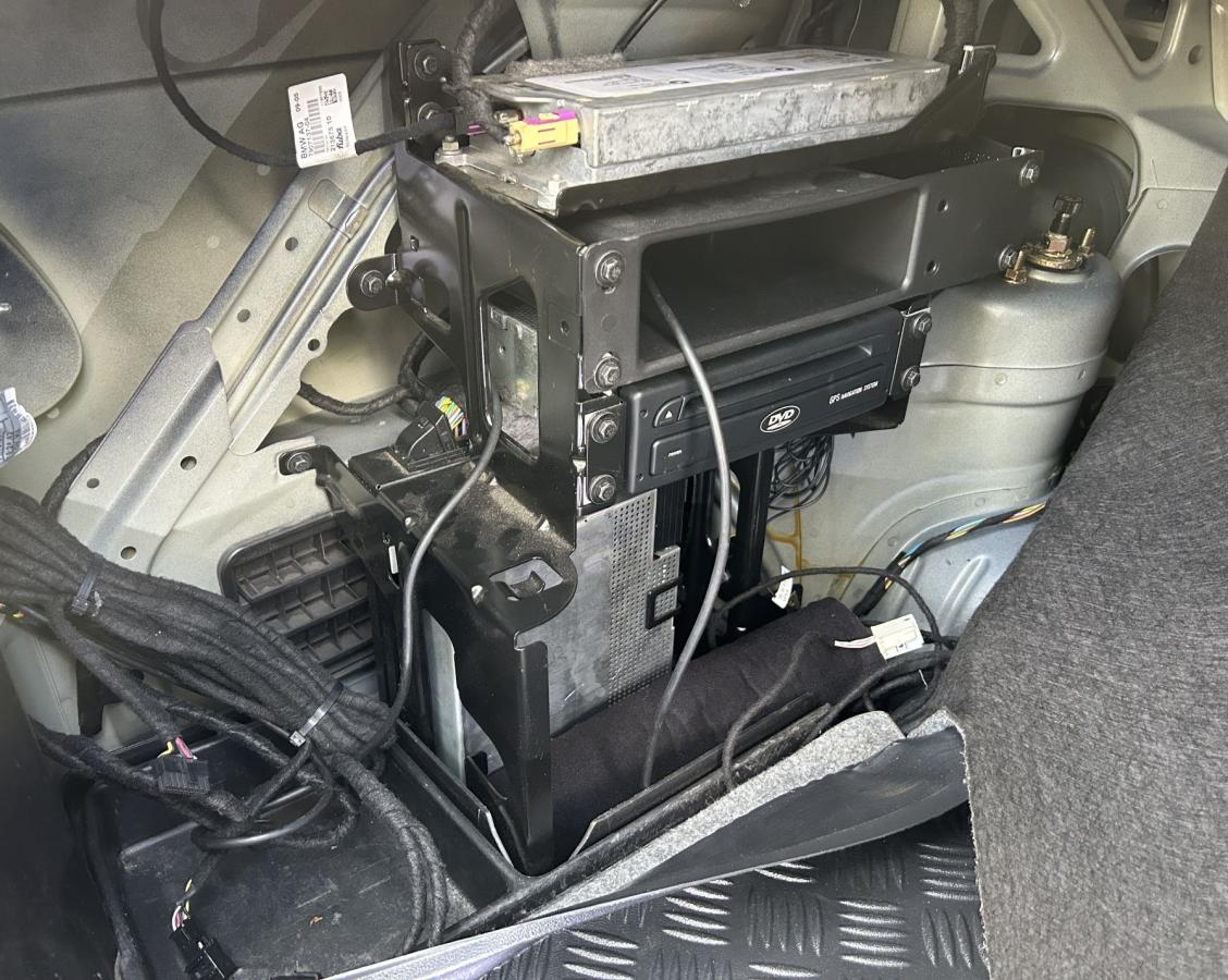

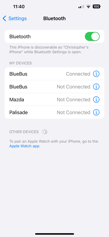

            Install Issue - bought for my 06 M3. Unbeknownst to me a PO had installed the factory Bluetooth module. It's this one: https://www.ebay.com/itm/285779755630
            This is way more complicated than my E39 M5 install. I've removed the factory piece and hook up, but no Bluetooth connection. I'm working with Ted who had been responsive. Checking to see if anyone here has gone from factory to Bluetooth and if I'm missing a step. TIA for any thoughts.
            UPDATE - got it to connect the following morning. Phone now shows connected AND not connected, weird but working.
              If I remember correctly, you take the connector out of the CD changer and plug it into the BlueBus. It looks like the PO took the changer out, but the cable should still be there.

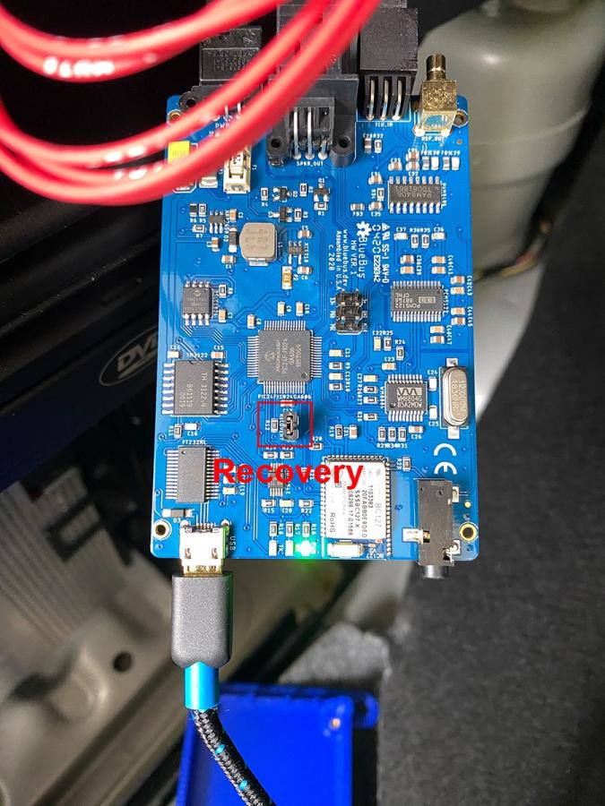

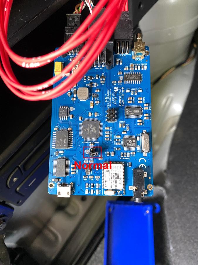

                      Older firmware versions have trouble going to bootloader mode. Remove the unit from the case, then locate the "RECOVERY" jumper and connect it to both pins. Try it again, then restore the jumper to how it was prior to messing with it.
                          Thank you Ted, I'm not very electrically inclined, but that was very straight forward. All updated.
                          For anyone having the same issue, here's what the jumper looks like:
