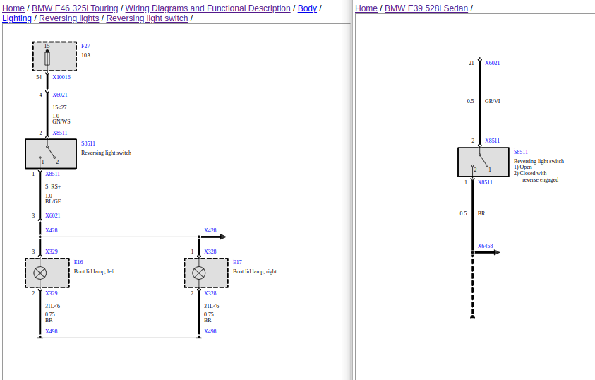

              I was going to give you the ole "lol idk" BUT I went and looked in WDS and found this:
              As you can see the, the reverse gear switch is tied directly to the reverse lights on the E46, while in the E39 that signal is sent to the Instrument Cluster.
              The IKE is then able to communicate the status of reverse gear since it has this input, while the circuit on the E46 is purely analog.

                Thanks for that! Mystery solved. I now know one additional useless fun fact about our cars 😂

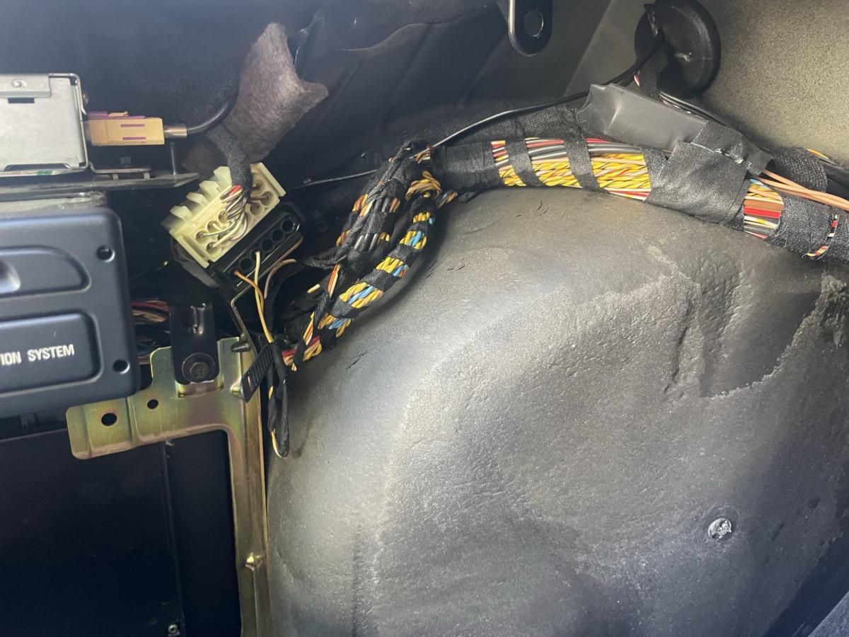

                  I feel dumb- which adapter do I need for my 03 M5. Can't find the blue one anywhere but can't find the black one either (unless thats it, connected below)
                  Click image for larger version  Name:	IMG_2136.jpg Views:	0 Size:	103.2 KB ID:	189190
                    You have the ULF over the Navi, so the 54-pin adapter
                    -Ted
                      Click image for larger version  Name:	Screenshot_20221017_111105.png Views:	51 Size:	43.4 KB ID:	188959
                      Hey,
                      I also have one BlueBus I think its the No244, but I‘m new here.
                      About the e46 and the reverse gear switch, there is the connector x428 in your screenshot which is wierd to the e46 instrument cluster, as shown in my Screenshot.
                      But when i activate the volume down in reverse function in my e46 convertible and i switch in the reverse gear, the volume is going crazy. It gains down to 50% and an half second later up to 100% and then down to 50% again (i See this on my iPhone).

                        Good catch, I totally missed that! Does your E46 have a manual trans?
                        As for your bug, I bet that "Volume Management" and this feature are fighting with each other. I'll have to look into it.

                          Thanks. Yes my e46 has an Manual Trans with PDC.
                          It make sence about the fight with the „Volume Managment“, but i think i can Turn off the Volume Managment in the settings but the fight still goes on.
                            PDC is likely why this feature works. I just got my M3 back up and running, so I'll have to fiddle around with reverse gear, but last I recall, manual E46s did not update the gear status at any point.
                            There must be a bug in one of those two features that is causing it to fight itself .
                            -Ted
