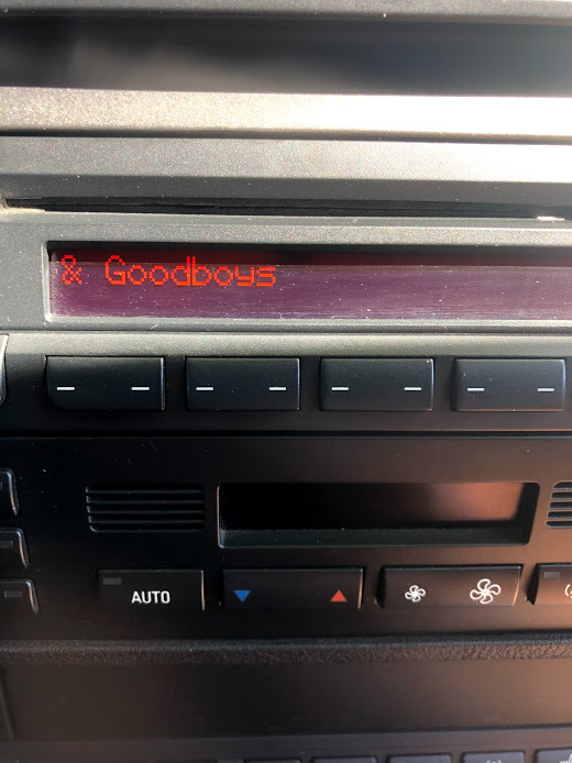

                Hello Ted, I noticed that only a small part of the display is used for the text. Can that be set anywhere
                    You have a CD54, which is extremely hard to source. If you wish to be a guinea pig, we can try extending the character count past 11

                      I do it with pleasure. Tell me what i can do
                        I'll shoot you an email with an experimental firmware. It'll probably be Monday as I am working hard on fulfilling orders this weekend.
