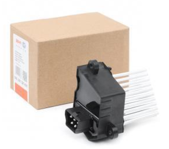

                              is your final stage unit 64116923204 okay?
