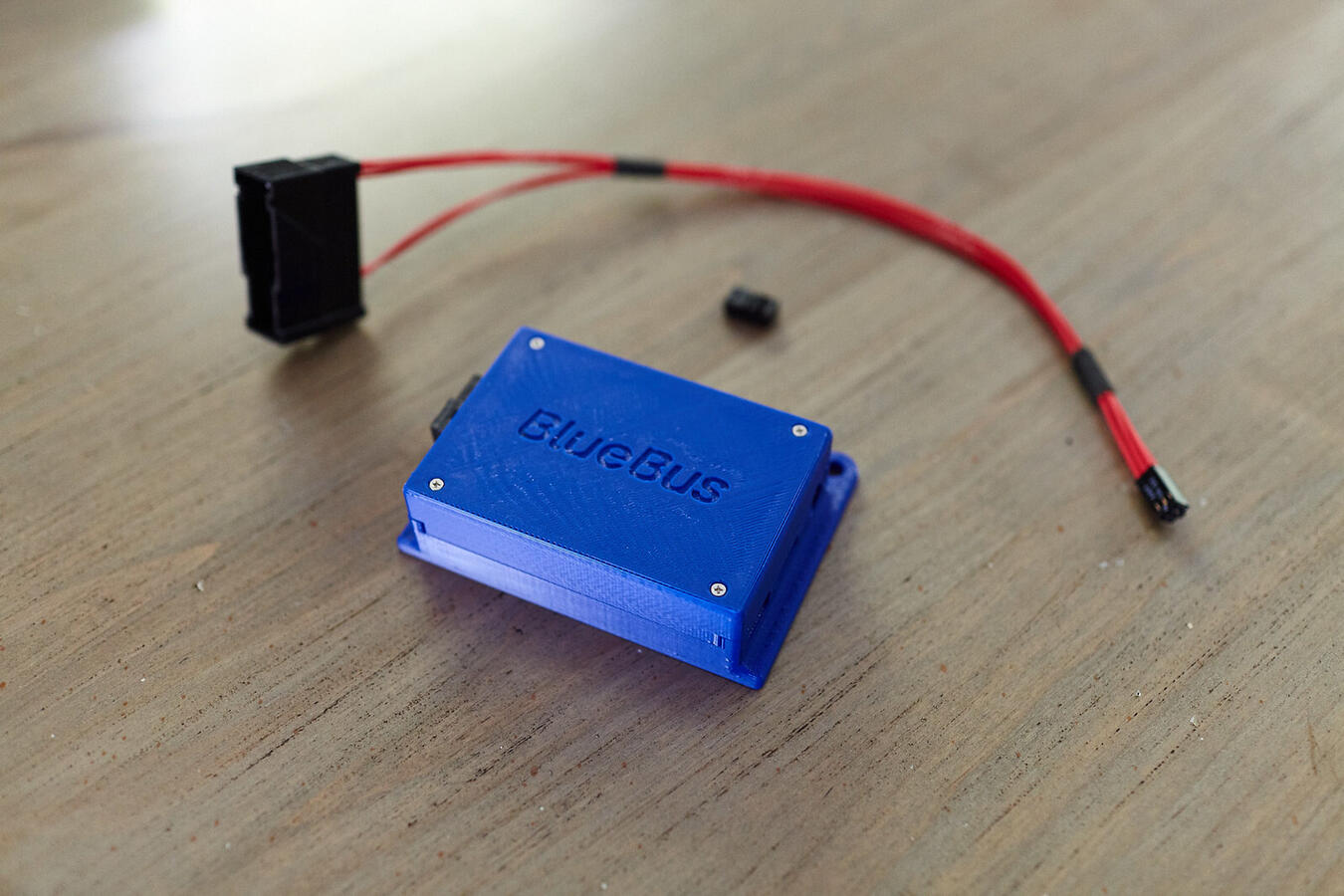

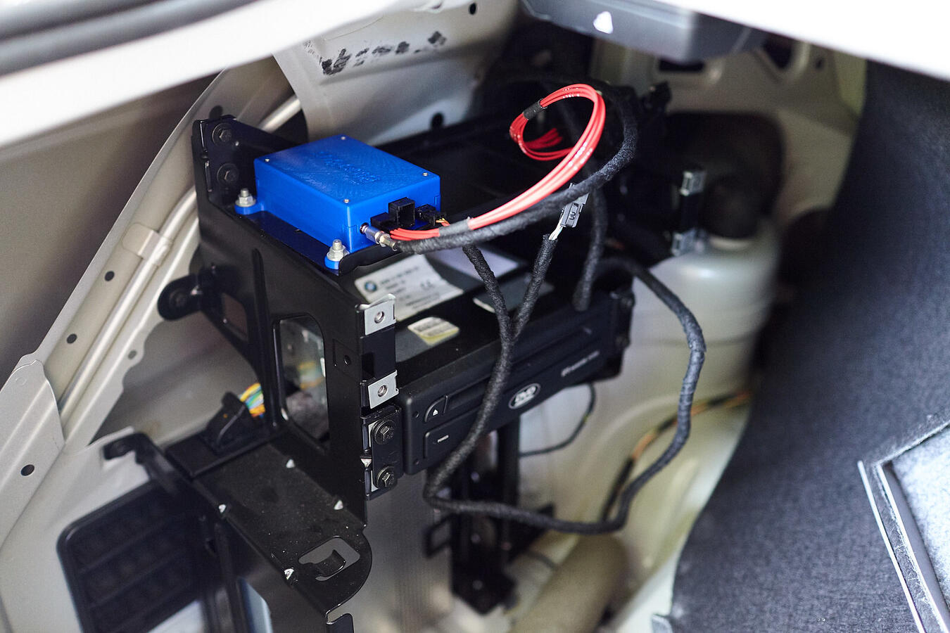

                Got mine installed today. Huge thanks to Ted, this product is awesome. The sound quality is absolutely amazing.'

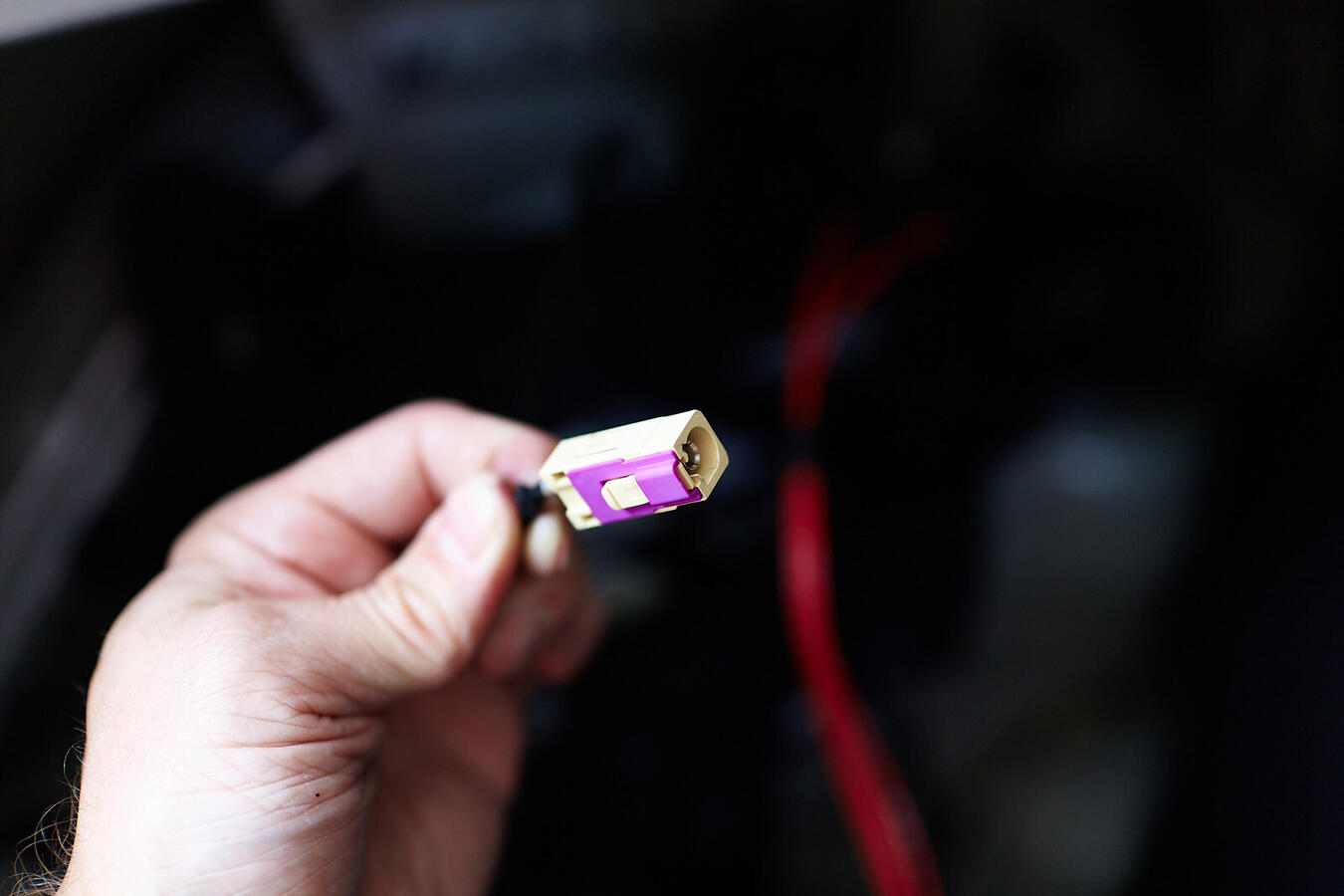

                *Edit: For anyone who read this post earlier. Ted reached out and let me know that the cream/purple connector does not connect to the BlueBus. I removed the photos to not confuse anyone.
                Click image for larger version  Name:	49927441591_27116a3e4a_h.jpg Views:	0 Size:	127.0 KB ID:	27659

                      That's a gorgeous image of the BlueBus, thank you .
                      The connector you found was the BT antenna connector. For the record, no E46 will EVER make use of the digital DSP interface because no E46 was ever offered with the DSP Amplifier. It worked with the DSP set to digital because there was no DSP around to listen to those commands .

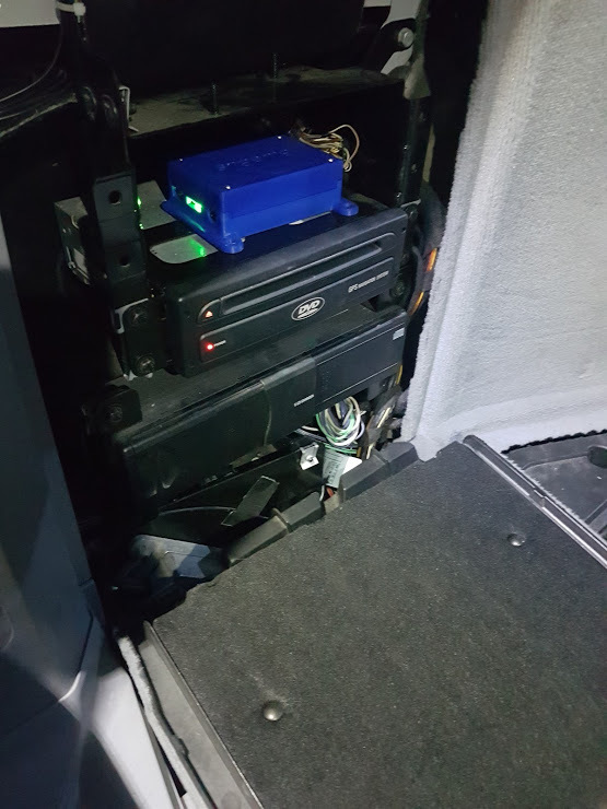

                              I received and installed mine about 2 weeks ago - everything is working perfectly! I have an E53 X5 with MKIV and analog DSP and my phone is a Samsung Galaxy S7 (which I know isn't supposed to work) but I've had no connectivity issues at all - the placement of the unit in the E53 might be better.
                              I was originally going to install the Bluebus in the same location/bracket as the factory TCU (mounted on the side of the amp underneath the CD changer), but thought it would be better closer to the top of the stack, so temporarily routed the cables and installed it on top of the Nav computer. There are no mounts there so will probably just use velcro or mounting tape.
                              The only issue I found so far was audio distortion with the phone volume over ~75%, but no big deal. I also found that the sound at the default setting of -10dB was too quiet compared to the radio so had to increase that setting.
                              Related question: My DSP is analog, but the amp appears to have a coax connection (so does the CD changer, but there was no cable.) Will the digital interface work if I install a coax cable between the amp and Bluebus and enable digital DSP in the settings?
                              E53 Bluebus Install​​​

                                Hello!
                                So, the reason you're getting distortion above 75% phone volume is because you increased the volume of the BlueBus. A "perfect" volume for the BlueBus when combined with a DSP Amplifier is -14dB and 100% phone volume.
                                Please note that the "volume" setting is only applicable to the analog audio output as it is setting the DAC volume over I2C
                                To your question, Yes! You can buy the coaxial cable and set the DSP setting to Digital and ditch the analog connector altogether! I actually recommend this anyways. I recommend this cable: https://www.digikey.com/product-deta...1636-ND/457012
