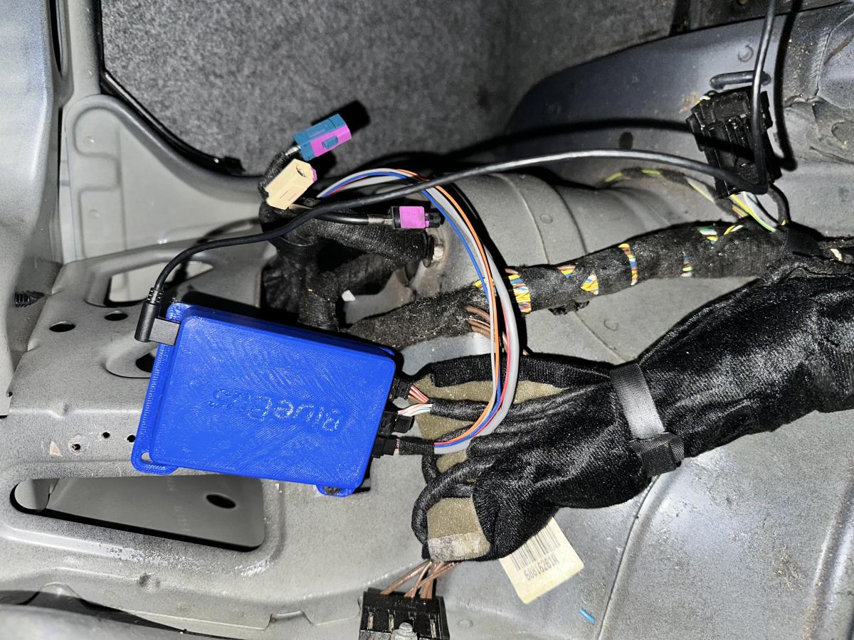

    This thing is awesome! I love how it seamlessly connects and just works. After figuring out which plugs to use, the install went pretty smooth.
    I concur. It's the best modification I've done by far. Thanks again, Ted!
      This thing is awesome! I love how it seamlessly connects and just works. After figuring out which plugs to use, the install went pretty smooth. I mounted it where the old bluetooth module was, and zip-tied everything down so it wont rattle around.

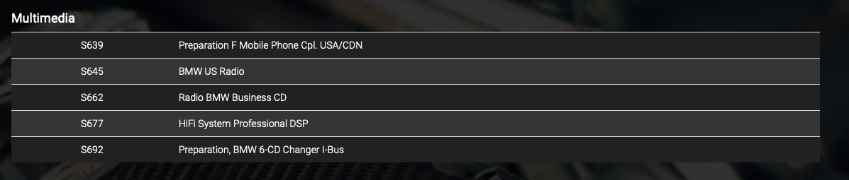

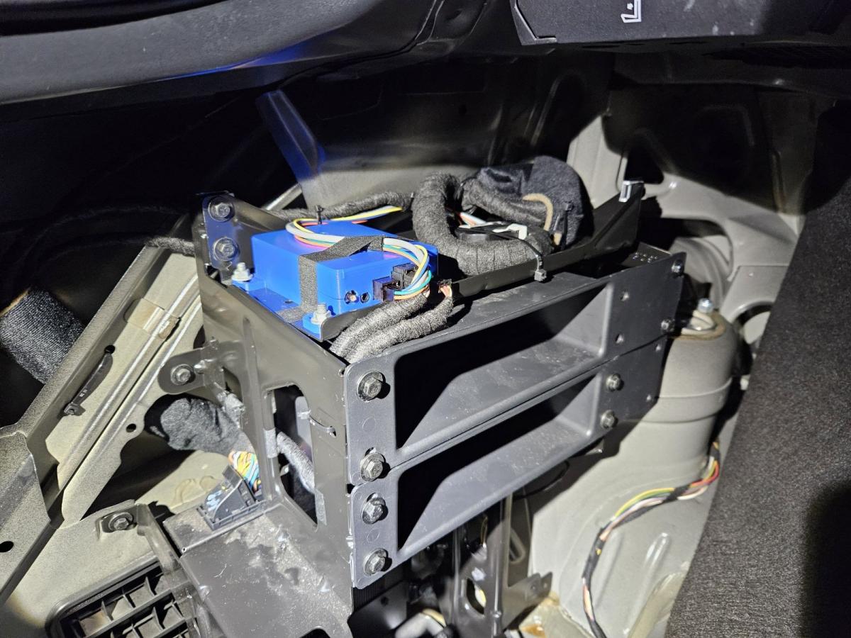

            I sent an email to Ted as well as the above post. He answered almost immediately with the following including the pictures:
            Lets see if I can knock out your questions --
            1. Yes, Carver "HiFi Professional" system.
            2. Analog. They dropped digital in 2005.
            3. No, but it's not worth it on the E85/E86. I retrofit this input ONCE and it was a waste of time. If you had an E38/E39/E53 then I would encourage you to use the digital input as the difference is substantial. I believe they used a higher quality ADC on the LEAR-made E8x DSP amplifiers, which nullified the issue of audio performance via analog.
            4. Yep, remove the TCU.
            5. They will be found on the rear bulkhead. If you're looking at the bulkhead on the trunk side, you'll see a cutout near the trunk floor. The connectors for the CD Changer are usually tucked in there. The TCU is on the left side of the bulkhead. See the attached PDFs as well.
            6. Yes
            7. Hardware Version 2 and software version 1.3.4
            8. Honestly, I don't think you missed anything. The E85 is unfortunately of the harder vehicles to install the BlueBus in, but it's still not too bad, especially when you're armed with the knowledge that the connectors you want are probably hiding from you, as I noted in answer Groups
            Thanks!
            -Ted​​

              Installed! Make sure when you plug in the connectors that you push them all the way in!
              Works great! Now I just need to figure out the menu system. Success turning on the OT blinkers but not the locks...
