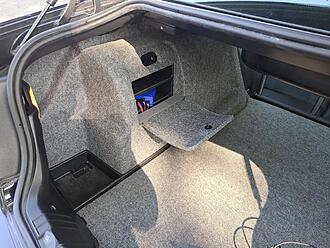

                  from an install perspective, i could not figure out how to mount it in my trunk. i ended up with the below setup. i actually don't mind it as it gives me easy access to it. i think i've only see one person share their install approach, but if others could that would be great.
                  t3ddftw i noticed when i did the upgrade, the software kept on freezing on my laptop. the update itself took about 30-40 minutes. fwiw, it's 2020 Dell XPS and i was using a USB-C to USB-A adapter and then a standard USB-A to micro-usb cable. it's almost as if the reading back and forth was tremendously slow. was i supposed to change any communication settings. i'll see what github says. maybe i missed something.
                  Click image for larger version  Name:	20200921_102111.jpg Views:	0 Size:	161.7 KB ID:	57879 Click image for larger version  Name:	20200921_102109.jpg Views:	0 Size:	238.0 KB ID:	57880
                    Depending on how high your car volume is, alternator whine may be inevitable. I recommend making sure your HFP volume is at maximum .
                    On your update taking forever, was the progress bar moving super slow? The whole thing should maybe take 1.5 minutes. I wonder if the USB cable wasn't fully seated into the BlueBus?

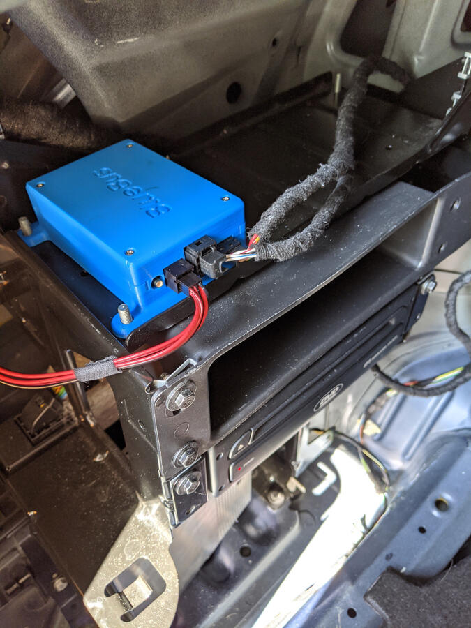

                    Here's how I have it installed, but I haven't had my trunk together in years now...

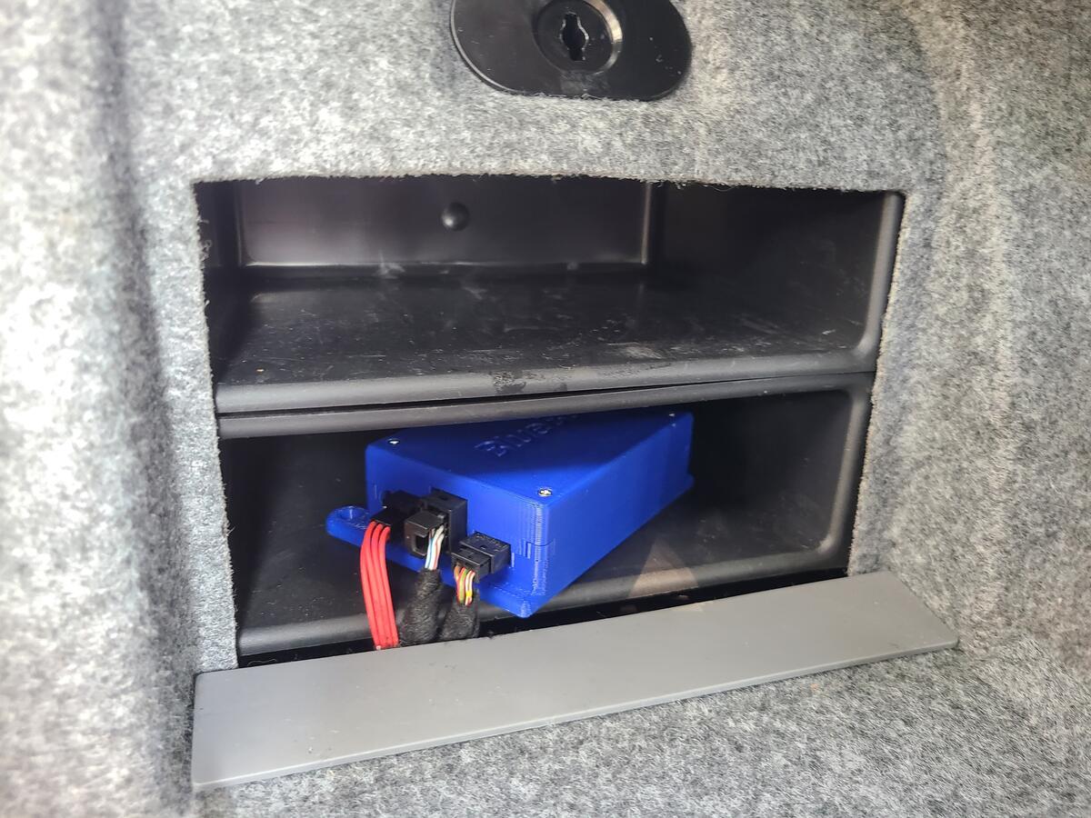

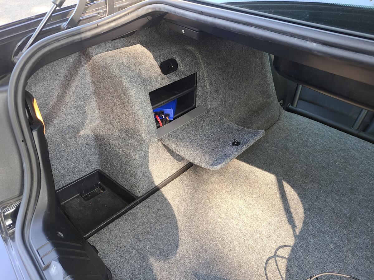

                          Here's where mine is now.
                          I wanted to show (and showcase) the name/logo and will probably fabricate a bezel around it when I'm done.
                          I'm still using the OE phone bluetooth (just wanted to get it installed asap as I owe somebody instructions 😉 and wanted to finally give it a try) and will connect the phone hopefully this weekend. . I'll also need to upgrade the firmware.
