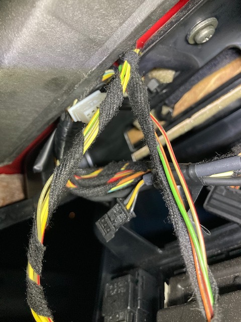

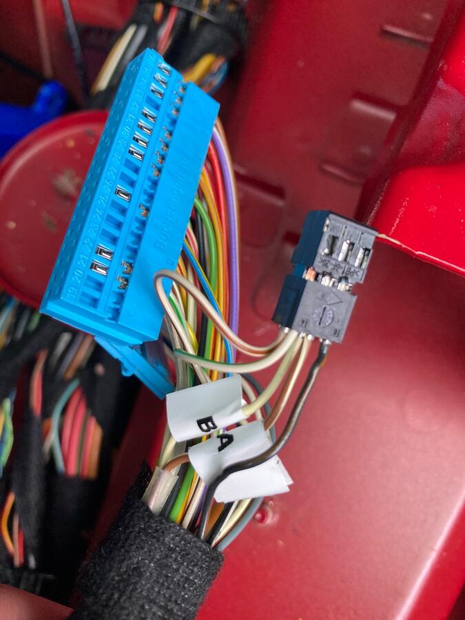

        Hey all, looking for some help diagnosing no microphone functionality. This is an '03 E53 with a 54 pin connector (vehicle did not have TCU module from factory, harness simply tucked away). The vehicle is completely stock and was never tampered with (until me). The easiest thing for me is to assume is its a wiring issue.
        When making a call:
        - The radio is properly interrupted with the telephone function, and shows up on the factory nav screen
        - I can hear the other end of the call perfectly.
        - They just cannot hear me
        This suggests all wiring is OK except for the microphone. In the photo, I've labeled what I think are the microphone wires A & B. I've also swapped A & B in the connector and no change. I'm assuming that I originally pulled the microphone pins per Ted's instructions - #19 and #1 - but consider there's always a chance for user error.
        - Is there any way to test the microphone with ohm meter, if there's a known value, to verify I actually have the microphone leads and that there is a physical microphone present?
        - Can anyone tell by the photo if I have the microphone? Note that A & B are part of a wiring grouping that includes another lead with clear insulating jacket, which goes into pin #21.

        Silly question but... have you checked that you've got a microphone in your car?
        Since it didn't come with a TCU from the factory, chances that no microphone came with the car are high. Have you put one in there?
          Not silly question, but silly that I haven't checked. I supposed I assumed that since I had wires in the indicated pins, that meant there was a microphone. No I haven't added anything and will let this group know the outcome.

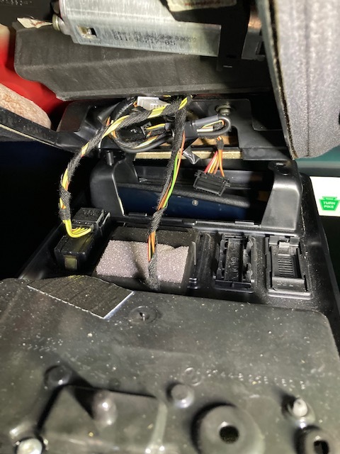

                  Aha! No microphone. Welp, there we go, good thinking Der_Spanier and Ted. This vehicle has S640 - Preparation F Tel.Installation Universal, so looks like that means you get the wiring but not the hardware. I'm assuming the 3 pin connector I've zoomed in on is the microphone connection. And I see similar discussion here: https://xoutpost.com/bmw-sav-forums/...firmation.html
                  Click image for larger version  Name:	IMG_5498.jpg Views:	0 Size:	99.2 KB ID:	72029 Click image for larger version  Name:	IMG_5500.jpg Views:	0 Size:	105.1 KB ID:	72030
                        That loose 3 pin connector does look like the one for the microphone. Now you just need to plug and play/call. Glad you got it sorted.
