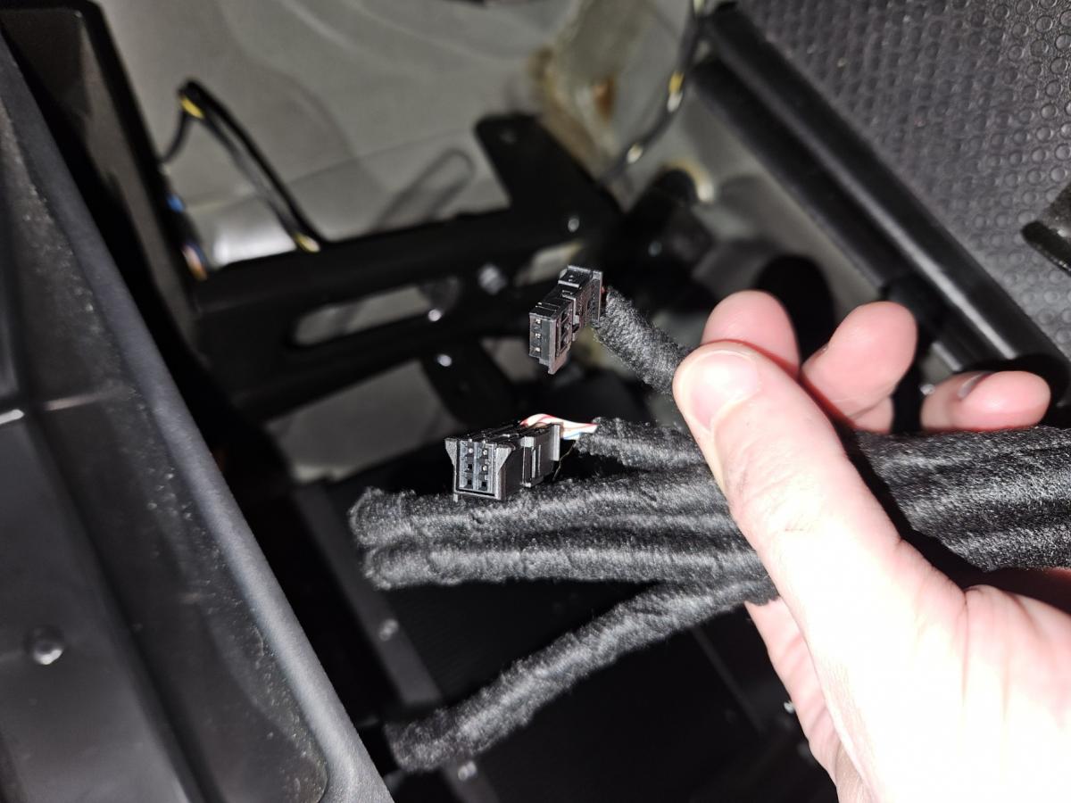

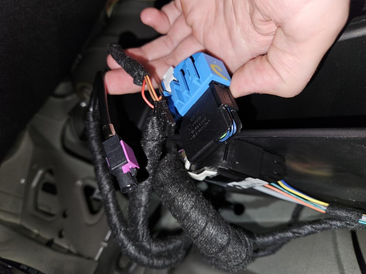

    Hi everyone, I'm looking into buying a 325ti Compact E46 (no clue whether it was ever sold in North America...).
    It's got an original CD53 radio and that's it: no prewiring for the CD changer or the phone. I already went through the trouble of taking my interior apart in my E46 Touring to retrofit the Bluebus. Are you guys aware of an easier wiring solution? Maybe someone sells shorter wiring harnesses to install the Bluebus behind the glovebox?
    Any help would be appreciated! I really don't want to rip the interior apart... but I still want to be able to enjoy my Bluebus 😁
    Thanks!
