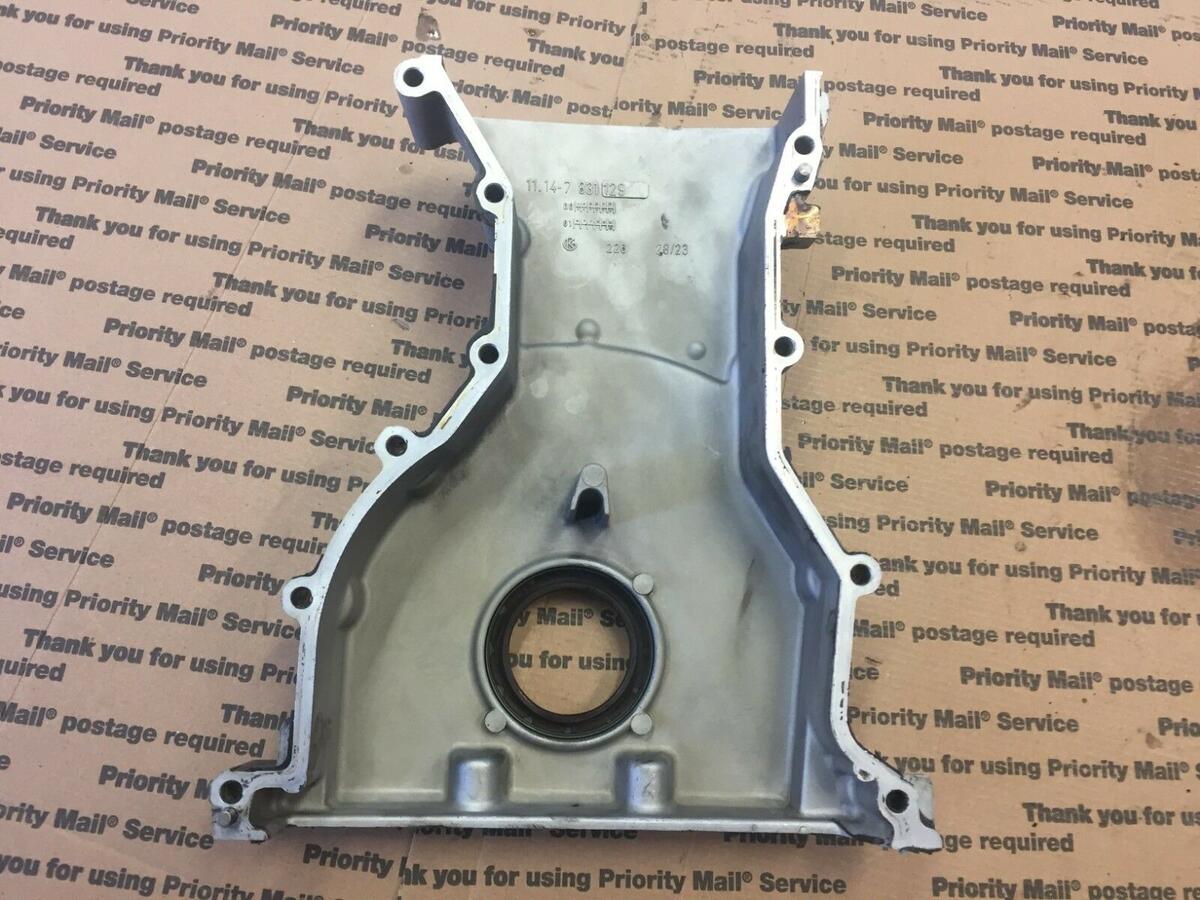

            Two questions:
            -How do I remove it? Looks like I need to pull the water pump and crank pulley/balancer. Does that require special tools?
            -Is the timing cover located with dowels or can it be slid upwards into place?
                  There's two dowels on opposite corners of the cover itself. But there's still just about enough play to get the cover back on without completely destroying the head gasket.
