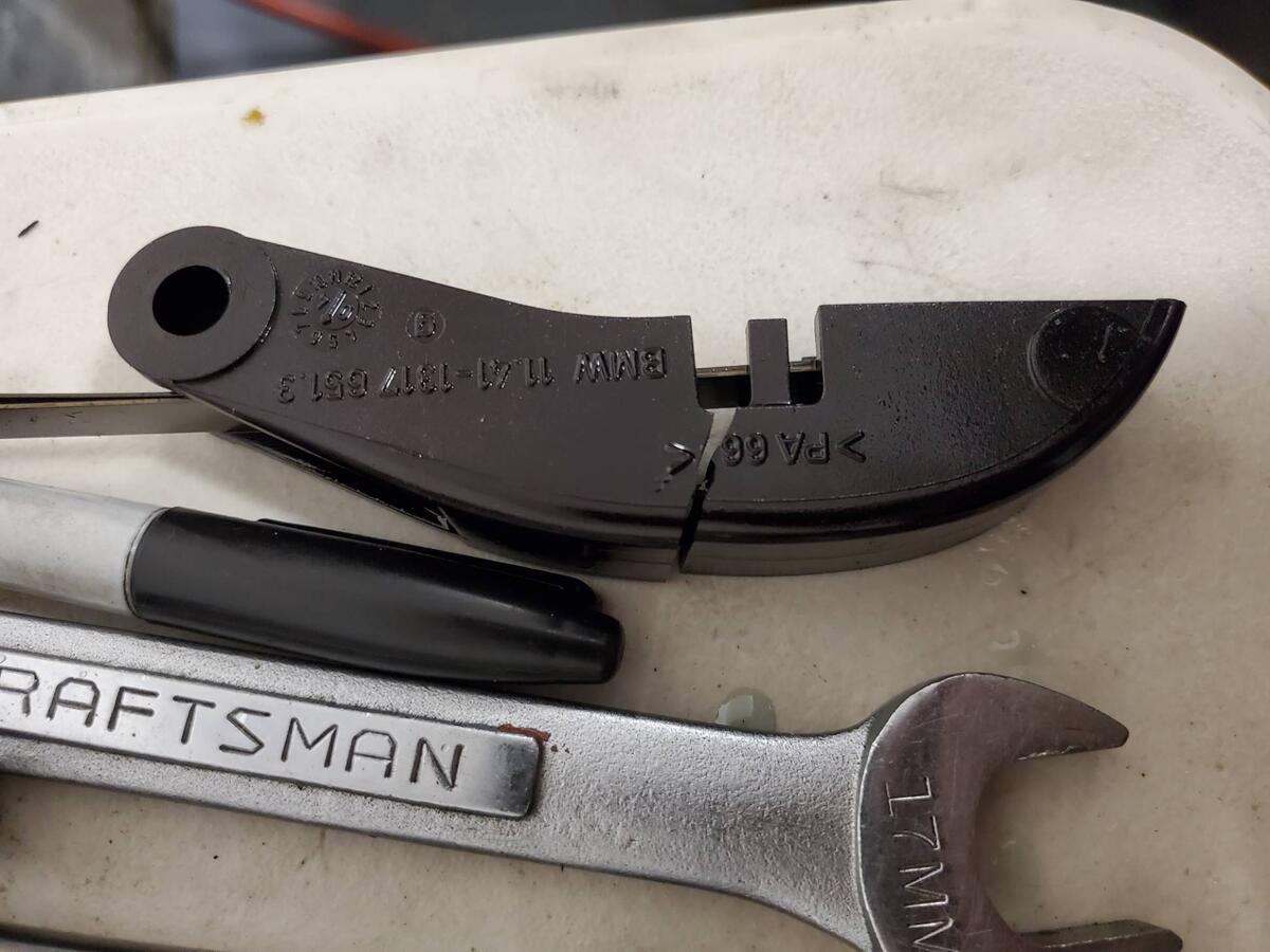

    I got the timing cover off. That was really easy. A couple taps with a mallet and it just popped off. The head gasket is the typical viton-coated MLS gasket it looks like. I think I will be able to seal it up no problem with some carefully placed low-viscosity MotoSeal.
    Couple more questions.
    1. Should I try installing the cover first, then the seal, or install the seal into the cover first? To me it seems like installing the seal afterward would be easier than trying to wedge the cover in there, aligning both the dowels and the seal at the same time.
    2. What makes installing the seal difficult? I have installed hundreds of seals and never had a problem damaging them. I just wrap a little electrical tape around the sharp metal edge, grease it up, and slide it on. Then I could tap it into the timing cover with a piece of tube?
    By the way, here is my oil pump tensioner removed. Amazing how brittle this plastic is. I can't be the only person to have broken it while messing with the oil pump???

    1. I did the timing case cover first then the seal. The seal will fit tightly around the case/crank so I suspect you’d have a harder time doing it with the seal on.
    2. I simply lightly lubed up mine and used the ring off c clamp that close let matches the OD if the seal. Tapped it with a hammer and all is well. Just pay attention to how far into the case cover it is right now. TIS calls for 2-4mm past case seal lip IIRC
      Install the cover first, then the seal
      The part of the seal that seals against the crankshaft is super fragile. If you don't get it to slide on perfectly, you'll tear the seal. It's not one of those spring type radial seals, it's just a very thin piece of rubber on the inside of the seal. Kinda hard to put into words, but you'll understand when you have it in your hands.
