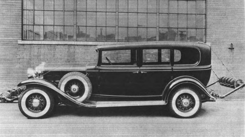

          I researched the origins - it dates way back, pretty interesting stuff: https://www.millikenresearch.com/Mau...WFMilliken.pdf
          I am currently running Ohlins spring rates (400/630) with stock sways and I like it a lot. Not what I'd consider super compliant, but the chassis balance and response is amazing.
          If you're scraping you might need to raise your car.
