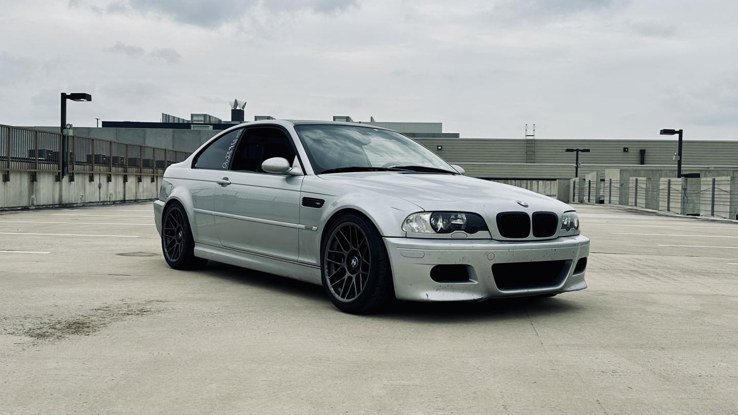

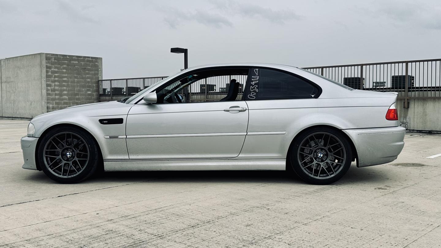

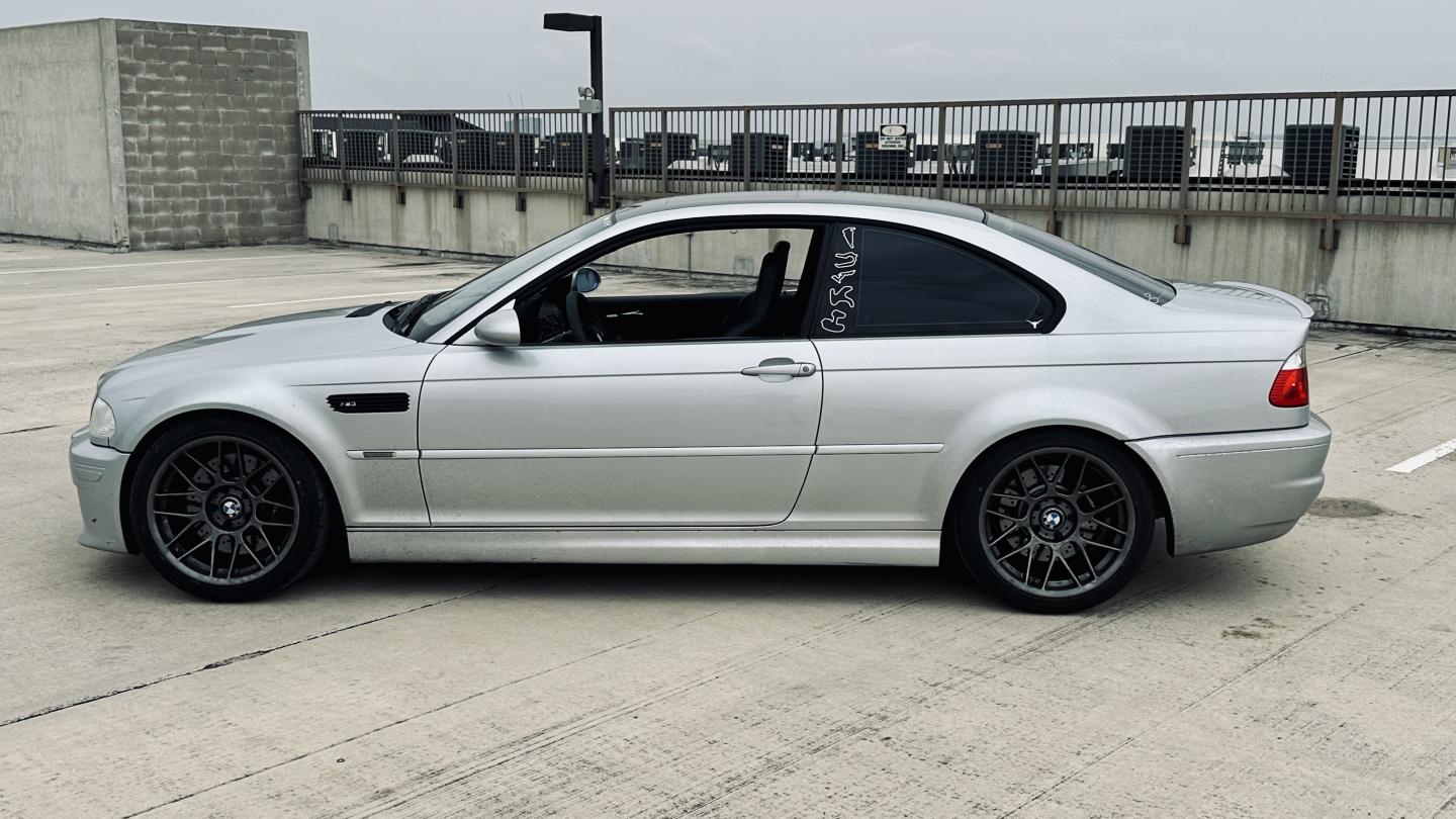

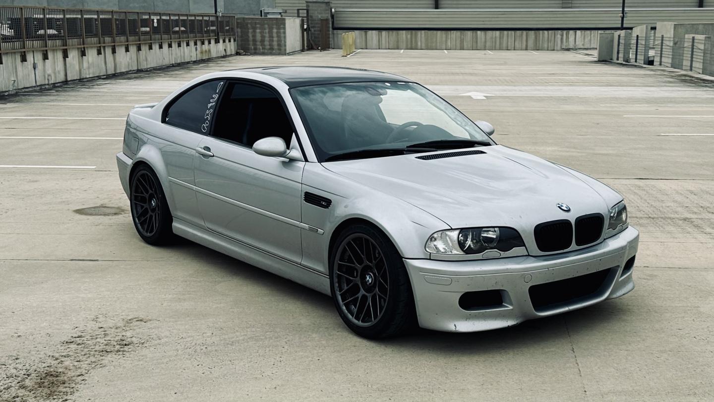

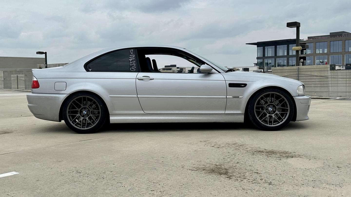

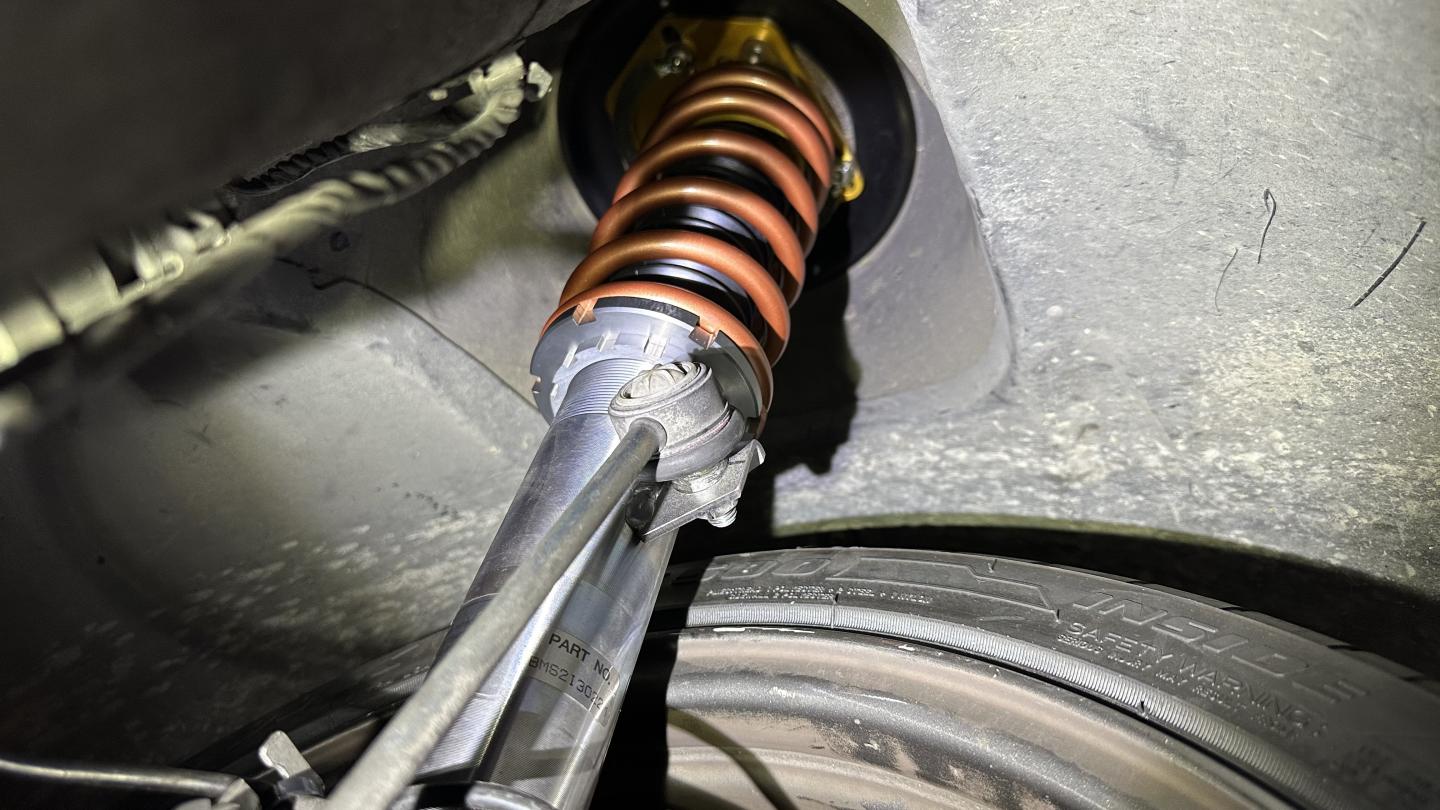

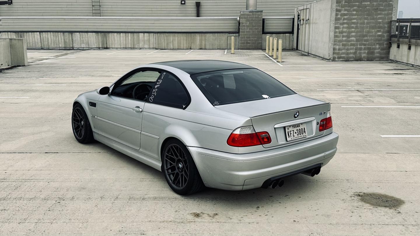

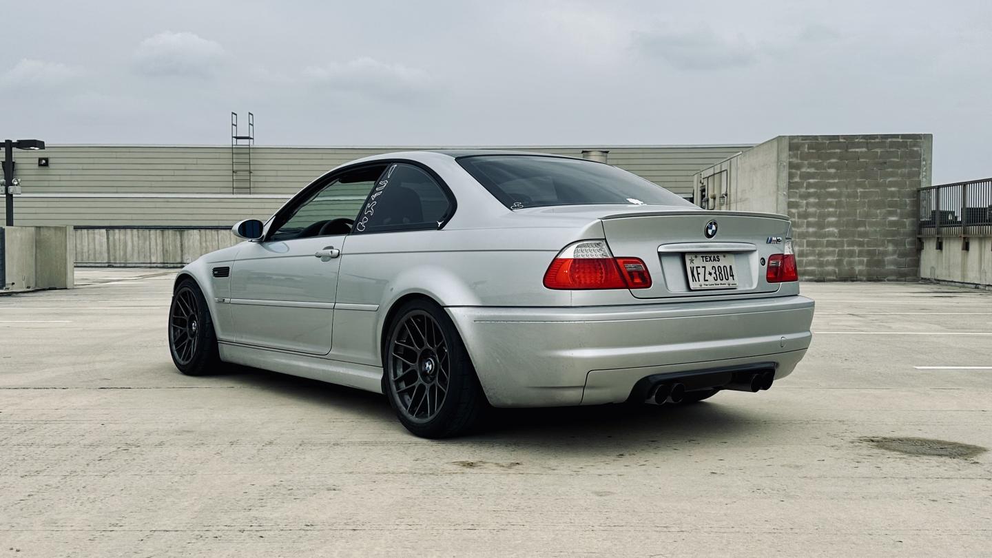

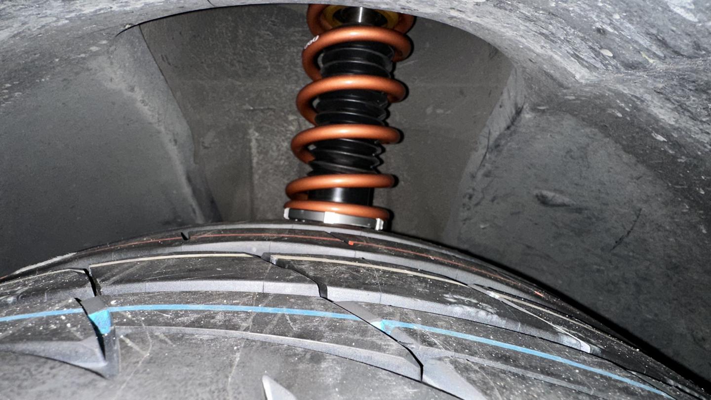

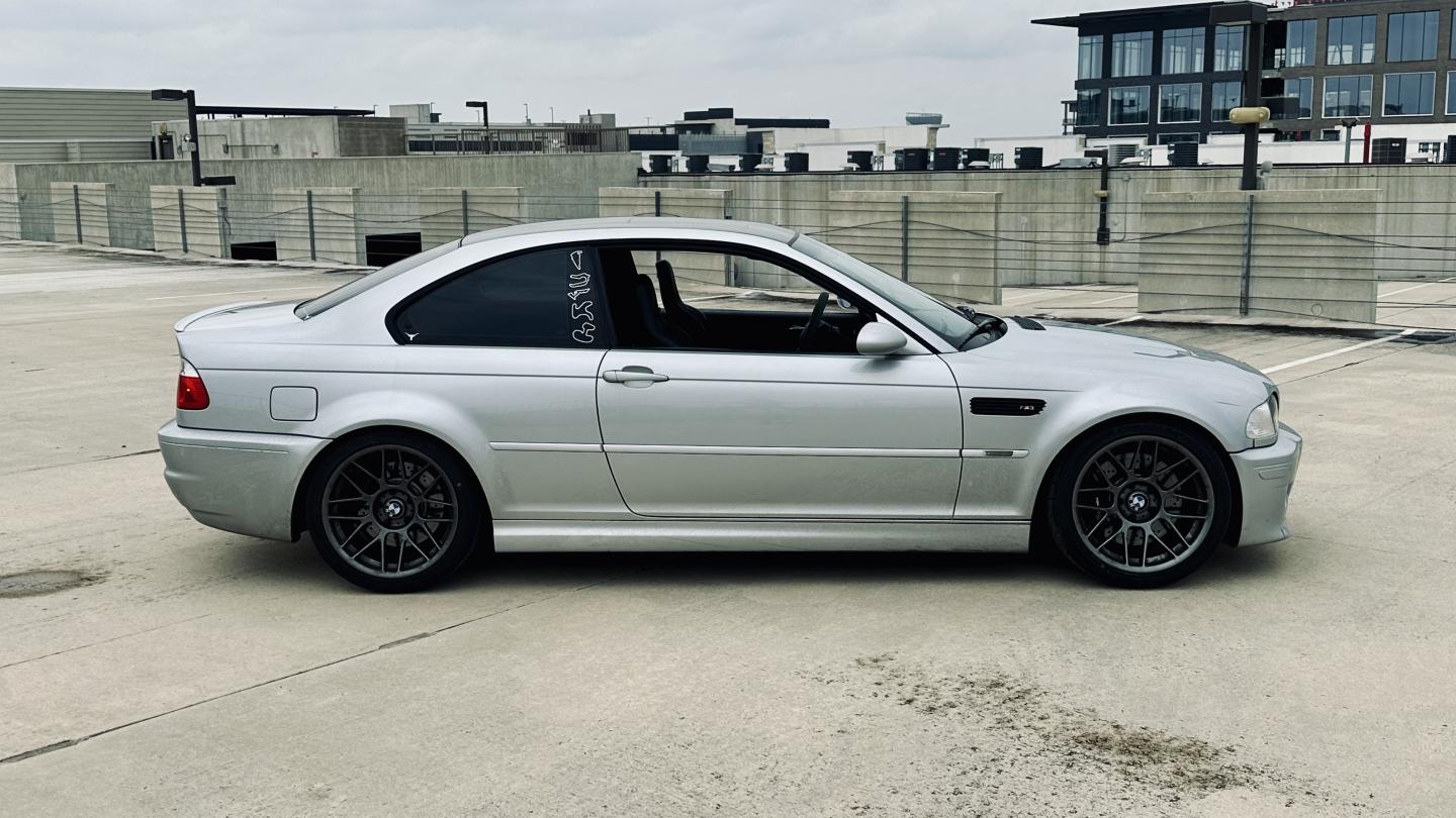

            Photos of the car at 13.5”F and 13.0”R (left side 1/16 to 1/8” higher to account for 160ish lb driver). Springs are 336 lb/in 8” Swift springs up front and stock Ohlins 628 lb/in springs in the rear. I may end up raising the car 1/4” on all four corners.
            As far as ride quality and comfort goes, it feels much better than my old MCS 2WNR setup on the street with 600/700 and 400/700 springs. While it does handle larger road imperfections well, don’t expect it to feel like an SUV. It does feel a tad more firm than my other M3 with PSS10s, but that car has 550 lb/in rear springs and OE RTABs and FCABs. The silver car has TMS spherical RTABs and FCABs. One issue I have is that at parking lot speeds, the front end is clunky going over road imperfections. This was also present when I had the MCS setup, so I suspect the noise is coming from the FCABs, which I will probably replace with OEM.
              Car looks great and sounds like it rides great as well. Let us know your thoughts and what damper settings you experiment with (and end up liking best).

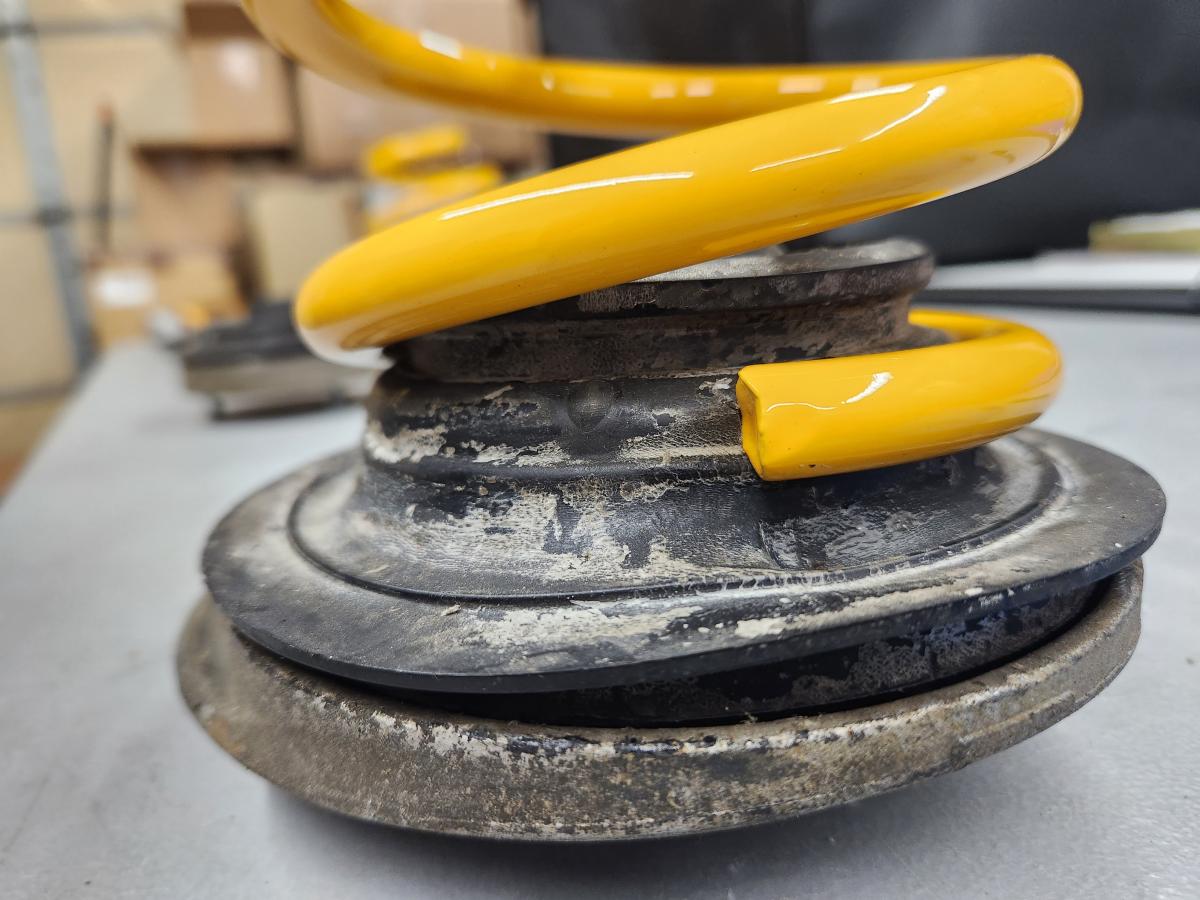

                Update on the Strohlins Kit. Barry confirmed that the E9x Ohlins front springs are a very close fit to the E46M3 Ohlins front damper. It seems like the rubber upper spring mount on the E46M3 stock strut mount will require a little trimming to get the spring seated properly. I have agreed to be the guinea pig. Bet my shop is going to love me for this.
                Attached are two photos: (i) one depicting the slight interference of the rubber mount; and (ii) one without the rubber mount confirming the spring will fit once the rubber is trimmed away slightly/properly.
                I will try to make time to run this to ground in the coming weeks and will revert. In the meantime, any thoughts, suggestions or ideas regarding the rubber mount are welcome and appreciated.
