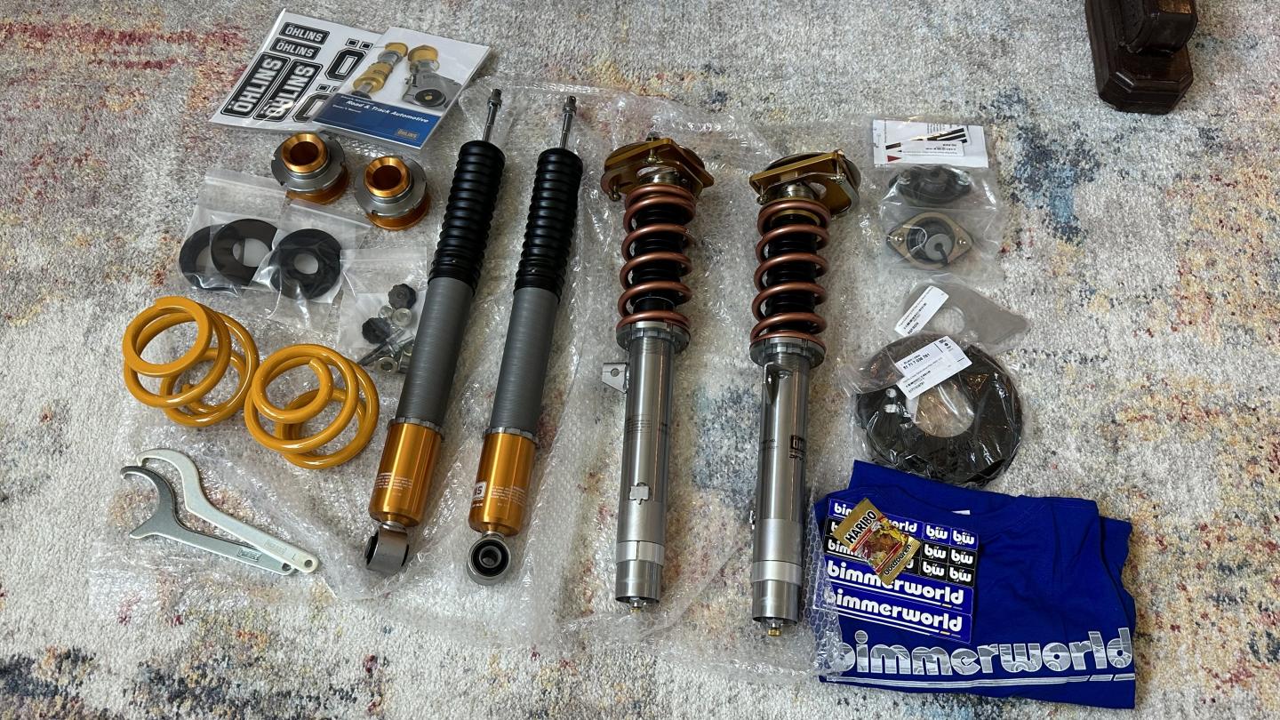

                      Swift PN: Z65-178-060 (7”, 65 mm, 336 lb/in). These do not get me to 13.5” with the lower spring perch on max height and the parts listed above (plus OE strut tower reinforcements). The car is sitting at about 13.25”. FYI, this is the Track Day kit that 3DM sells, with custom spec front Swift springs instead of the stock Ohlins 400 lb/in springs.
                      To get to at least 13.5”, I think I have two options:
                      1) Use a Hyperco CS100 helper spring to act as a 0.5” spacer and use the Swift springs that I currently have.
                      2) Swap to a 7.87”, 343 lb/in spring.
                      I’m leaning towards getting the 7.87” springs.
                      Slideways
                      Edit: Ordered 8” 336 lb/in Swift springs since the 7.87” Ohlins springs were out of stock. Will update with results soon.

                          I tried running 336# spring in 7" length with GC street plates and 3dm spacers and I did not get the car to 13.5, it was barely above 13.25 and on large bumps tire would rub the liner. 8" 325 or 336 spring would work.
                          I ended up running 350 7" front and I'm kinda "stuck" with this for now (absolutely don't mind it) because the car is corner balanced (i.e. $). I ended up getting GC adj swaybar links and running Vorshlag plates and RSM.

                              Yes, spacers are necessary, otherwise your car will sit too low. A longer spring won’t help—your limiting factor here is the length of the strut.
                              If you have any interest in running a flat ride setup, you might as well go thru 3DM and spec custom spring rates at no extra charge. They also preassemble the kit, which saves you some time. They should be able to sell you the TrackDay kit with the Meyle RSMs and let you send in the GC camber plates…obviously in this case they’ll subtract the cost of the included Vorshlag camber plates from the kit. Also, if the Ohlins sale is still going on, he may be willing to price match the cost of the R&T kit.
                              I’m installing 8” 336 lb/in Swift springs this weekend and will follow up, since the 7” 336 lb/in springs have me sitting too low.
