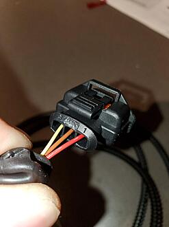

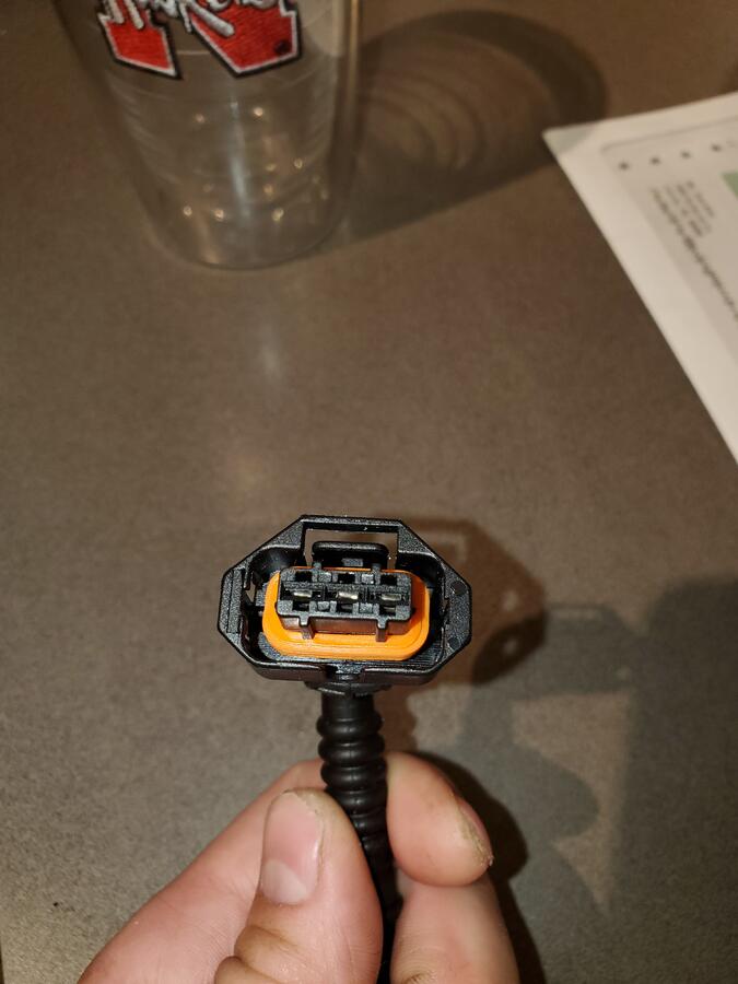

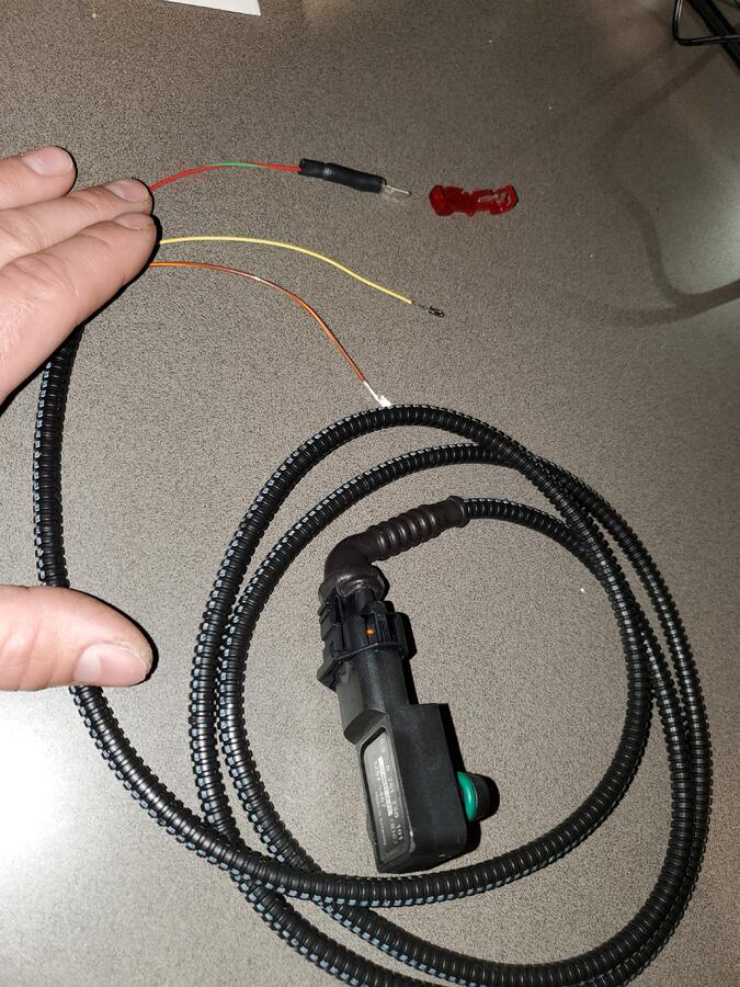

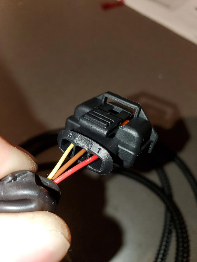

                Anyone else running the Turner IAT relocation harness along with the Kassel MAP sensor setup?
                I sure wish Kassel would have given some basic instructions, there are 2 wires with little metal "tabbed" ends that terminate in the DME harness, somewhere. Than the third wire on the Kassel MAP setup is simply a T-tap.
                Can anyone tell me if there are any issues using these 2 products together?
                I obviously don't have a complete understanding of the wiring for a CSL box yet. I'd sure like to better understand before I get in there.
                I have read through the posted DIYs and I very much appreciate the info. I am probably making all of this much more complex than need be.
                Heres a picture of the Kassel wiring...
                Click image for larger version  Name:	20200421_214845.jpg Views:	0 Size:	134.8 KB ID:	15324
                Click image for larger version  Name:	image_5695.jpg Views:	3 Size:	40.1 KB ID:	15328
                This is my current plan:
                - IAT: plug in Turner Harness, done.
                - MAP: (Kassel) wiring as follows
                The MAP sensor is wired to the DME via 3 wires.
                The wires are connected in the following manor:
                MAP Sensor – Pin A to DME – Splice to X60003 Pin 17 (Brown/Orange) or insert a new pin into X60003 Pin 16 – Ground
                MAP Sensor – Pin B to DME – Insert a new pin into X60003 Pin 18 (Yellow) – Signal
                MAP Sensor – Pin C to DME – Splice to X60003 Pin 7 (Red/Green) – Shared Power (5V)
                  #38
                  Wiring the MAP sensor that way should work just fine.
                  ​​​Not really familiar with the Turner harness, but I'm assuming it just splits off the wires for the IAT sensor (can't think of what else it would be doing). I would be surprised if combining these two products didn't work.

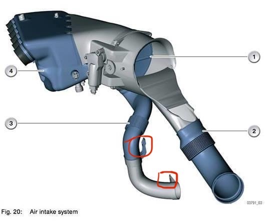

                    #39
                    Originally posted by mainstreamer00 View Post
                    You could run "9,10,15" in this scenario, which I believe is meant to draw air from below the car/outside engine bay when the flap is closed.
                    As said above - for main snorkel intake, could run an Eventuri scoop or piece of ducting to connect with the hole in the top of the brake duct.
Name:	Screen Shot 2020-04-16 at 7.47.30 AM.png
                    I'm currently in discussions with a CSL owner in the UK to get pictures and an understanding on exactly how pipes 9, 10, and 15 are mounted from the factory. I'll be sure to share when I find out. It's been something I've been trying to find out for quite a while.
                      #40
                      Here you go:
                        #41
                        Here you go:
                        Thanks! Those are really helpful. Is that from a genuine CSL? Just curious.
                        Any pics on the #3 top pipe mount in the pic below?
                          #42
                          Here you go:
                          Any other pictures or details around this mounting bracket? I couldn't find anything on realoem.
                            #43
                            So there is nothing there on a normal
                            m3. You’ll have to either drill it and install it with a nut and bolt or put a stud there and use a nut to secure the hose or it’ll touch the belts. Don’t ask me how I know lol
                              #44
                              Same thing happened to me when I ask the shop to install it. Burned through the plastic pipe and now I have to source new ones. Kinda pissed. That is what prompted me to find the proper way to mount these.
                              I know there is nothing there on the normal M3, which is why I'm asking how its done on the CSL. What mount is shown there in your pic? If its OEM there has to be a part number.
                                #45
                                It is Not OEM, its a stud we installed and used a nut to secure the pipe. There is no OEM part number as far as i know for a stud for that location.
