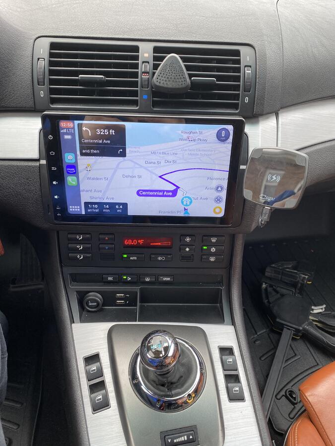

          I recently upgraded to the AVIN PX5904GB32-E469 9" Touchscreen Multimedia Navigation System. I detailed my set up and parts on my build thread (https://nam3forum.com/forums/forum/m...black-cinnamon). Overall I have really enjoyed the unit. I am big into the wireless aspect of the system so being able to utilize carplay was a great plus. It's far from traditional but I love the modern touch.
