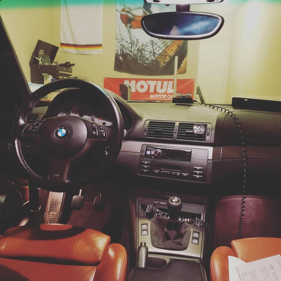

                    Did you upgrade to the 15 band EQ? I'm thinking about trying out the Avin. I'd like to ditch the previous owners aftermarket radio that looks like it's from WalmartClick image for larger version  Name:	IMG_20200329_012923_653.jpg Views:	0 Size:	80.8 KB ID:	19925
                        I did - I really can't compare it to the non EQ version though since i haven't listened to it. Honestly with Apple CarPlay, my car feels just as modern as my new Cayman S. Go for the Avin!
