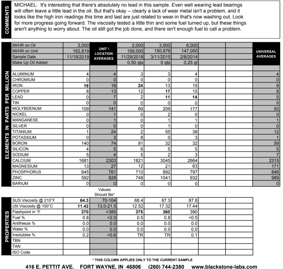

              Been using Eneos Sustina 0w50 since my rod bearing service at 157000 miles. It's a bit on the thin side it seems, but so far so good.

                I use Eneos in my wife's Sonata. It's really good oil. Not sure I'd personally run anything that thin but glad it works.

                  Do brand new rod bearings typically show lead in the first few oil analyses? Or does that take a couple intervals before it starts showing up again?
                  I'd be curious to see what a longer OCI looks like on that, like 7500 or so.

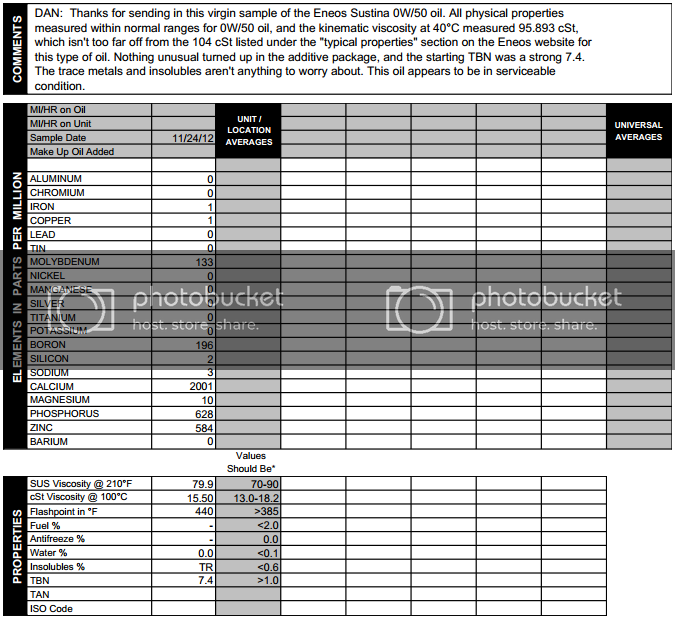

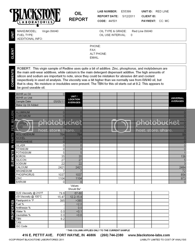

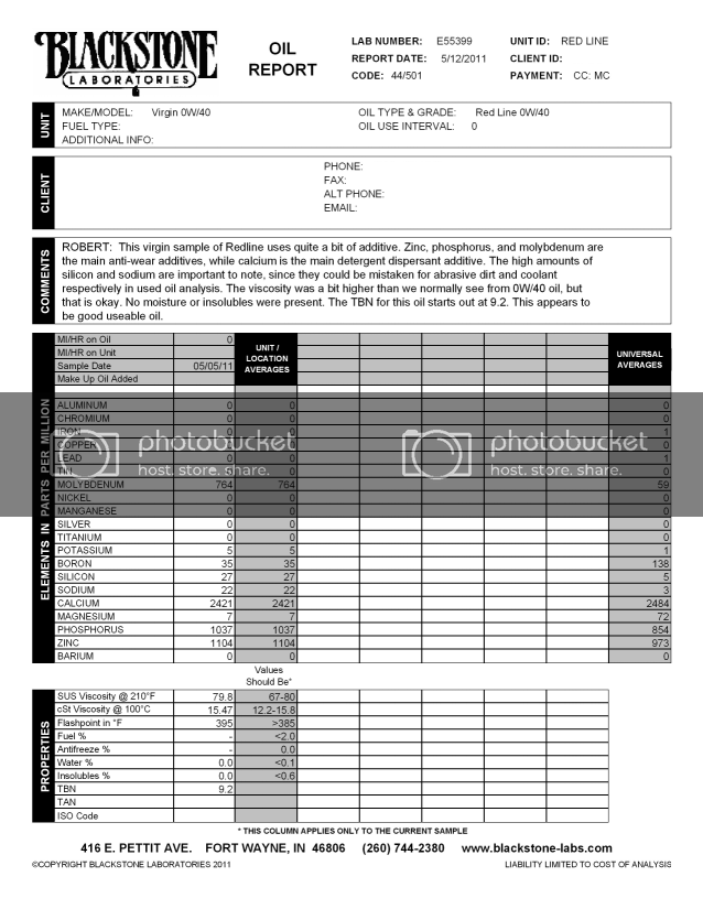

                  By comparison, here's a VOA of Redline 0W-40 side by side.

                    I'm really not a fan of these oil tests. I wish there was a way to actually test the accuracy but they seem to be the only ones doing it.

                      FWIW, there are actually a bunch of companies that do oil analysis. I wish more people knew this as Blackstone is... good, but not good enough to deserve their perceived monopoly.
                      I use Polaris Labs. They're relatively annoying to get started with (you have to call/email them to set up an account before you can order), but they sell 10-packs of analysis kits that give you a significantly better test package for less money than Blackstone charges.
                      MRT Laboratories and CAT are two more examples (not really familiar with their offering). If you want to shell out more money for a much more comprehensive analysis package plus personalized and detailed advice from a mad scientist, you can go to Dyson Analysis.

                        I don't buy into them like it's the gospel or anything, but I think they provide objective information especially when you're comparing numbers between their tests. You would hope that their practices, regardless of the specific methods, would be consistent (reproducibility vs. absolute accuracy). I think it's also important to have a VOA to compare with a UOA, otherwise you don't have the whole story.
                        Looking at those two VOAs, I think it's interesting that this specific 0W-50 essentially looks like an 0W-40. I've seen lots of suggestions that S54s do fine on 0W-40 but who knows.

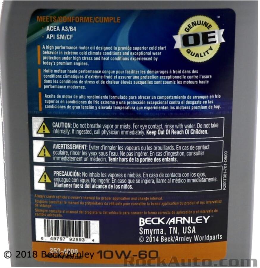

                            anyone try beck/arnley's oil? its pretty cheap on rockauto.com
                            I would never buy it, just curious if anyone has experience with it.

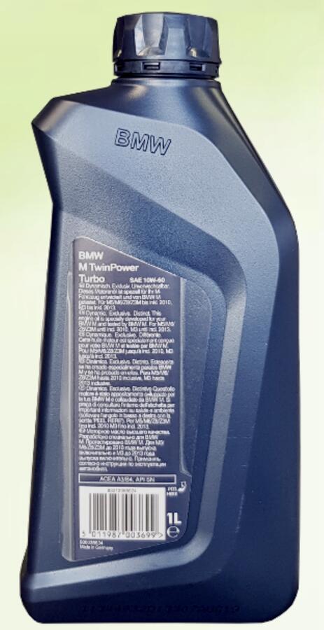

                              Beck/Arnley’s 10w60 oil has an API Service rating of SM.
                              BMW Twin Power and Castrol Supercar in 10w60 both have the current “SN” rating.
                              Below is a description of API’s rating system.
                              For this instance, I’ll stick to the old saying, if one can’t say anything complementary, don’t say it at all, but from this information, draw your own conclusion about Beck/Arnley’s quality.

                                I am not an expert on this topic, but arent both of those backwards compatible? I believe SLis for the E46 M3 era and thus anything after that should be fine. Liqui Moly is SL as well.
