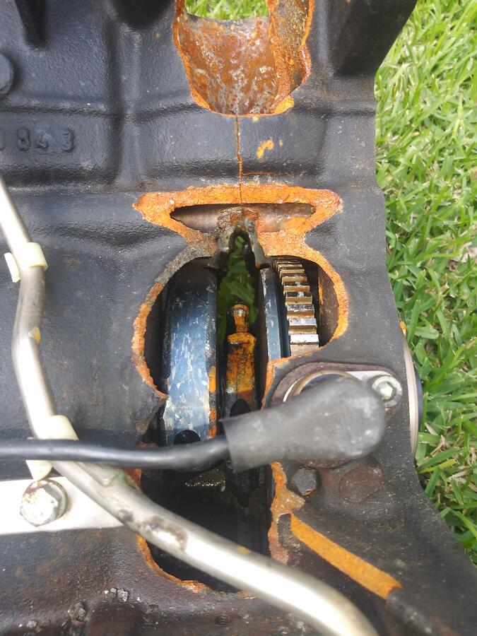

              I brought my oil filter housing to a solvant tank and got the chunks out the best I could. There wasn't much as my engine ran for maybe 3 seconds after it blew. I'm not that worried as it didn't seem contaminated when I drained. I think there's just a little bit. I hope I'm right.
                Click image for larger version Name:	20200404_165913.jpg Views:	0 Size:	108.8 KB ID:	11783
                That sucks, man. Sorry to hear/see that.
                Trying to think what I'd do beyond what you've already done. If all of the relevant parts were drained, flushed, and cleaned, I probably wouldn't worry about a thing. Maybe a 500 mile initial OCI and then full send. Otherwise, I'd probably start with your idea of running it a bit and then draining immediately, and then do another complete oil change (ideally draining the oil cooler as well) after 100 mildly driven miles, changing the filter each time.

                  It happened back in June so I've mourned, went the 5 stages of grief and came to terms with it. Now I have a "fresh" engine. The bearings looked really good so no bottom end problems.
                  That not a bad idea. I'll be driving mildly for 1200 miles because BMW specifies that for new bearings. Draining the oil cooler is one bolt so that's easy. It's just an extra quart or so. While that is a long time to break something in, I'm trying to avoid a recreation of anything that cause my engine to blow. I think neglect played a part in it, before I bought the car, but I'd rather be cautious.
