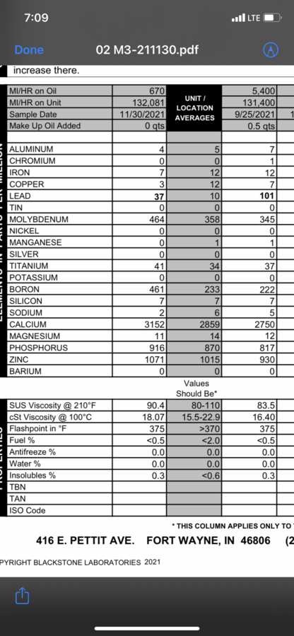

          What's a normal lead reading after a rod bearing change? I thought elevated lead was normal.

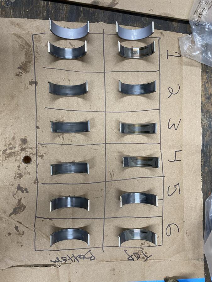

                  Update all, oil interval was much smaller this time around but lead is still elevated. Turned out my bearing are eating themselves alive. Which is a bummer. Time to get a proper torque wrench and some plasti gauges. Reorder from FCP. And figure out what else I need. Thank god for the FCP warranty. I’ll keep up with this chat and repost how bad these bearings look when I change them out Click image for larger version

                            I assume you’re not running leaded fuel, right?

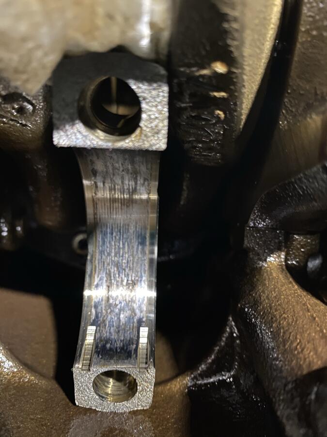

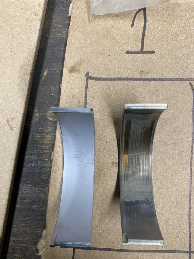

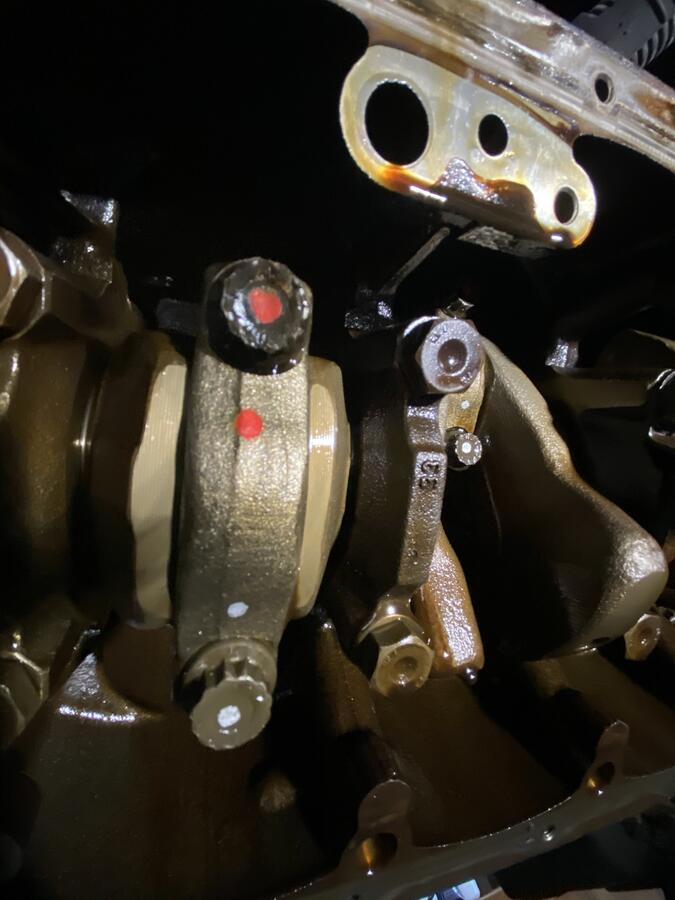

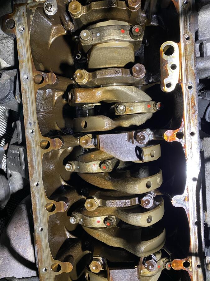

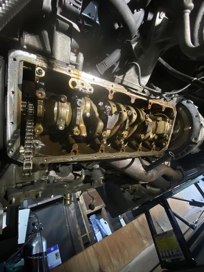

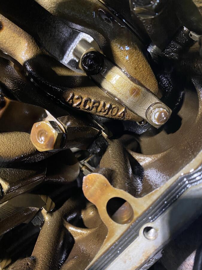

                              I wish I knew because I’m quite meticulous about my car and torque specs. Especially because I take it to the track. Always better to be safe then sorry. Anyways. I really won’t know how I f#%{ed up until I get in there which will take a couple weekends. But I dove into my photo bank and have these. I used the regular torque sequence on the car since the car is a “2002” but was produced in 07 of 01. So don’t quote me on this because I did the job a year or two ago but it’s like 80 ft lbs plus 90 degrees. So in doing so, the 90 degree part is the ONLY place I think I could of messed up. I used an angle finder attached to the torque wrench. Maybe I went 1 degree off on one of the bearings and that’s what I’m seeing as it eats itself alive. Also I used a ton of bearing lube, forgot which one but it’s the one everyone recommends, the photos shows how I applied it. And I paint marked them up so I wouldn’t mix up the boltsClick image for larger version

                                1 degree won’t cause an issue. 10 might... I’m assuming the crank was not damaged, none of the old bearings spun and you thoroughly cleaned and dried the bearing to cap surfaces? It’s just a delicate job, maybe some dirt got lodged behind the bearing, or maybe you just received a bad bearing. Whatever the case, stop driving it and good luck. Update with pics of bearings!
