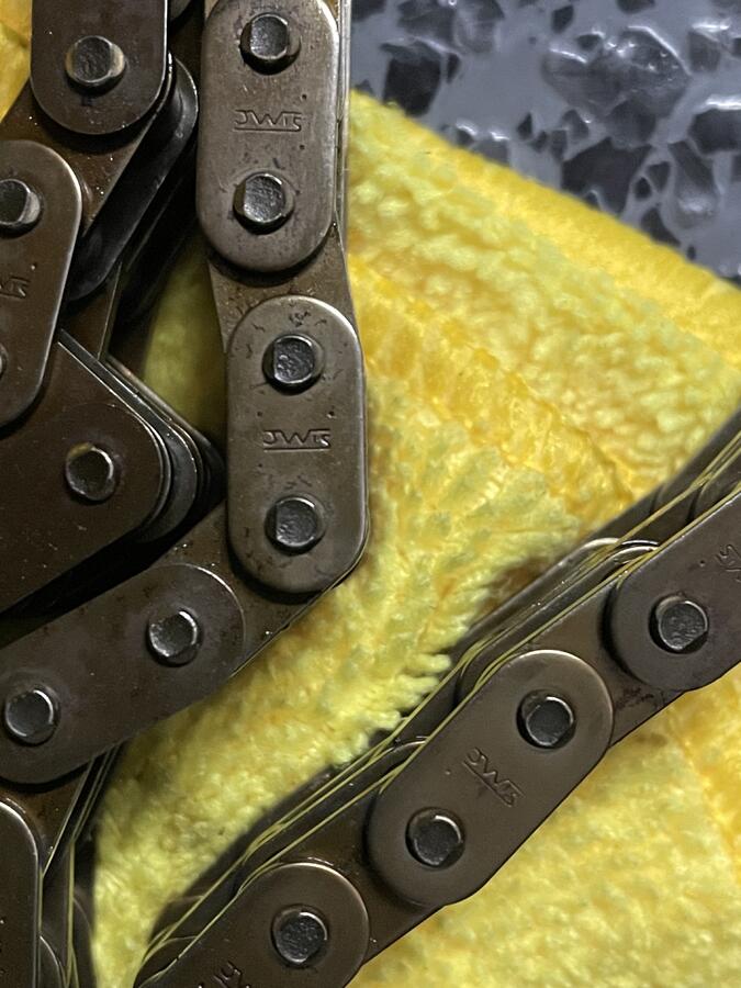

                    Original timing chain for anyone wondering. That would indeed be IWIS

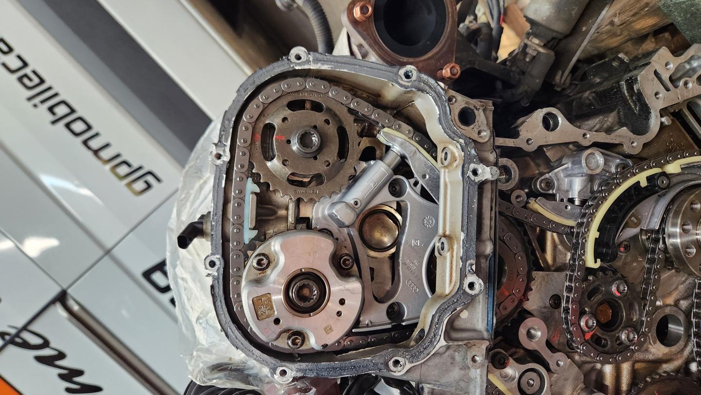

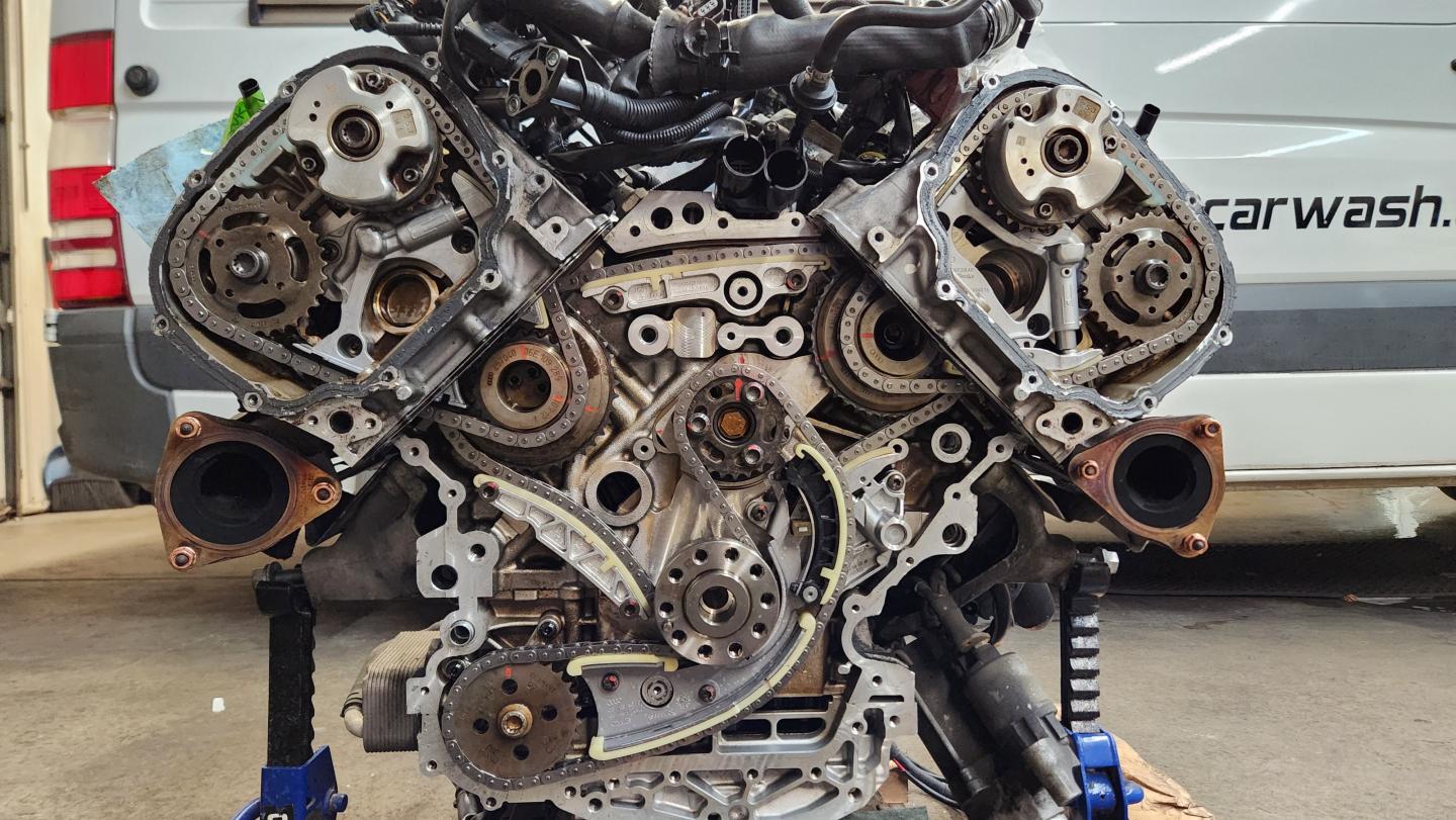

                                Anyone else have success R&R'ing the timing cover without head removal? Mine is already leaking but I suppose that could be made worse.
                                I remember doing an audi timing chain job and the factory instructions allowed you to install the timing cover without removing the heads. The heads/head gaskets protruded maybe an inch out, so not as much as the S54. I remember the manual had you chamfer the alignment dowels for the cover to allow for more of an angled installation rather than staight on. With some drei bond on the HG all was well and that was a massive cover.
                                Click image for larger version  Name:	20240409_110039.jpg Views:	0 Size:	221.5 KB ID:	306749 Click image for larger version  Name:	20240409_110055.jpg Views:	0 Size:	196.1 KB ID:	306750
