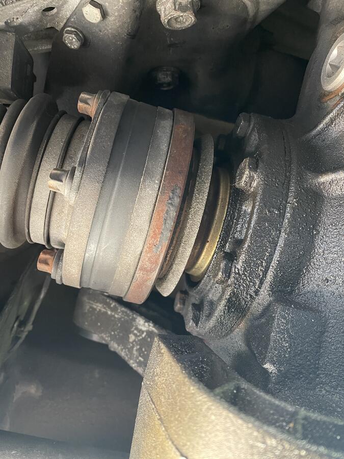

                        Right rear axle is wobbling around when I rotate the right rear wheel by hand. Pretty sure I need a new diff.
                          My gut no longer says brakes, LOL!
                          Wobbling how? Inside the diff? At the inner or outer half shaft/CV?

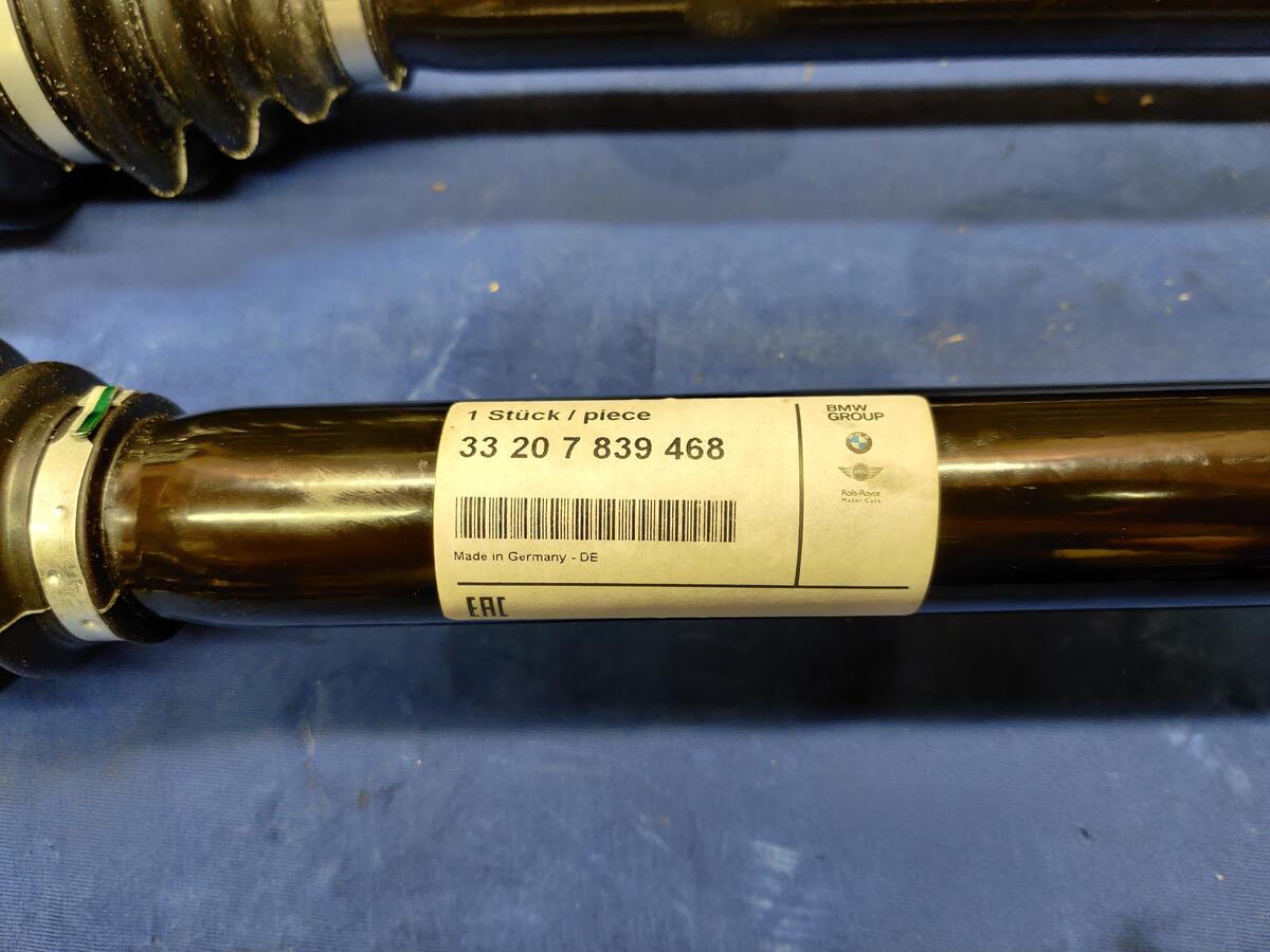

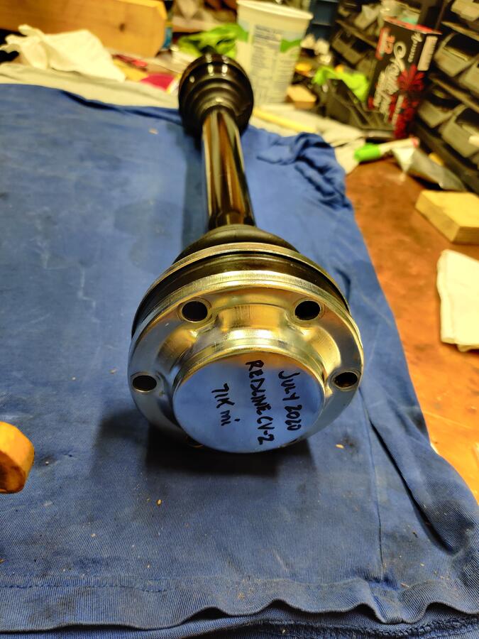

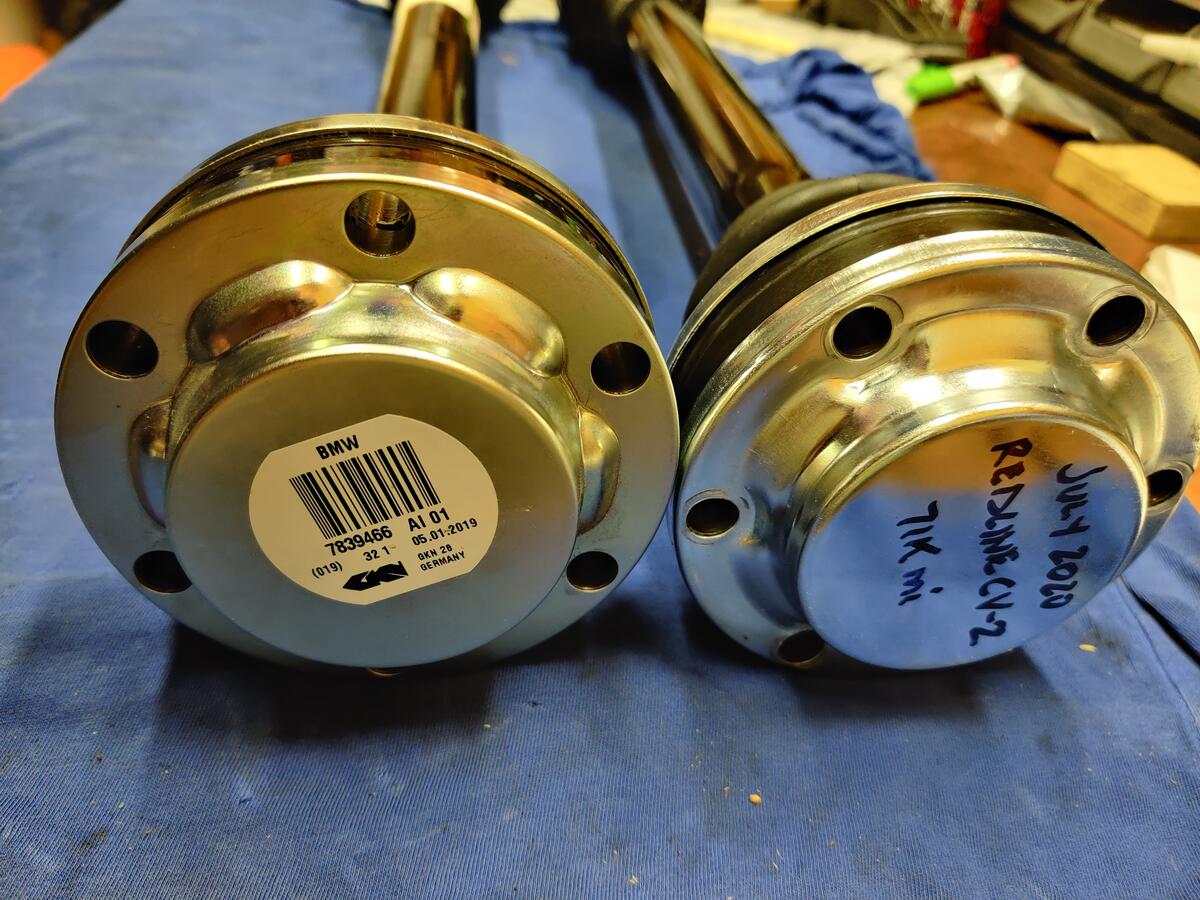

                          I had to replace the passenger side half shaft on my car at 73k miles. That's early, but these cars are harder on the passenger side axle than driver side.
                            Make that 71k. Here is the driver side I cleaned and repacked at the same time. Passenger side was notchy as hell, driver side was smooth as glass. I went with a remanufactured OE/BMW part.

                              The damage
