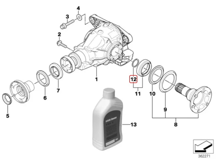

    There are splined shafts on the drive flanges (#8 below) that mesh with the spider gears inside your diff. They slide into the diff and are held in place by a cir-clip/lock ring (#12 below) internally in the diff. It looks like your axle has somehow pulled away from the diff, taking that splined shaft/drive flange with it. It could be from a failed lock ring or potentially something else. You likely have metal inside the case and possibly damage to some parts of the diff. Only way to know is to pull it out. You could pull the diff cover off with the diff still in the car, but you might not be able to see what's happening on the inside.
    Sorry man, was hoping for the best for ya'.
    For reference RealOEM: https://www.realoem.com/bmw/enUS/sho...diagId=33_1065

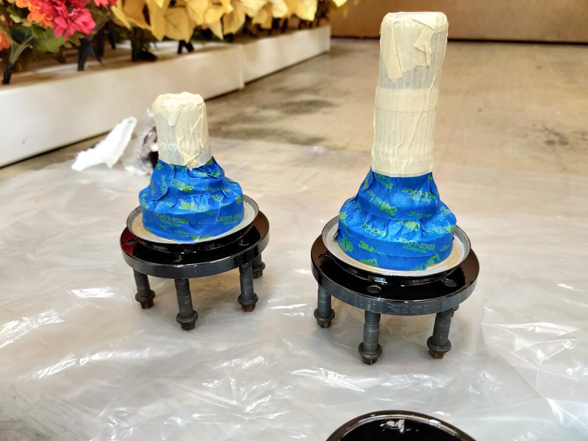

      Here's a shot of the drive flange and some other pics to give you a better idea of how it all fits together, hopefully. You can see the recessed groove for the lock ring on the drive flange/splined shaft. It's quite literally just a spring loaded lock ring and the L/R diff seals that keeps those drive flanges held in place. Something has pulled yours out.
      Driver side drive flange:

      Driver side on left:
      Click image for larger version  Name:	IMG_20200417_162524.jpg Views:	0 Size:	123.2 KB ID:	135008

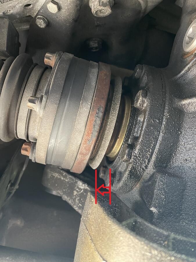

        The damage
        It's hard to say from the static pic. Better with a video showing the wobbling.
          Agree a video would make it easier. However, from this pic, it looks like the drive flange is about 0.5" / 13mm pulled out of the diff. The outer metal dust cover plate should be closer to the diff housing.
          Click image for larger version  Name:	M3 diff 2.jpg Views:	0 Size:	154.2 KB ID:	135019
            Good eyes. Then OP is lucky that the issue is just the drive flange popped out from the side-gear. All he needs to do is pushing it back into the diff until the C-clip snapped and lock it in place. But OP need to check the RH side suspension as to why it allowed the half shaft to pull the flange out too far.

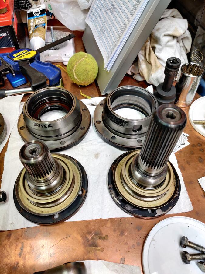

                    I have some side by side shots of the drive flanges. I didn't realize there was a difference (V1 vs V2). How much longer is V2?
                    Short of pulling the flange (which is currently assembled and in my car ), is there another way to determine? I may have a shot of the serial number sticker on the top of the diff. Would that tell us?
                    But the bigger question is, what would knowing this info tell us as it relates to the OP's problem?

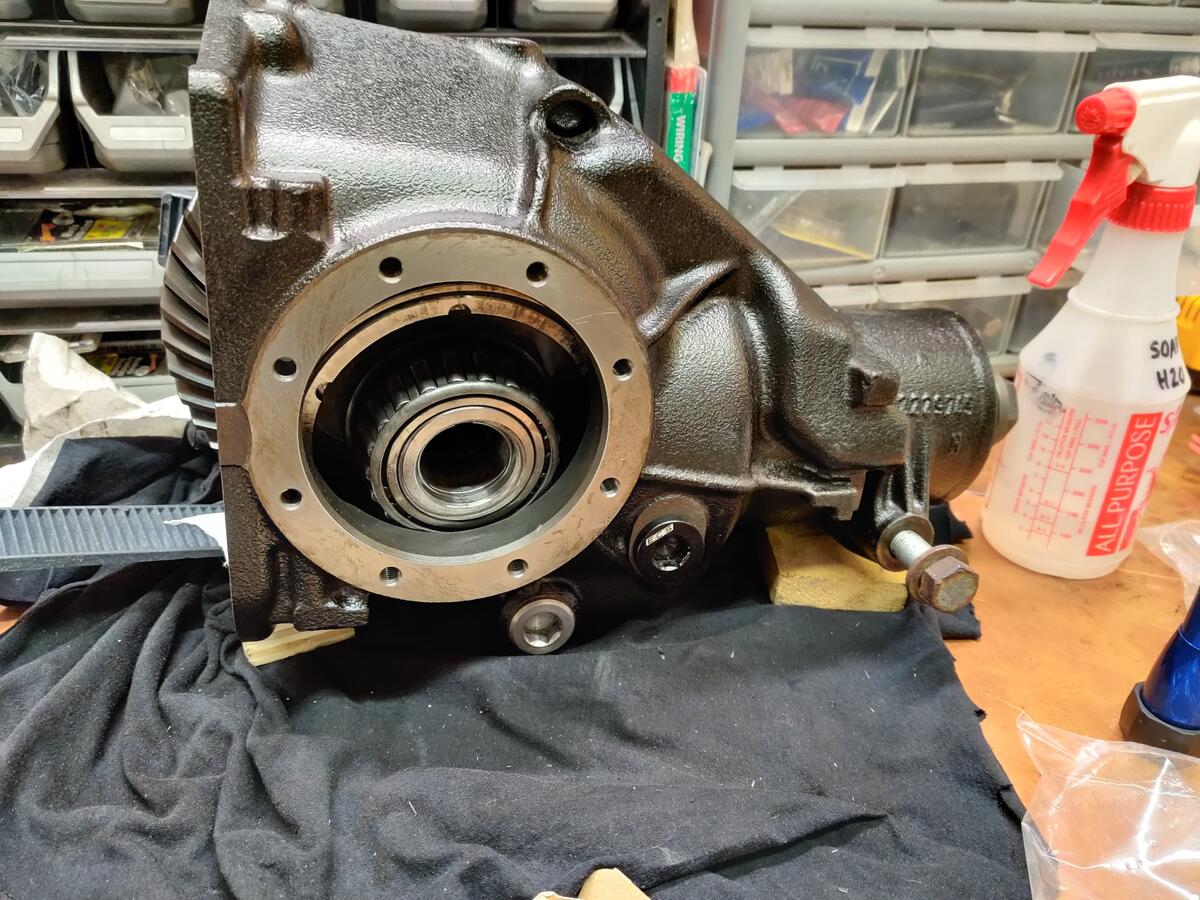

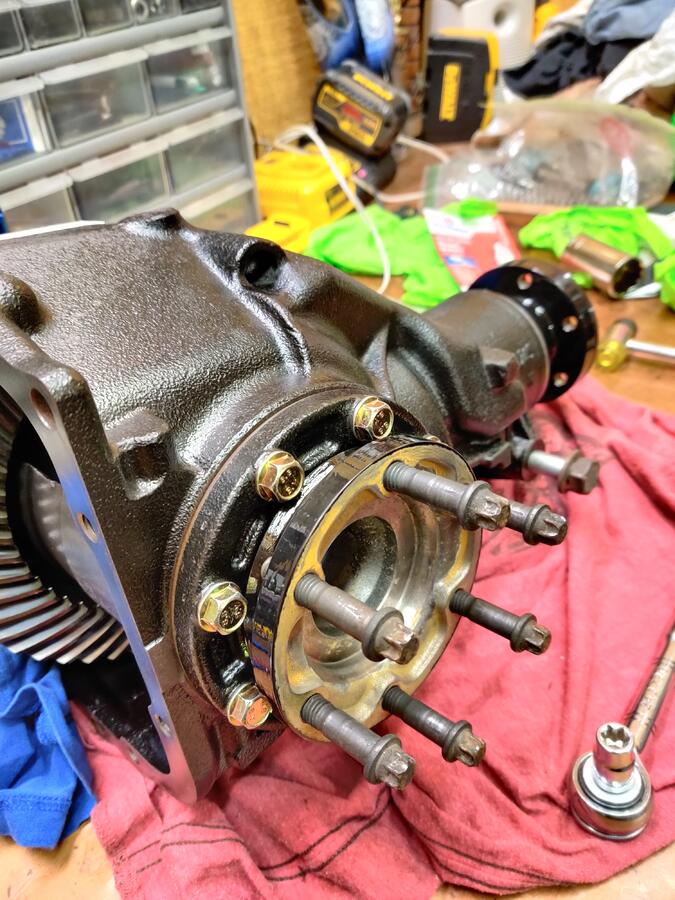

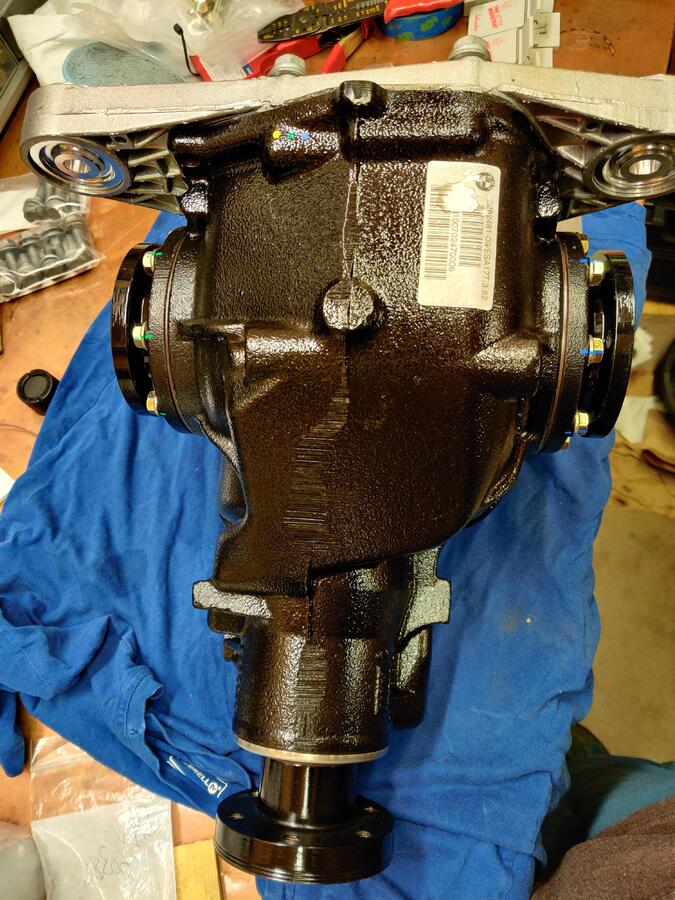

                    I looked, these are the only photos I have from when I replaced the seals and refinished stuff.
ID:	135033 Click image for larger version

                        Post #17 you wrote that the short flange is the driver side, LH side. The PO has the wobble flange on the RH side and this is possible that the spline shaft popped out of the side-gear only if he has the V1 version with the short RH side flange.
                        As to verify yours is V2, a pic of the oblong hole on the LSD "ball" would help. V1 "ball" only has round holes.
