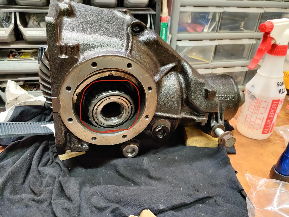

                        Click image for larger version Name:	IMG_20200510_172158.jpg Views:	0 Size:	116.8 KB ID:	135009
                        This pic looks like it is a V2 with the oblong hole on the LSD carrier.
                          #42
                          I didn't realize there was a difference (V1 vs V2). How much longer is V2?
                          V1 has the spiders on the right side of the carrier, hence the right side flange is shorter than the left one.
                          V2 has the spiders on the left side of the carrier, so the left flange is shorter.
                          The shorter flange tends to wear out the oil seal quicker as it wobbling more.

                                Only about 1mm of the spline shaft end is damaged from grinding. Try to clean the metal bits off the carrier tapper roller bearing. Nothing have blown.
