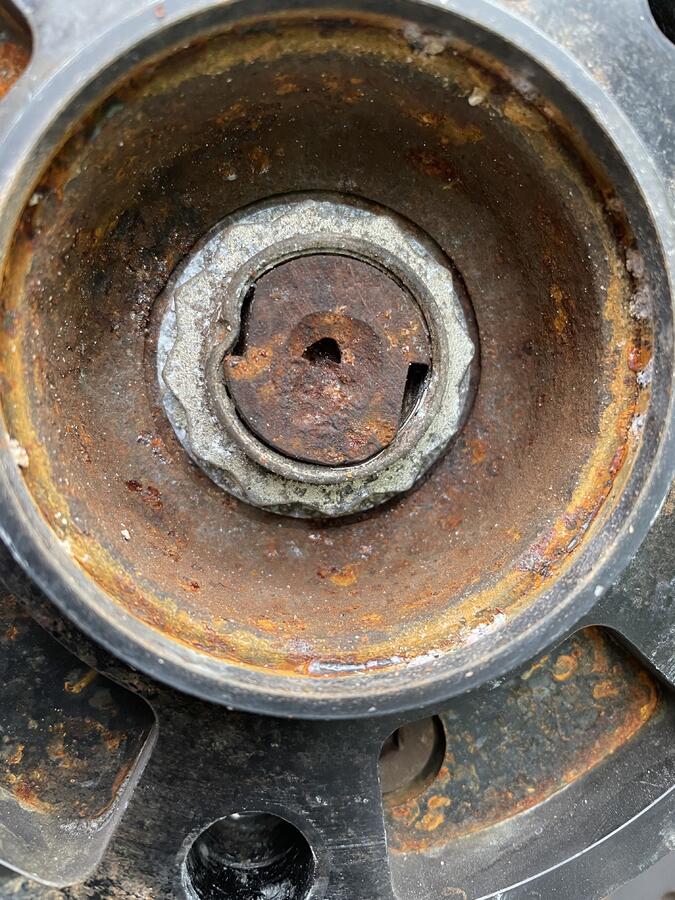

    To remove the right output drive flange, I would have to remove this nut first right (axel/cv joint nut)?
      No. you only need to unbolt the 6 bolts holding the inner CV carrier to the drive flange. It will be tight getting the axle to drop given that flange is already pulled out some, but the axle should drop out of the way. Then the flange should just pull completely out.
            No wonder…. cuz that mf is tough to come out LOL..
            hahah! yeah and you need a puller to separate the axle from the bearing that sits behind that castle nut.
              This is the wheel hub to axle shaft nut which could be like 150 to 200 ft-lbs torque!!!
              As Casa said, just remove the CV joint off the flange, and pull the CV aside and hang it using string. Don't let the heavy CV shaft hanging by itself as this could cause damage to the other CV next to the wheel. If you still cannot pull the CV off aside, then you need to push the flange back in to give more space.
                I believe you are correct. Because this baby ain’t going nowhere. Just wiggling. Gotta push the flange in deeper to create space. A lift sure would be nice lol

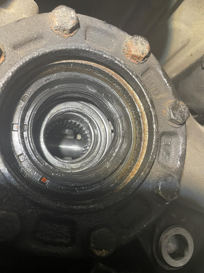

                      The moment we’ve all been waiting for
                      https://youtu.be/BaUwflCvWkk
                      It doesn't look bad!! Hard to tell over YouTube of course, but doesn't look too bad. 100% I'd flush the fluid, and try to hunt around in there with a magnet.
                      Also, the lock ring is still in there and not broken. Which surprises the hell out of me. I'd order a new one along with that seal. Also, do you have any idea what cause it to pop out? Do you off-road rally the car, lol!

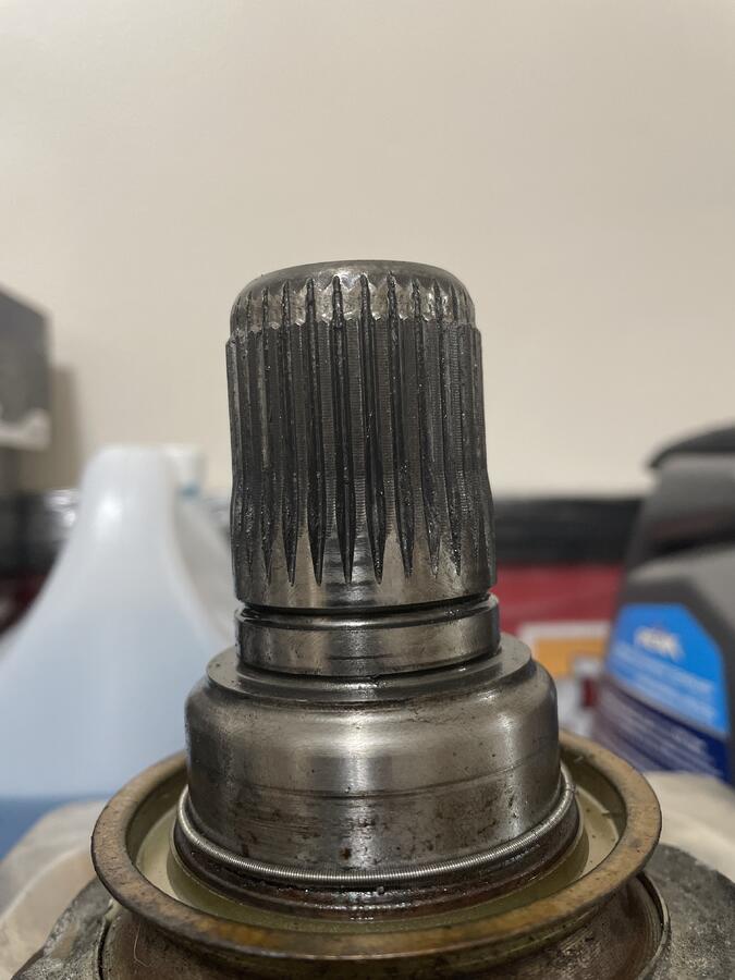

                        Still picture
                          Also, I'm going to start a GoFundMe and see if we can't scrape up enough chedda' to get you some new gloves!!!!

                            Better pic
                              #59
                              This is what I feared... How's the splined in the diff look?
                              I can't remember if those drive flanges are $$$ or not too bad.
                                Still picture
                                just saw this, missed it in my previous post. Hard to tell with that pic if you have damage or not.
