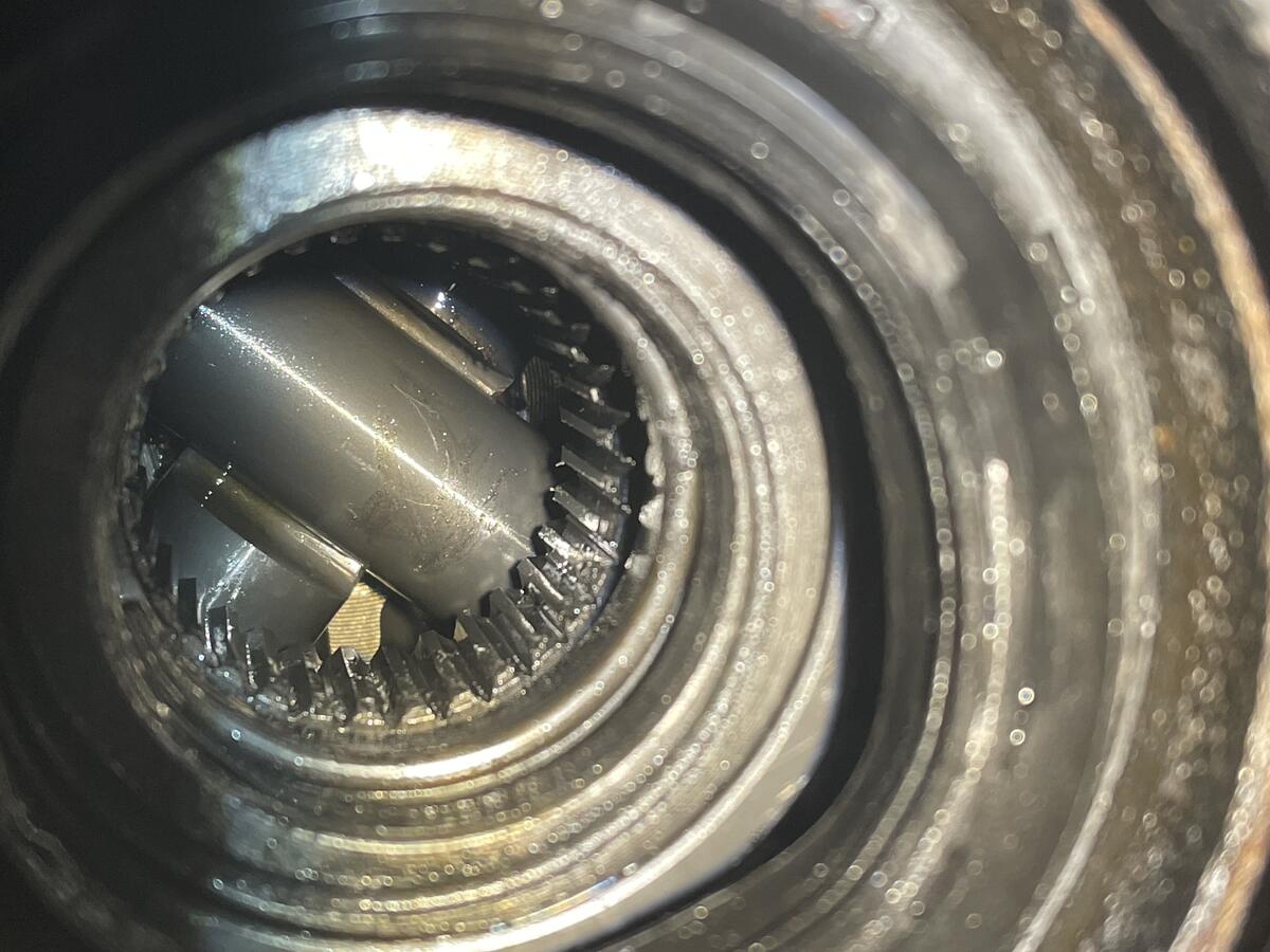

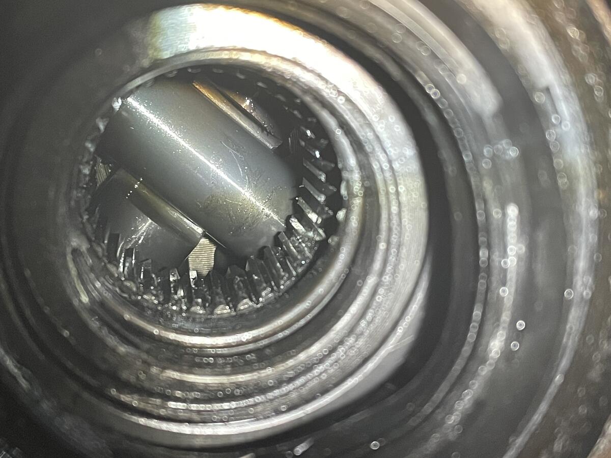

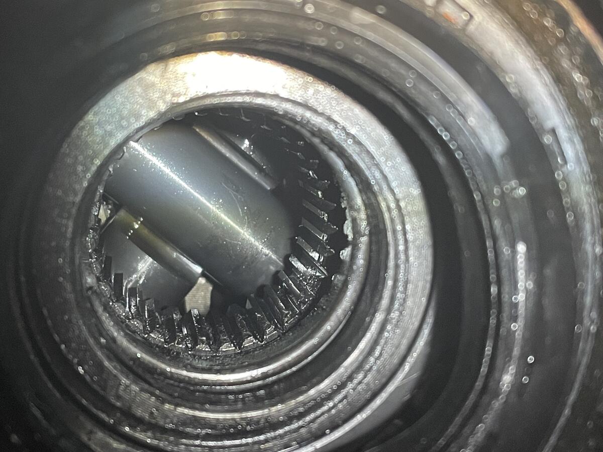

    Best pics I can get. metal shavings between splines is present.
      #62
      Man, I don't know what your budget is, but I'd be looking for a full rebuild or a swap if it were me. Thats not a ton of metal in the case from the drive flange, but it's really hard to tell if those splines are damaged on the inside as well. I don't have enough experience with these diffs (or really any diffs in a situation like this) to make a solid recommendation for you, I'm hoping others on the forum may have some thoughts.
      You might be able to get by with a new drive flange and a really good flush of the fluid, but I just don't know if you've significantly compromised the longevity of the other parts inside that pumpkin. It would suck to throw some parts at it, button everything back up, and then a few thousand or few hundred miles down the road end up having to pull everything back out again...
        I feel you on that. It’s not a daily so I’ll sit on it and make a decision soon enough. I was thinking about taking the back cover off to see how the inside looks after I dump the fluid inside. Would prob give me a better idea as to how things are looking in there.

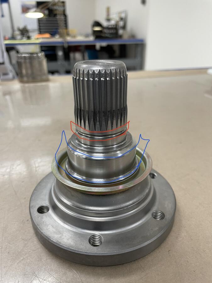

          Cleaned up the shaft a bit.
              I'm curious about what you used to clean it up without marring it? Looks great !
              -Ted
                -Ted
                And that blurred out workspace surrounding that cleaned up flange looks like I could be happy there for a long, long time!
                  -Ted
                  filed the splines a bit to clean them up, sand blaster, scotchbrite, and polishing paper.

                          Question regarding shaft. Marked red, does a lock ring go there? Marked blue, does a seal go there or a bearing?
                                The pic in your post shows there is plenty of splines remain for a normal car operation. The groove is for the locking ring to snap on for detent, and the highlighted area is for the oil seal. There is no bearing riding on the flange. Clean all metal bits and you are good to go.
