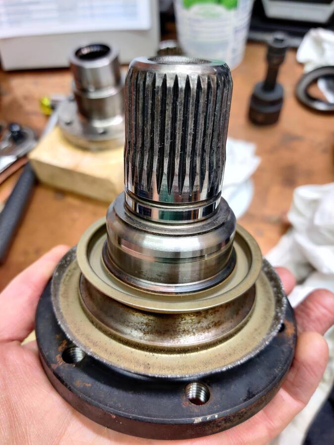

    Comparing these two pics, your ground off splines is about 1.5mm below the chamfered section, so nothing to worry about.
      #77
      I believe you're lucky it's only the splines that popped out, not the side-gear that messed up. The flange spline end will have some marred up end but it's just a very short section, so there are plenty of splines left on the shaft to do the work. Just clean up with a file in order to be able to insert it back in easy.
      The important question is why the flange popped out. I don't think there's any wrong with the C-clip causing this, but somehow the wheel had extended to far causing the half shaft to pull the flange out, such as removing the shock damper without supporting the wheel and it falling down too far, or broken control arm which is not your case.
      OP, have you checked why the half shaft pulled the flange out? I don't think the flange popped out due to bad locking ring. Had you jacked up the rear wheels recently before the mishap? Using a too long extended shock damper can cause this too as it allowed the wheel to drop too far.

          OK, before install the flange back in, I would dress the end of the ground off splines: file the 2 sides of each spline for smooth edges, as this helps you to easier insert it back into the side-gear. Once the lock ring snaps on the shaft groove, then try to pull the flange out to see how much effort to pull it out. If it's too easy to pull it out then you might need a new ring. When the wheels move up and down, the movement of the CV joints splines relative to the shaft takes care the extended length, and the flange should not be subjected to a large pulling force. So you need to check the free sliding movement of the shaft within the two CV joints to see if it is locked for free.

            I filed every single spline on this shaft today, hoping that does the trick. I know that when I pushed the shaft in, it was not easy. And to pull it out, I had to pry that mf out because it was tight. I’m a little optimistic on this, but time will tell. Hoping for the best.

              Send it. I hate giving advice over the internet in situations like this, but after reading thru the updates today, button that thing back up and send it!
              That flange cleaned up nicely. Sapotes point about only a small amount of ground off material is valid.

                                DON'T REUSE THAT AXLE STUB!!! The short stub is the one that no one wants. Should be able to get one cheap. I might have an extra one. Everyone wants the long one to cut down when they swap an OSG or a ZF limited slip carrier.
                                You will need to replace the c-clip, at a minimum. The problem is if the end of the stub is damaged then the inside of the spider gear splines are also damaged. Which leaves a minimal section of good spline engagement. The splines will likely fail.
                                You will need to pull the carrier out, open it up and replace the spider gear. I can a diff fully apart. I am going to rebuild it in a couple of weeks. PM me if you're interested.
