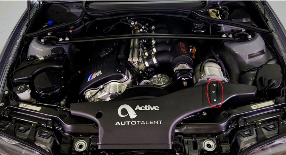

    Hello,
    Hoping there are some folks knowledgeable on rivets, if they are really rivets.
    What are these? Rivets? And what sort of rivets that i might do the same?
    Thanks.

    Okay, looks like what these are aluminum blind pop rivets.
    Need a hand riveter tool... urgh...
      I'd agree with your assessment
        If you didnt want to use them, you could also use binding screws. Youd have to use locktite so they didnt separate and fall into the intake, but it would be a bit easier than drilling out a rivet.
          They look like Ace Hardware specials. If you ever have to take it apart I'd go with something less permanent.

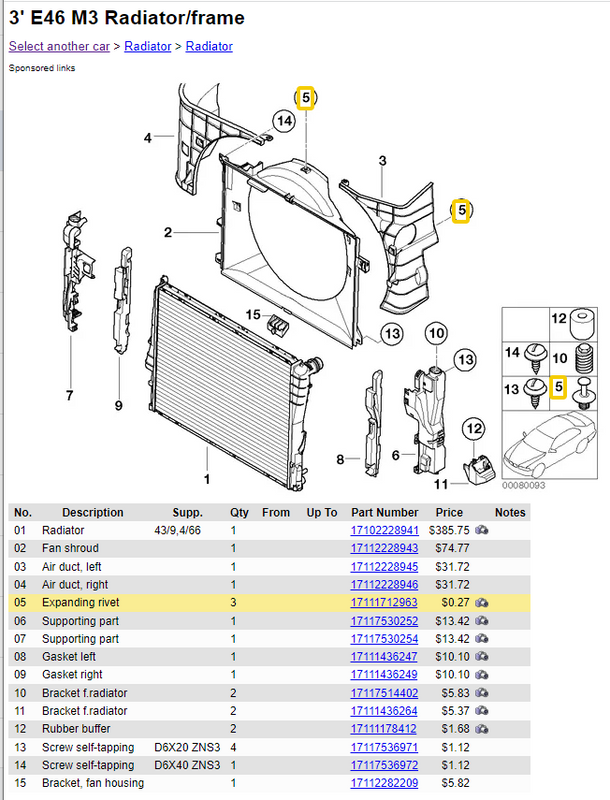

              You could even get some of the plastic push pins that hold the radiator ducting and use those to join the two pieces. Less permanent and will look more oem. 17111712963
              They'll stick out and obstruct air flow a bit but, eh, it's supercharged so probably won't make a difference
                Thanks, i have some laying around (somewhere), will try that out! Thanks.

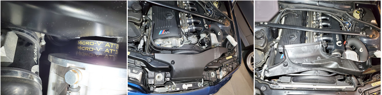

                    Version 1.... urgh...
                    Version 2 on the way...
                      Version 2 came out not too bad...
                      Used the suggested OEM plastic push pins for OEM look
