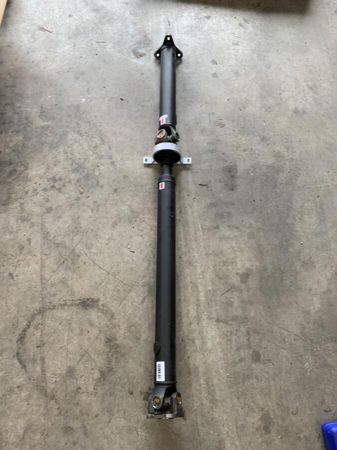

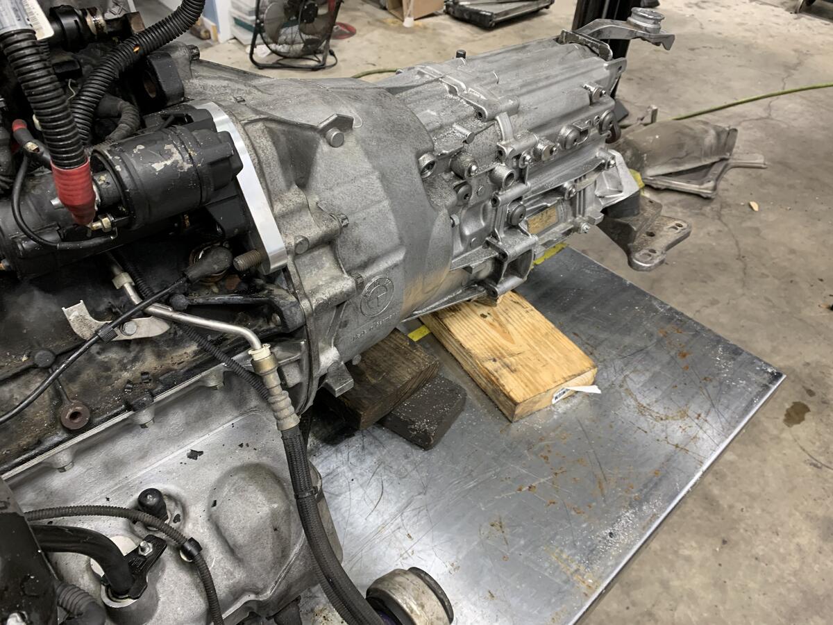

                              Hey thanks, yes I run a S6-53 trans from the N5x cars in my S54 swapped touring, I like it a lot compared to a 420g. This trans swap isn't for everyone, while I'd like to say it's the best solution out there, that's not quite the case. If you have a stockish powered 420g car now it probably doesn't make sense to do this conversion (financially) but I think it starts to make more sense if you a running elevated power as the S6-53 is stronger. BUT the S6-53 shifts so nice, it is night and day compared to most of the 420g's I come across, there are some rare exceptions of 420s that still are crisp but it seems like the majority coming through my shop are starting to have some kind of "issue."
                              So IMO if you want a nicer shifting transmission or are concerned about strength this is the way to go. The swap is pretty straightforward but does require a few "custom" pieces. The starter bolts to the block on the N5x cars and on our S54s the starter bolts to the transmission, so that has to be addressed (what I was talking about in the link Heinzboehmer posted above). Thats the "hard" part, from there a custom slave cylinder hose and shift lever bracket (both easy) and then a custom driveshaft, everything else is a bolt in affair.
                              Email to [email protected]
                                Awesome. Next time my transmission is out, I'll be replacing it with one of those (or similar). I've always liked the feel of those ZFs MUCH more than the feel of the 420G. I would be doing it exclusively for feel. I do have some engine mods, but I don't run so much more power that I'm concerned about my trans.
                                For the driveshaft, did you have an M3 one lengthened/shortened or did you piece one together from multiple BMW driveshafts?
                                Your starter bracket solution seems super straightforward and I'm sure that Ronald (from AutoSolutions) would be able to easily make me a custom shifter carrier that still works with his short shift kit to swap in.
