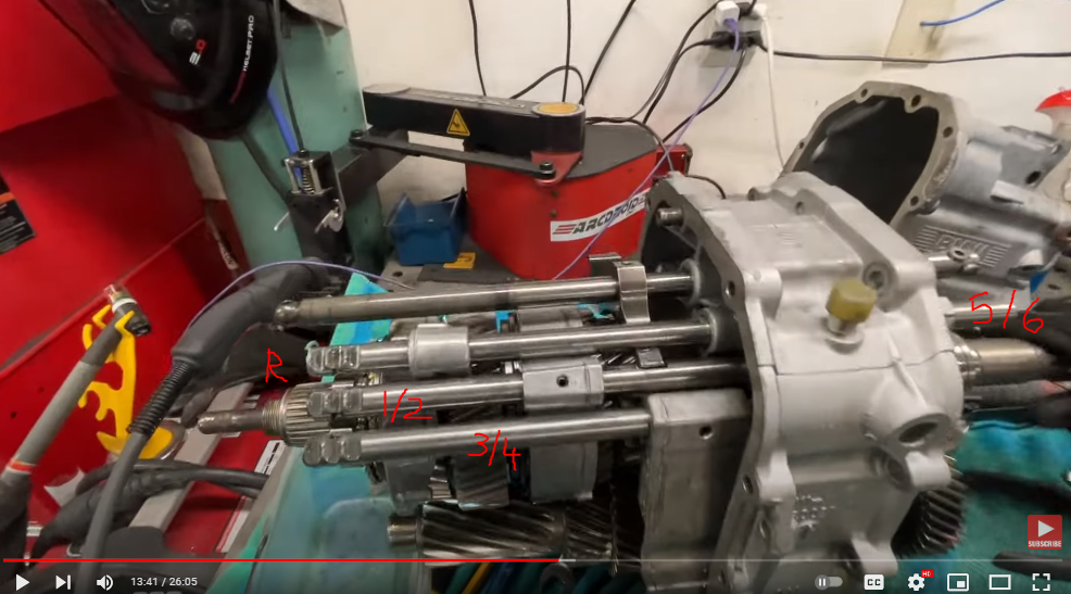

                              R and 5/6 shift rod share the same bearing axis.

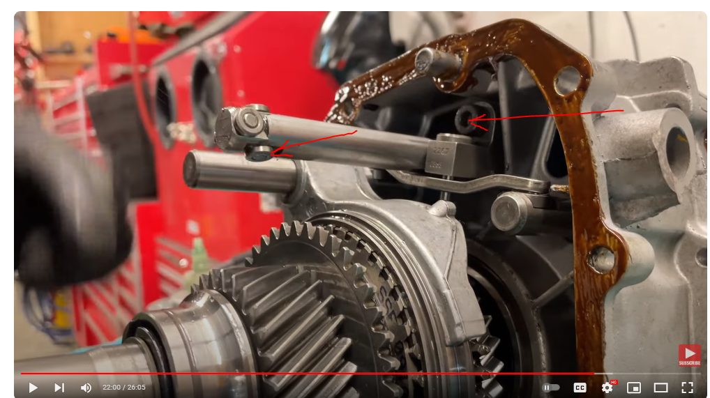

                              Don't assemble the bellhousing horizontal as he did as the bottom roller can fall down. Also add Loctite to the 5/6 pivot bar bolt:

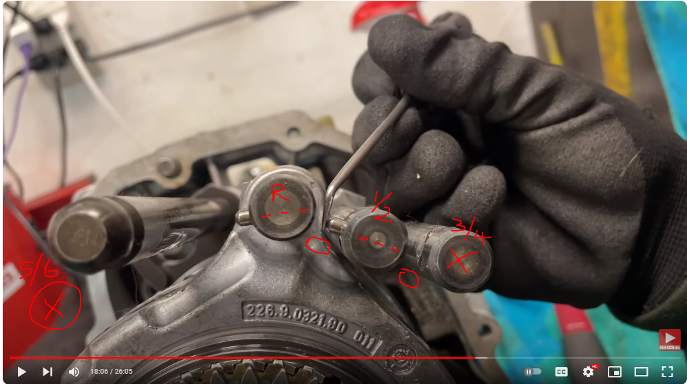

                              How the shifted gear interlock works: there is a locking ball in between shift rod R and 1/2, and between 1/2 and 3/4.
                              R and 1/2 rods have through holes with a lock pin inside. 3/4 and 5/6 rods have no through holes nor lock pins. The lock pins are slightly shorter than the shift rod diameter. The ball is slightly larger than the space between two rods, and so the rod has a groove to fit the ball.
                              For example, when 1/2 gear shifted, its rod moves and push left ball into R groove and right ball into 3/4 groove. The ball also pushes R lock pin to left and push the long lock pin into 5/6 groove. So now balls and all lock pins are inside the groove of all the shift rods and prevent them being moved, except 1/2. This prevents accidentally engaging two gears at the same time.
