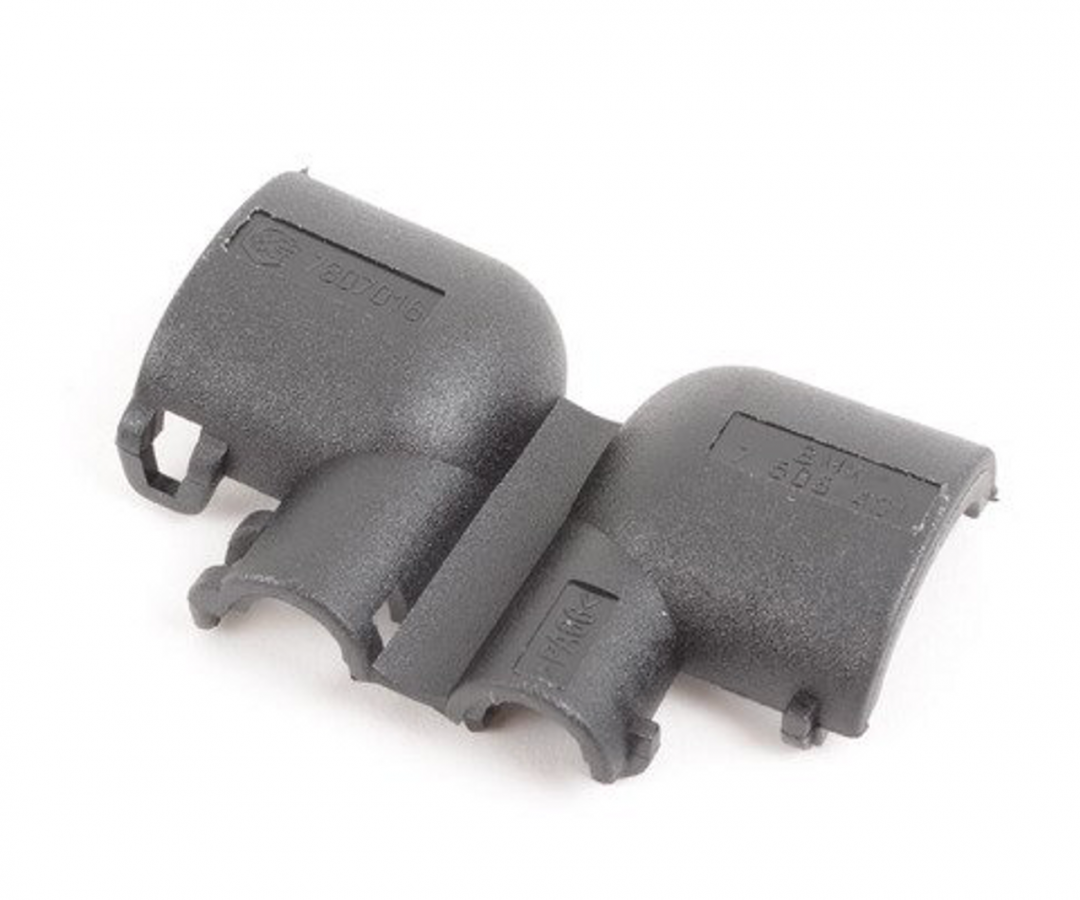

                    For anyone else who is looking for the protection cap that goes on the CSL IAT sensor, I found the part number from a spare I ordered a while ago -
                    12527506431​
                    Click image for larger version  Name:	12527506431BMW__23145.1604077282.png?c=2.png Views:	0 Size:	475.5 KB ID:	242384
