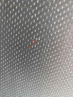

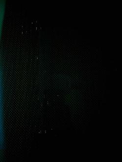

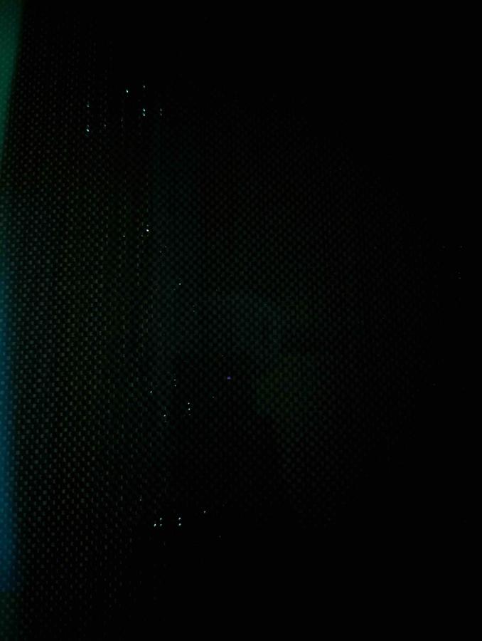

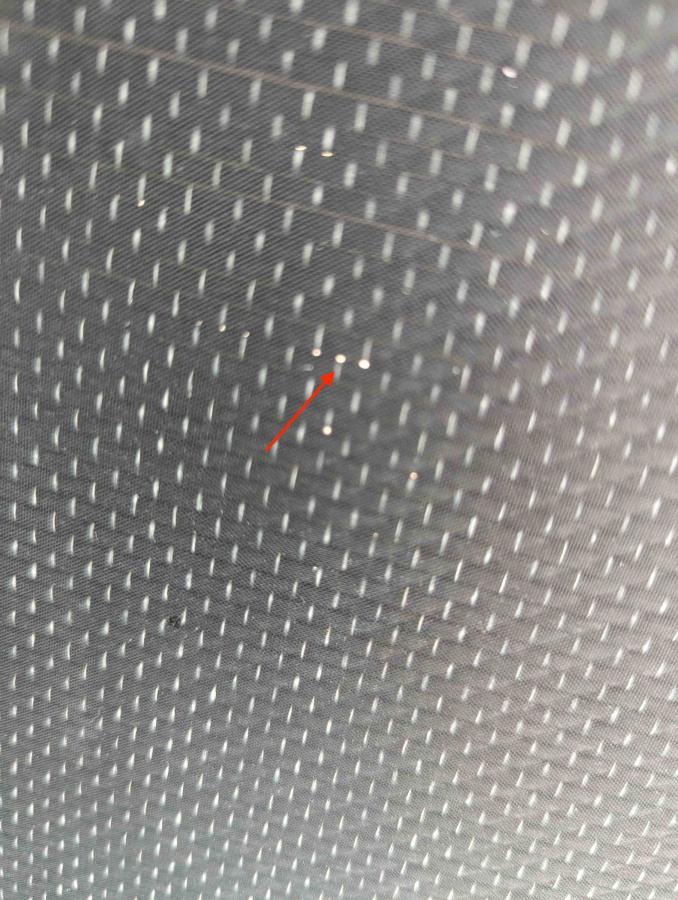

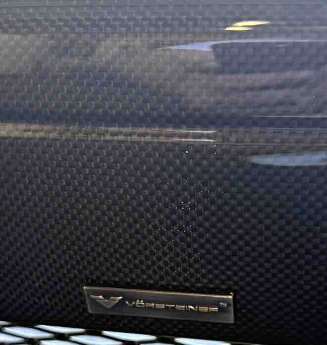

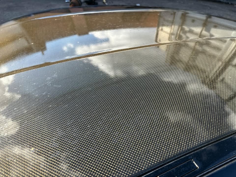

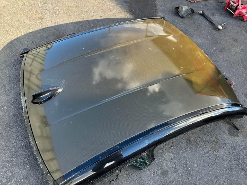

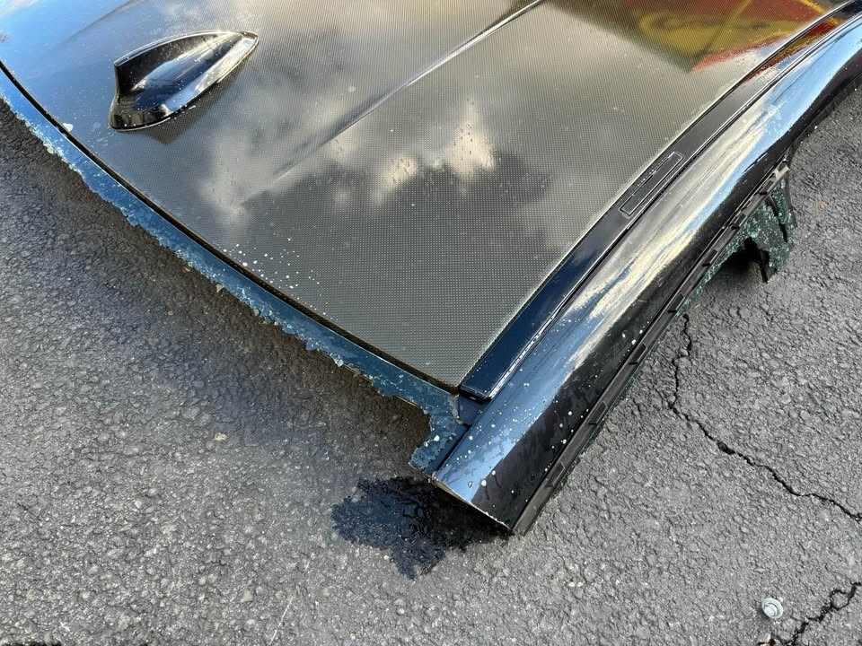

    Are see-through pinholes in carbon roofs or any carbon part expected?
    Photos below are exterior shots with a flashlight inside pointed up at my carbon roof. I think nobody notices it because when it comes out of the shop, the headliner is installed.

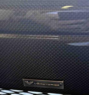

    I also see it on Vorsteiner bumpers:
    Click image for larger version  Name:	bumper.jpg Views:	0 Size:	44.8 KB ID:	318529
      Is that the inside or outside?
      If inside then it might be a polyester core material peeling through. Not really an issue if it is on the inside.
      if outside, some pinholes in an unfinished part is normal. Clear coating should fill in the pinholes. The part needs tk be sanded before spraying so the white dots could be dust stuck under the clear coat.
          The photos are from the outside. You can see the hole under the sun too.

          Which brand roof is this? Aren't these roofs supposed to be made from multiple layers to give it the strength that is required for a structural component?

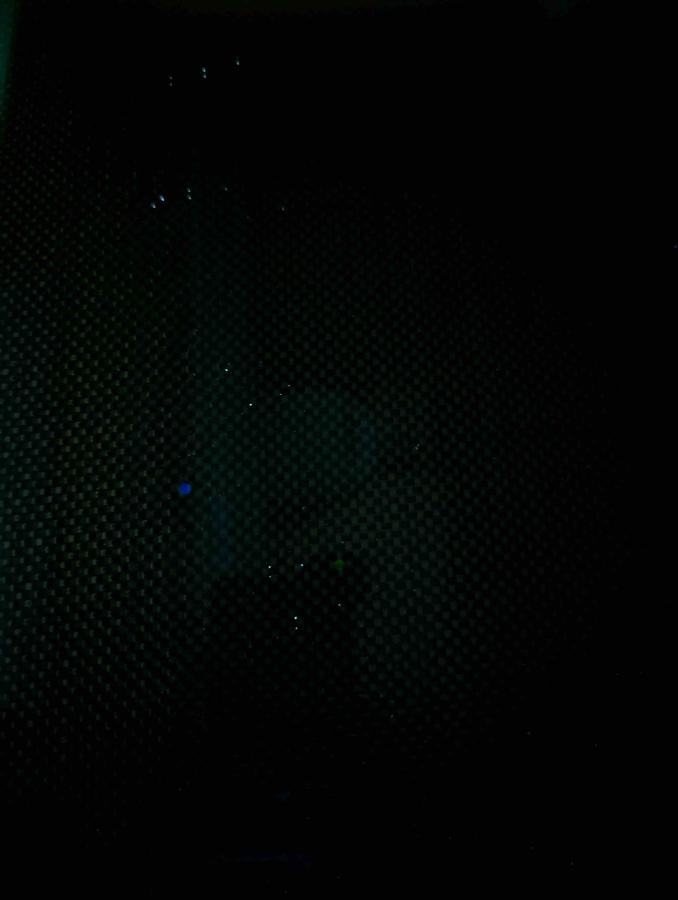

          I have the RKP roof I purchased from IND.

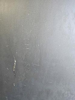

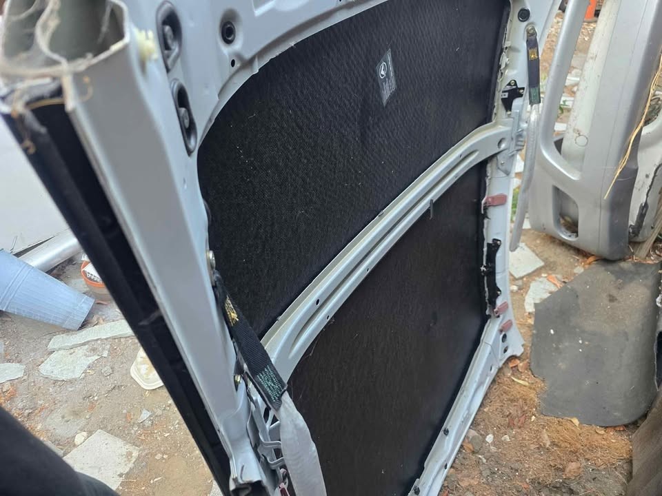

          Here's a photo from the inside when sunny out:

            That is odd. When I make my roofs I use a biaxial fabric under the exterior layer which takes care of any voids since the tows are 45 degrees from the outer layer. Then I use a thicker layer on the bottom.

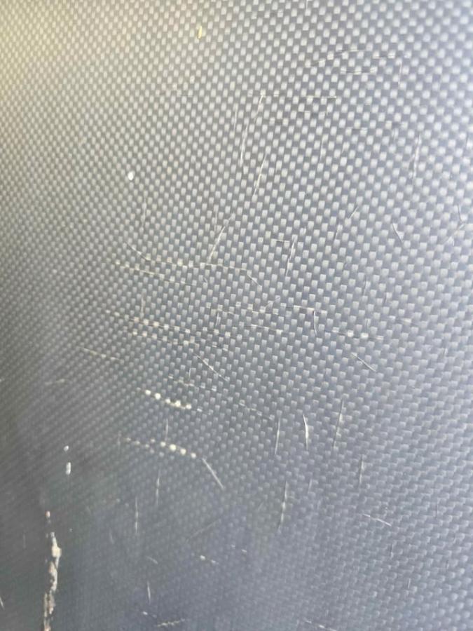

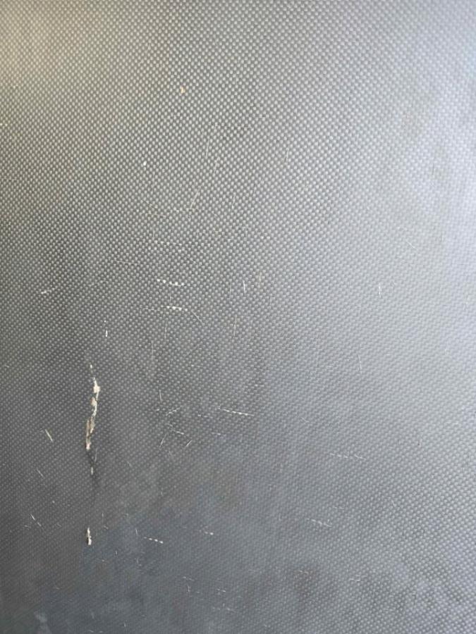

              Found this rare E46 M3 Vorsteiner carbon roof on the internet that seems interesting and wanted to share. Note that the underside looks like fabric. Is that the biaxial fabric you speak of?
                  Hard to tell from the pic. Looks like some sort of chop strand veil.

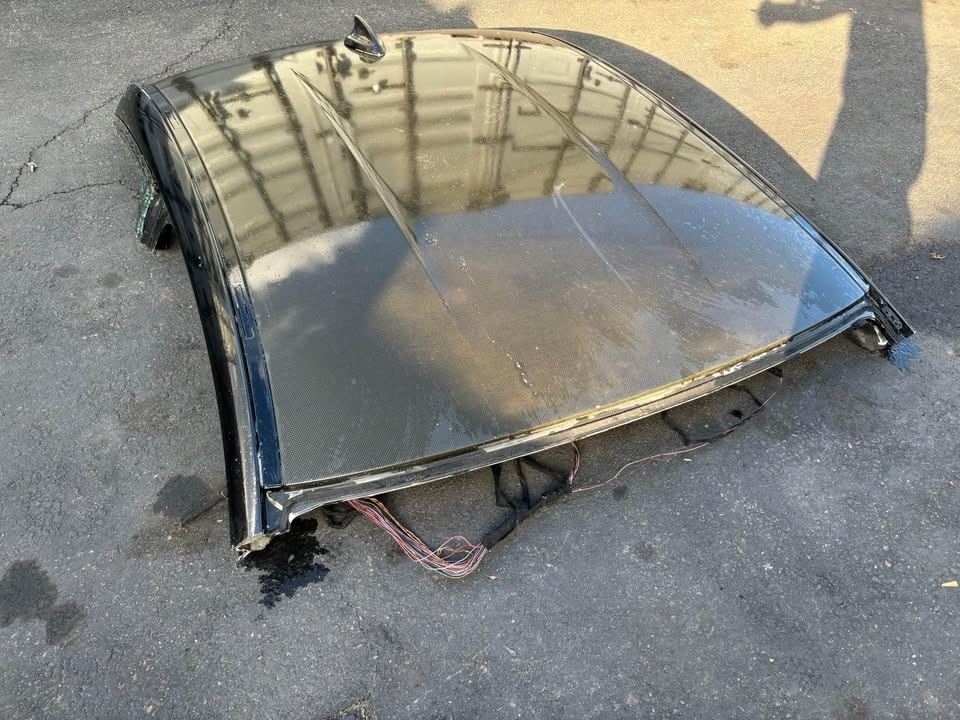

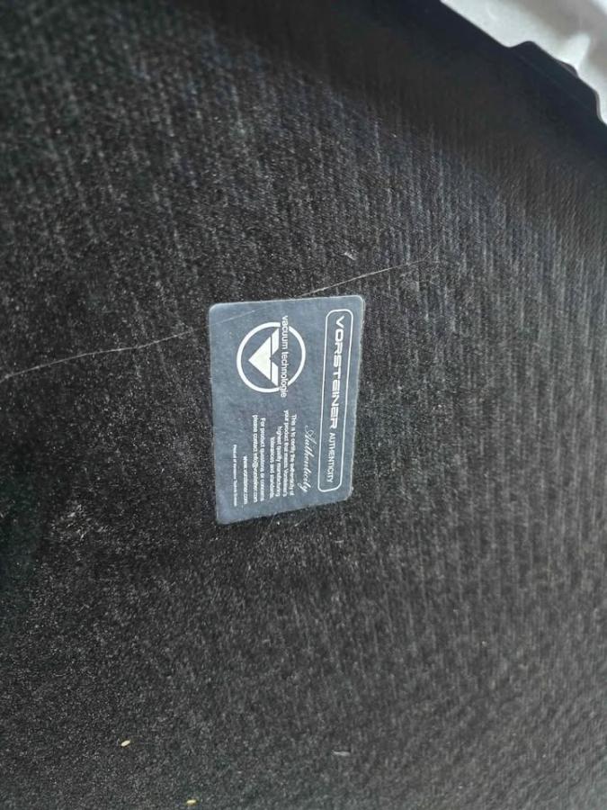

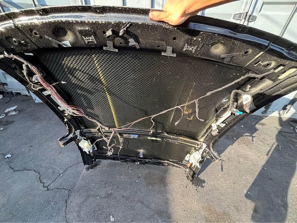

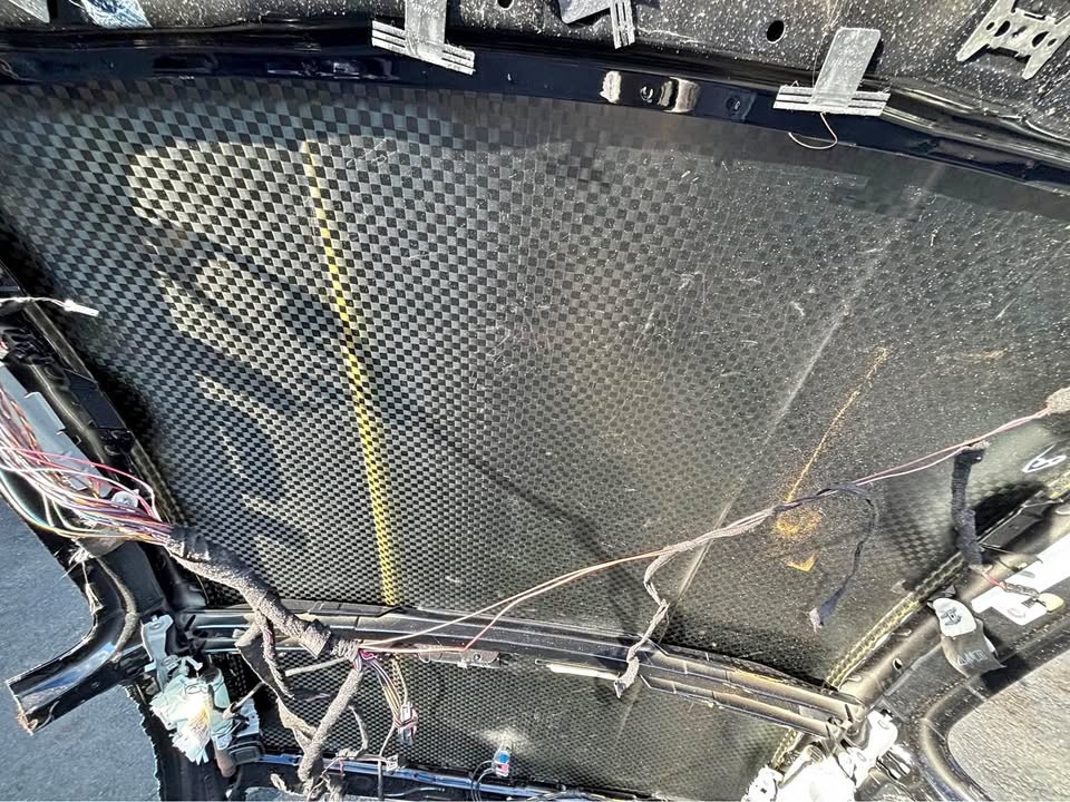

                    For the curious, just adding BMW M4 F82 stock carbon roof photos since few have seen the underside w/o the headliner:

                      [QUOTE=Epsilon;n318980]For the curious, just adding BMW M4 F82 stock carbon roof photos since few have seen the underside w/o the headliner:
                      The E9X M3 also has a spread tow fabric on the underside. From watching a production video, I think they use a 1x1, biaxial layer, some sort of thin core material, biaxial layer and a spread tow on the bottom. Then the underside is a smooth finish since they use a compression mold. Of course, top notch stuff!
