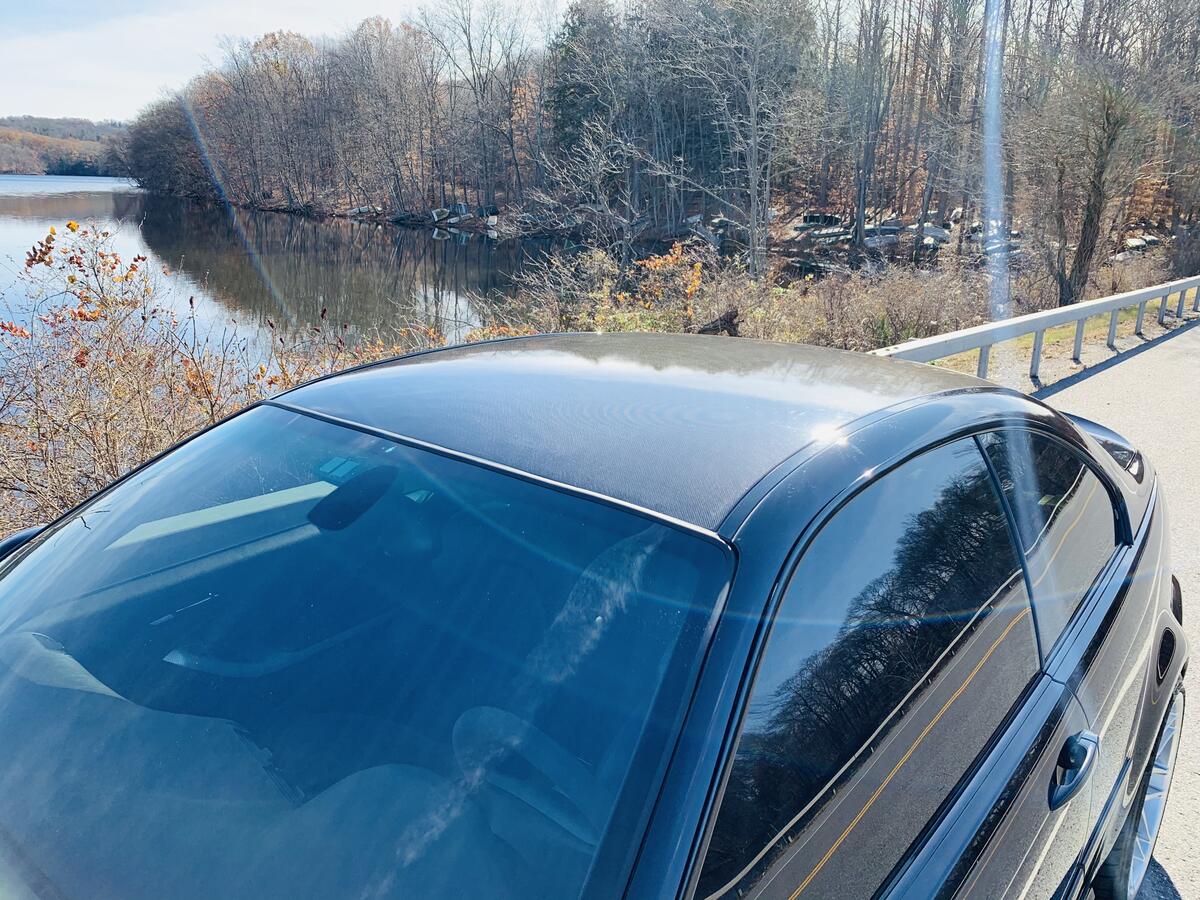

Notable carbon roofs to choose from (some clear coated and some not):
RKP (formally called Challenge) - https://ind-distribution.com/product...bon-roof-panel
Bimmerworld - https://www.bimmerworld.com/BMW-Part...er-Roof_2.html
Lang Racing - https://store.langracing.com/bmw-e90...er-roof-panel/
Karbonius - https://karbonius.net/producto/bmw-m...al-roof-panel/

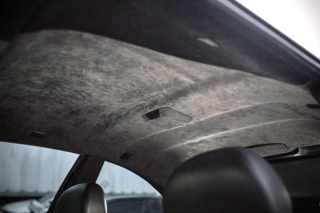

Slicktop headliner:
https://www.ecstuning.com/b-genuine-...k/51442699065/
