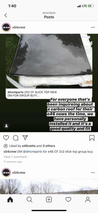

ID:	16121 Would anyone trust this brand. I personally will not be installing but It’s a group buy for a carbon 2x2 weave
                      Diogo from AMS says theyre a pretty good brand. Not a fan of the 2x2 weave though
