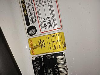

    I have to toughen them up so I don't end up on dialysis. Plus the door says 41 and 48 psi for speeds that exceed 100mph. A lot of 911s are in the 40s for tire pressure. Sometimes those cars call for 50psi for full load.

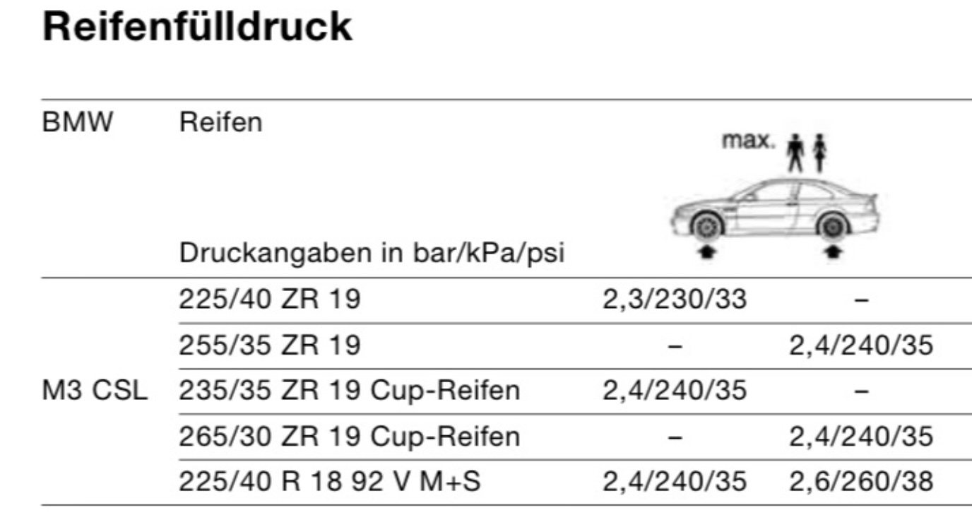

            Your CSL bootlid is not even close to creating the five hundred pounds of downforce that would justify following the max load pressure recommendation, and BMW research would have been on ancient PS2 tires. I haven't melted any tires yet running mid to high 30psi hot on fast tracks.

              follow BMW correctly, not the max load pressures

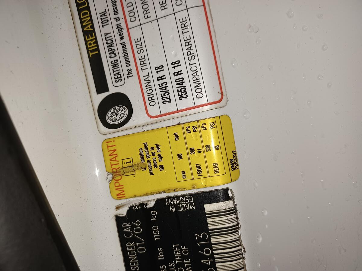

                              I go over 100 a lot and most of my driving is above 70mph. Post what you want but these are the pressures I run because they suit my driving situation. My tires look great, handle great, and hook up quite well. It works and I'm going to keep doing it. A chart isn't going to change that.

                                Never seen those stickers on a BMW before. Are those original to the car? I'm genuinely curious.
                                Regardless, if you aren't running stock tire sizes with the same load rating, those stickers are a suggestion. If you use a true pyrometer with a probe (not an infrared thermometer), I'd be curious what yours temps are across the face. I can almost guarantee your centers are hotter than the sides at normal highway speeds (70mph). How often are you above 100mph for an extended period of time?
