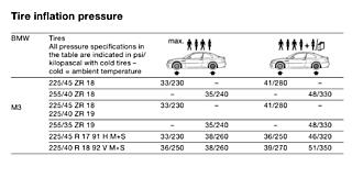

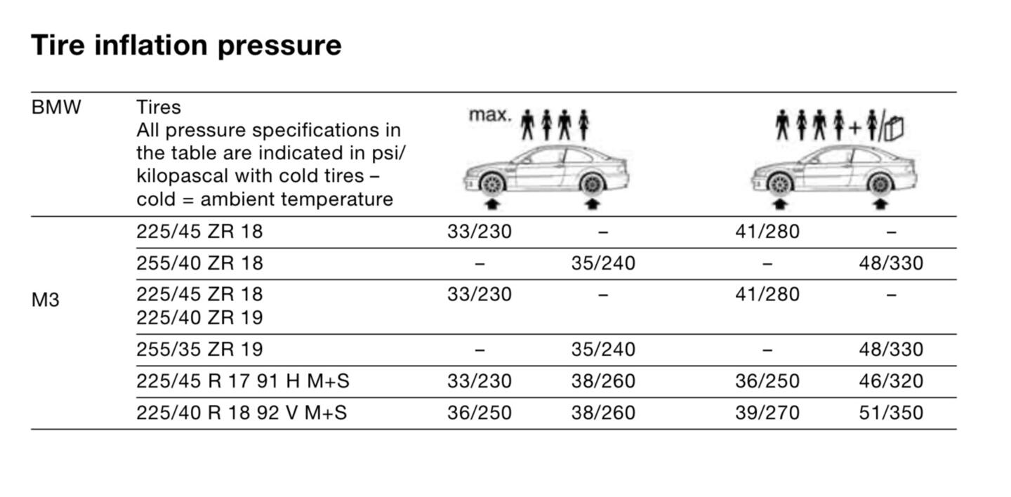

      Click image for larger version  Name:	7738078C-395F-4382-89BF-61A232DBFC55.jpeg Views:	0 Size:	73.3 KB ID:	149483 The sticker in the door jam is for worst case loading scenario, not best performance
      More reasonable speed adjustments are here: https://m.tirerack.com/tires/tiretec...jsp?techid=302
      But you’re not cruising at 150 right
