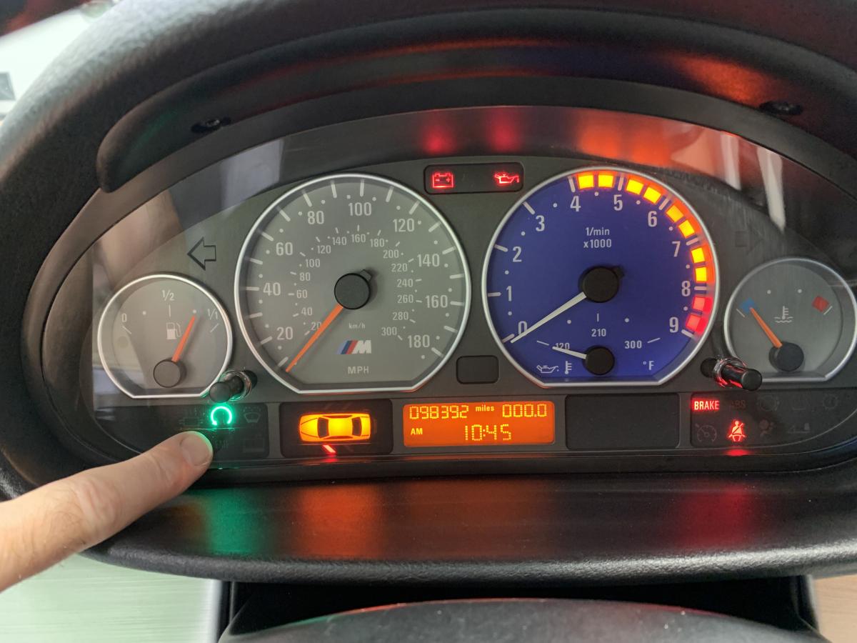

                  I added a green LED to my 2003.5. I have some links to what is required if you need it.
                  Old, not obsolete.

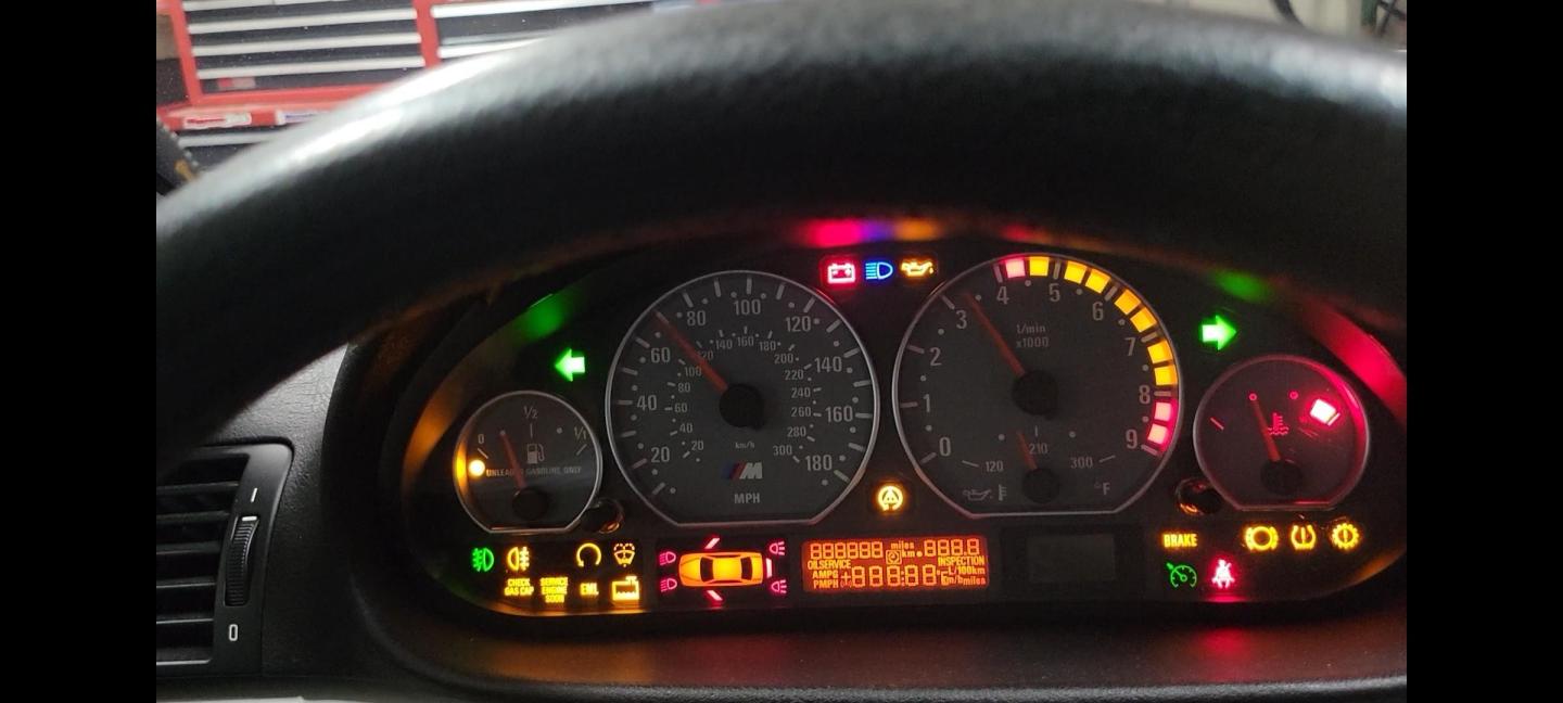

                        I've been trying to get this coded in but am doing something wrong, doesn't seem to be taking. I successfully made a few other changes in NCS independent of this change, like turning off DRLs, changing the hazard light blink pattern, etc - so I somewhat know what I'm doing.
                        My car has the M track symbol (gauge test screenshot shown below). For the following MK60 adjustment setting of "DTC_LAMPE", this would be set to "Aktiv" in my instance, correct?
                        d. If you don’t have a functional M-track symbol, and don’t want to solder the LED, set “DTC_LAMPE” to “nicht_aktiv”
                        i. This will make the DSC system act like the non-M DSC where a single press makes the DSC symbol light up, and a long press makes the DSC and Brake lights turn on.
                        I don't have ZCP brakes or rack and those have been set accordingly.

                          For some reason my .man file wasn't saving the first two times. I feel like I did the exact same steps the first two attempts, but third time was indeed the charm and I now have working M Track Mode. Yay.
                              Where are those links posted?
