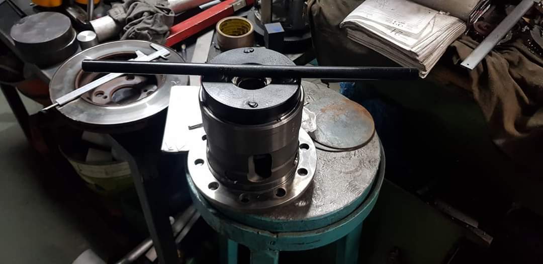

                          I worked on my diff today, I was supposed to only change seals and o-rings but ended up ordering Racingdiffs advanced pack v1 and I will install a spare 4.10 pinion/ring I had for a while to replace my 3.91 finally.
                          For anybody wondering, I tought my 2005 & my 2006 would share the same GKN LSD as a Z4M but in my 2005 I really have 8 plates and 7 clutches like RacingDiffs mention in pack v1.
                            I think it is very few E46 M3 who got the Gen2 GKN. the core is different and is the same used on E9x M3, E6x M5 and Z4M.
                            The Gen2 cracks open from the opposite side, and needs a special tool. Gen1 opens from the ring side

                              Good to know! My 2006/04 is probably a Gen2 than.
                              I opened my Z4M Coupe diff to swap a 4.10pinion/ring in it back in the days but didn’t pay attention to the LSD cause didn’t had to open it. I remember it had bigger opening like this one and it was easier to see the clutches vs a Gen1.
