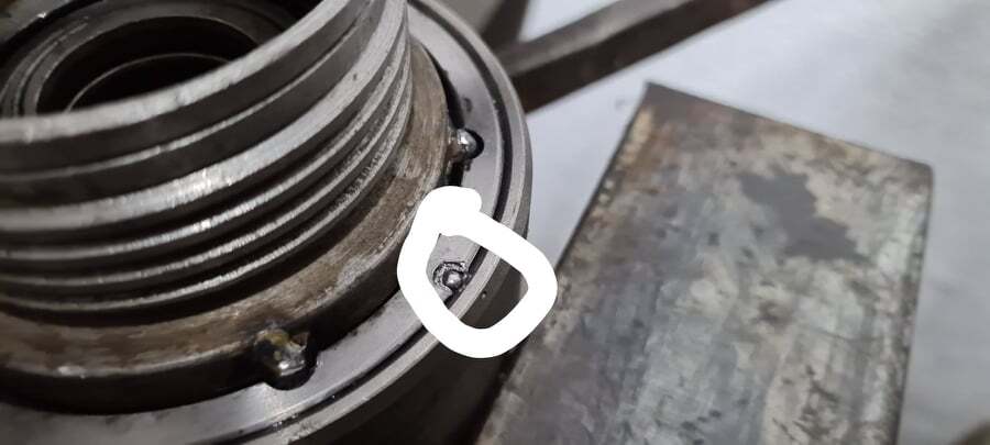

            i was told the tool is very simple, it is a circular steel plate with 6 or so tabs that engage to the carrier top cap, however, I was also let know that the carrier has a dowel that locks the cap and that needs to be drilled out. To close it back you can tap screw and use red loctite.

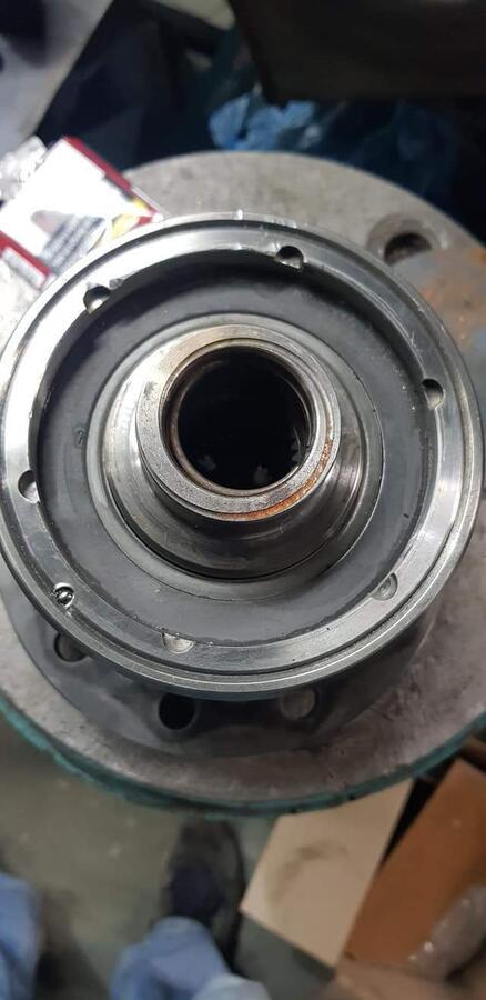

              I found some more pics...
              You can see the pattern the tool needs to have

              This is the dowel that needs to be drilled out

                                I plan to make the tool this way: get a 2" long steel cylinder with OD about 5mm larger than the carrier's threaded ring ID, and cylinder ID is 10mm smaller than the threaded ring ID or smaller for thicker wall. Drill 4 holes S at equal space on the cylinder end on a circle of diameter = threaded ring ID. Hole S has the same size and depth as the threaded ring half-moon 4 holes. Then turning the cylinder to cut its OD down to fit into the threaded ring within 0.001" clearance. Then machine a rod to have 4 short rods that fit snuggly into those formed by the half-moon of the cylinder and threaded ring. Cylinder length is around 2" with a 1" hole drilled through the top section for inserting a steel rod as the handle to turn the cylinder.
                                To use the tool, insert the cylinder into the threaded ring, align the 4 half-moon and drop the 4 short rods into the holes (formed by the half-moon) to lock them, use 1" steel rod to turn it. No welding needed for making the tool.
