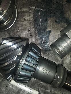

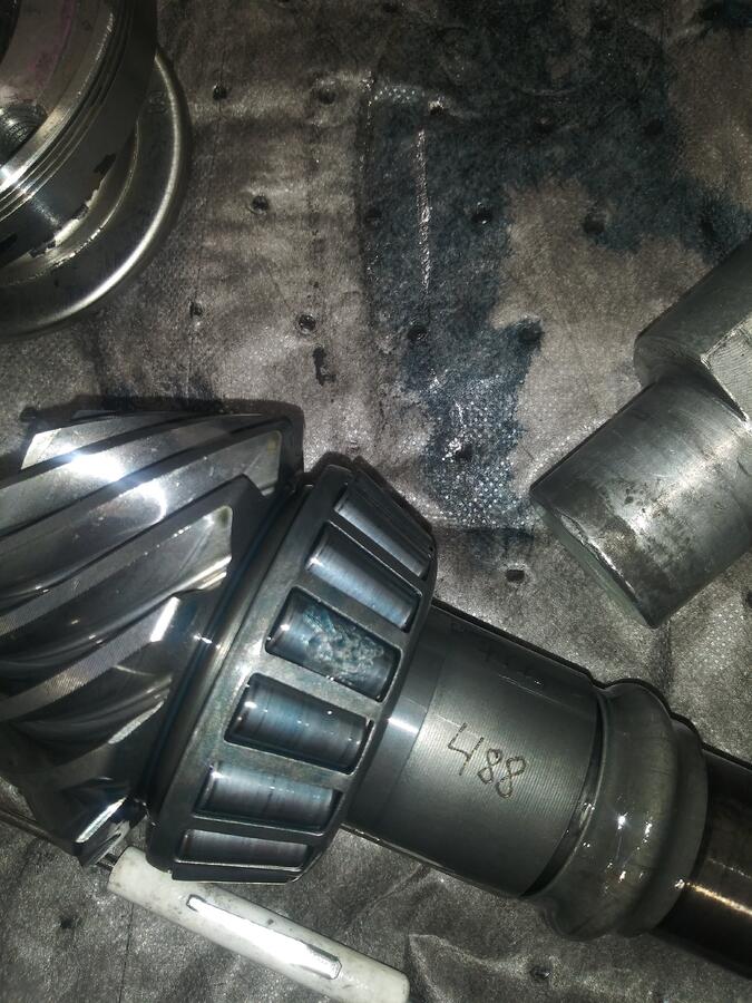

                    Did your pinion bearing look like this?

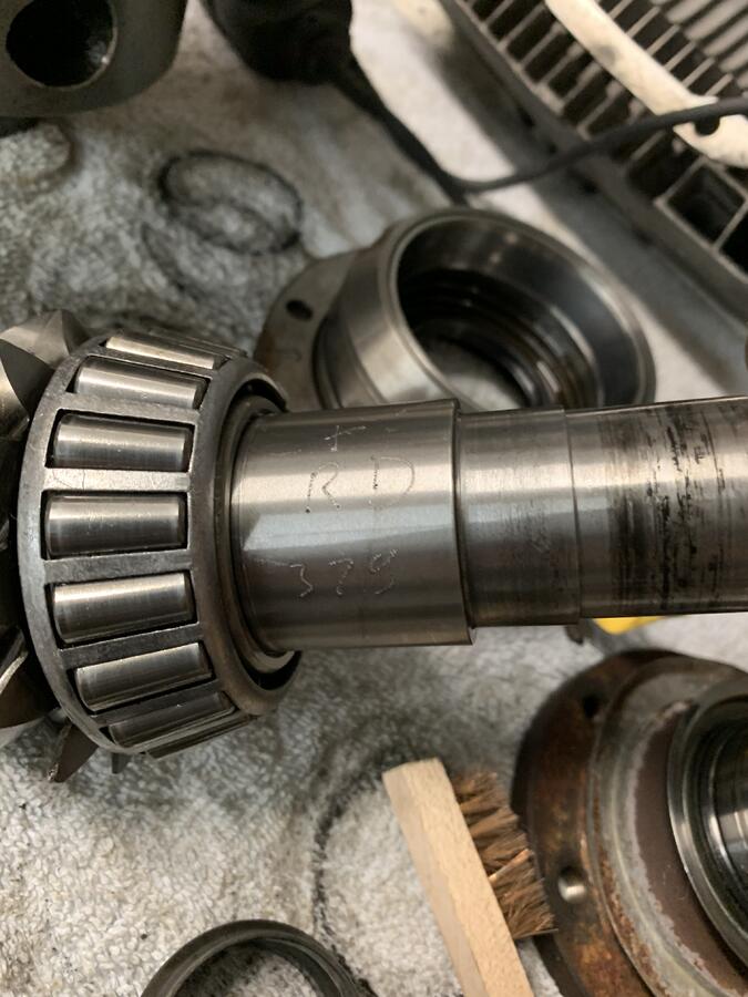

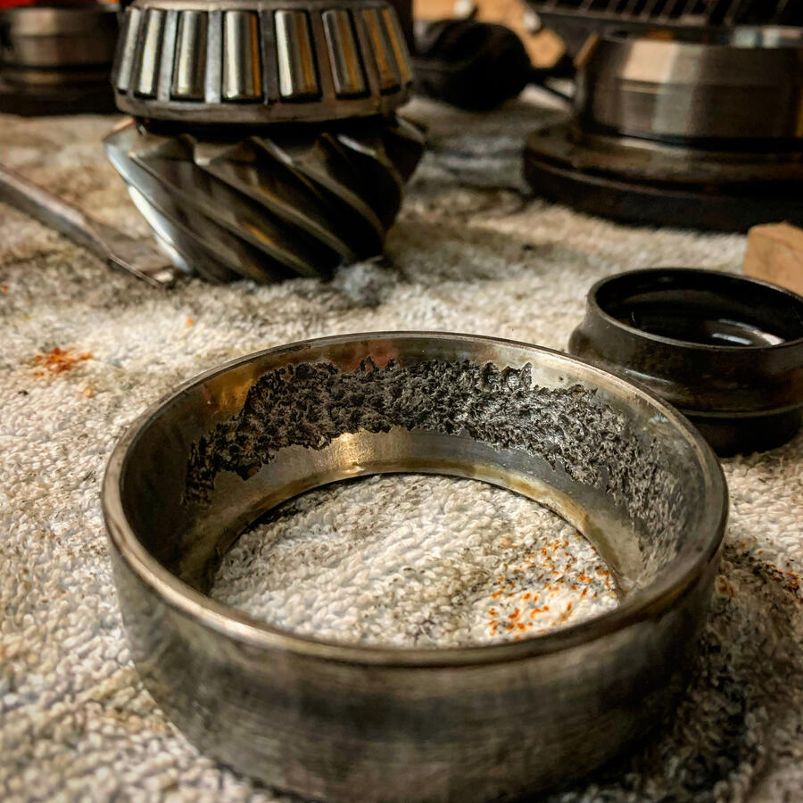

ID:	149351The bearings themselves had small scratches but no marks. I suspect the clutch discs were worn and the debris lodged itself there.

                        wow, the bearing outer race with all these deep pitting, but the rollers don't look bad. This must generate horrible whining noise. If prolong the extra clearance from the bad bearing could cause bad wear on the pinion/ring gears then they are toast.
                        For the small torque wrench (10" lbs), one could use 1lb weight on 10" extension tube and have the tube/wrench horizontal, instead of buying a rarely-needed tool.
                          #57
                          The whine presented itself during a drive from Jacksonville, FL to Savannah, GA. In all I put around 200 highway miles on the diff after it started making noise. I didn't note any damage to the pinion gears with a 10x magnifying glass while I did the tear down. I think I caught it just in time.
                          Thats a good point on the torque wrench. I like collecting tools so it was ok in my situation, if worse came to worse I could have sold the torque wrench at a slight loss and gotten my moneys worth out of it.

                            It was my rollers that were awful and the races were ok. Nothing was THAT bad though. I'm putting 1000 miles on the build this week and I'm over halfway with no extra noise. I do believe a caveat to be aware of is their Timken bearings require a different preload than the OEM bearings. They provide that info or it's floating around in a document somewhere.
